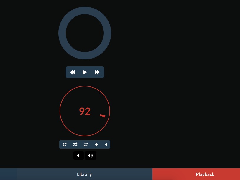

Since I moved to 2.6, I'm experiencing strange issues. Seems like performance or network or...?

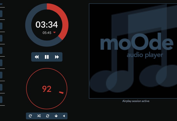

I've initiated the Airplay session from my macbook. Moode player displayed the airplay session message and then nothing happened. I've stopped the session and noticed, that Airplay device disappeared from the list on Mac.
Restarting mac didn't help.

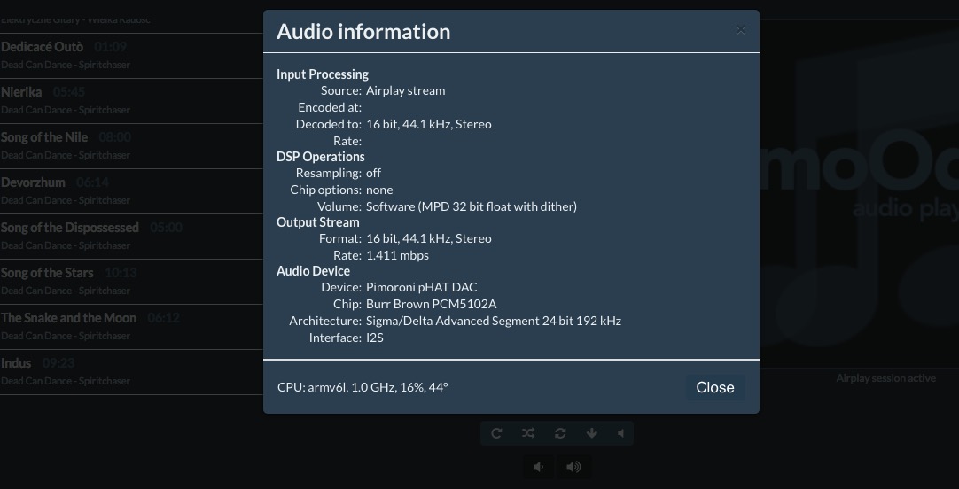

I've then selected some songs from the Moode library and they started to play, player was still showing the airplay session (while the correct song was played).
Even the "Audio info" shows it's in airplay mode.

Just after restart, the playlist is gone and the player tab looks like on the third screen. After I click "Play" on this empty screen, the playlist is suddenly back and it starts to play from the last played song, but.... it again says it's in airplay mode (screen 2), while I didn't initiate it again.

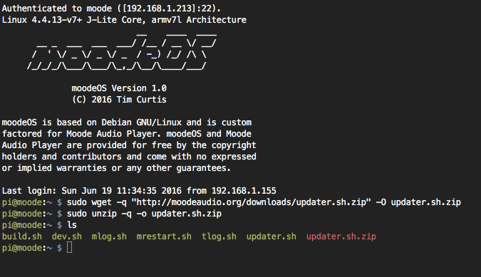

If u know a little Linux ssh, email me and I'll send u the new in-place updater so u can get latest updates to Moode 2.6. One of the updates addresses a startup sequence issue and also an improved watchdog monitor.
-Tim

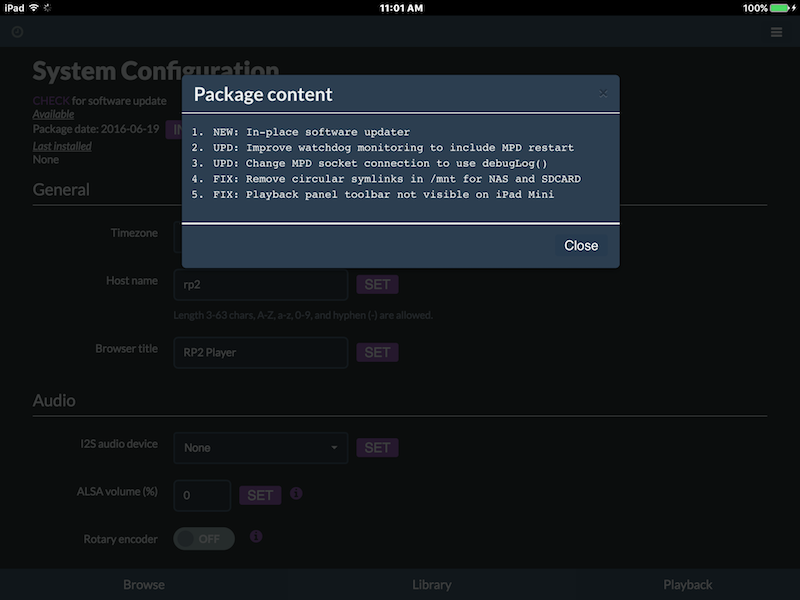

Ok, looks like my issue is finally fixed.
I've applied your updater and then had to turn the airplay off/on (because after update and reboot nothing changed).
Thanks again for quick help!
I really like the auto updater option 🙂

Below are instructions for downloading and installing the new in-place software updater for Moode 2.6.
Download and install updater.sh via ssh
1) cd ~/
2) sudo wget -q "http://moodeaudio.org/downloads/updater.sh.zip" -O updater.sh.zip
3) sudo unzip -q -o updater.sh.zip
4) sudo mv updater.sh /var/www/command
5) sudo rm updater.sh.zip
Run Updater for first time. This will install the latest fixes and updates for Moode 2.6, one of which is the UI version of Updater on System config screen 🙂
1) sudo /var/www/command/updater.sh r26
2) sudo reboot

Below is the list of fixes and updates contained in the initial package.
NEW: In-place software updater
UPD: Improve watchdog monitoring to include MPD restart
UPD: Change MPD socket connection to use debugLog()
FIX: Remove circular symlinks in /mnt for NAS and SDCARD
FIX: Playback panel toolbar not visible on iPad Mini
Tim

Very odd. Just retested and no issues. See attached screenshot.
Tim
