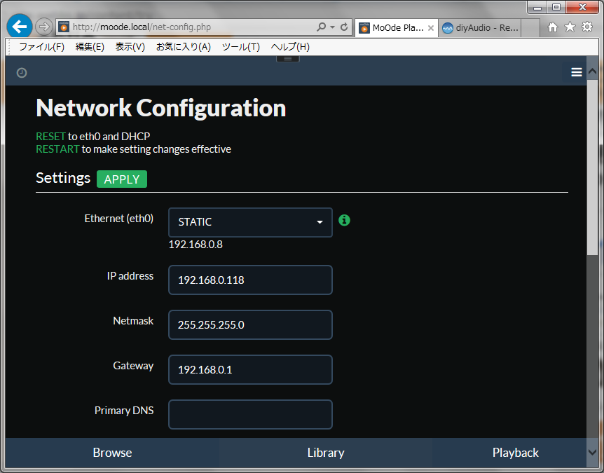

I cannot switch to the static IP address.(r2.6)
😕Hi,
I was going to change the IP address from the DHCP to the STATIC.
But do not change in r2.6.
I could well in the previous version.
Is there any information to be settled?
*The image is state I after the reboot.
Thanks!
