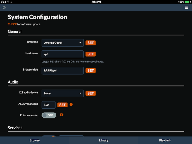

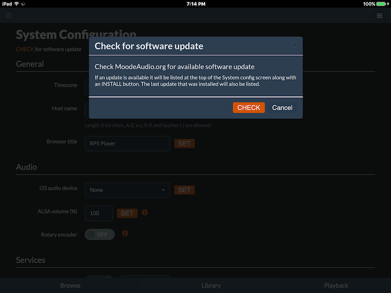

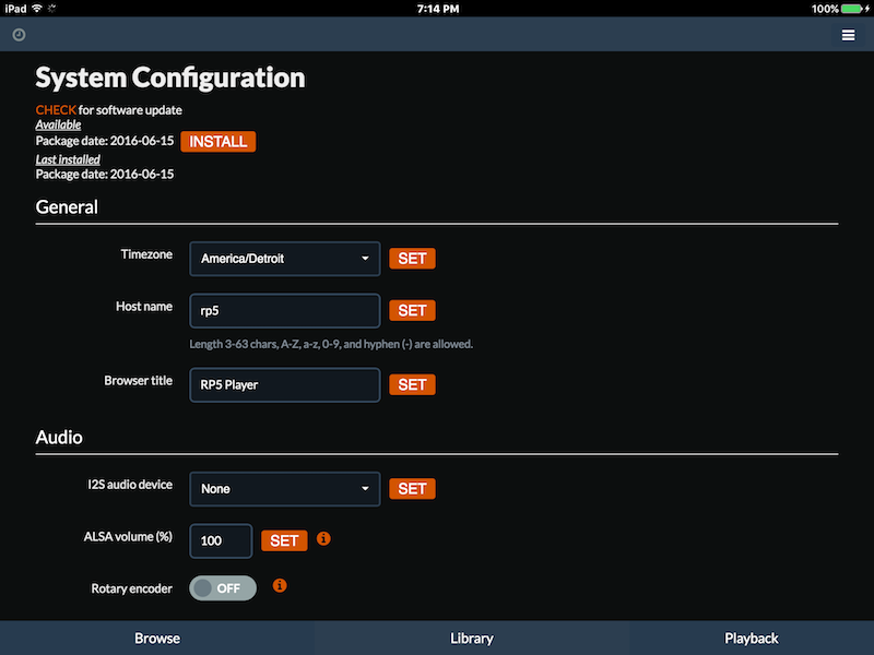

Attached are some screen shots of a new in-place software updater that will be included in Moode 2.7. The updater can also be bootstrap loaded into Moode 2.6 using a bit of SSH.
This initial version provides a mechanism for updating Moode that can quickly deliver bug fixes and code updates thus eliminating the need to install new image. Future enhancements to the updater can provide migration of settings, sql and complex OS changes.
Tim
