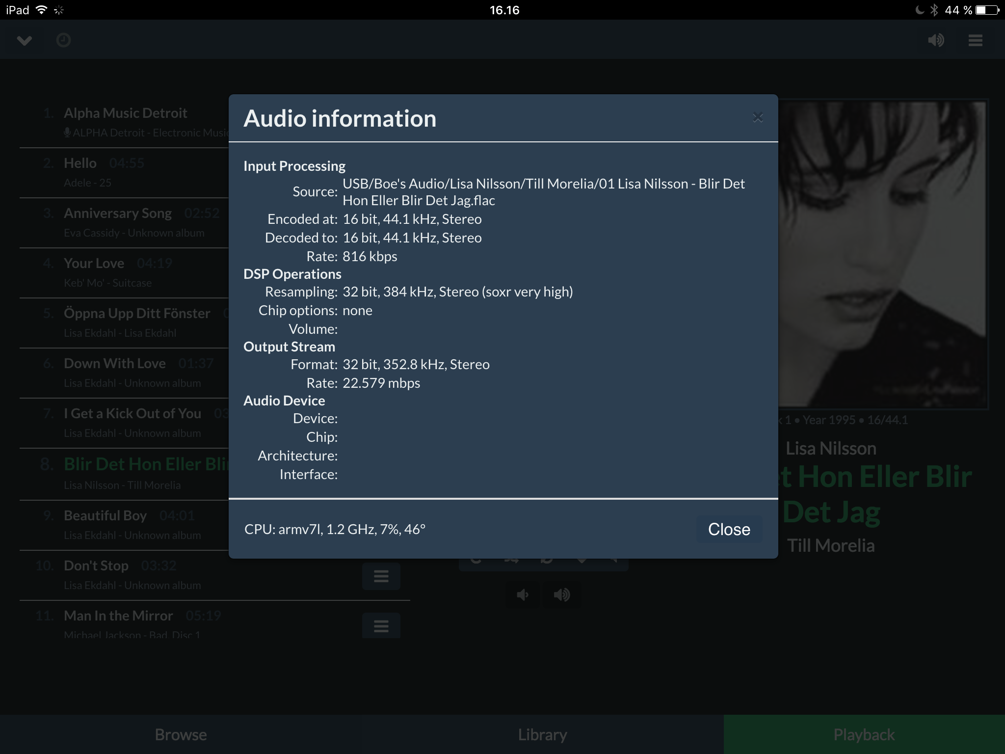

Samplerate
Hi Tim
Thanks for a lovely product that really sounds and works perfectly on my rpi3 with a Mirand USB Dac.
But is there a way to set the samplerate to 32/176.4 and 32/352.8??
All best / Anders
Hi Tim
All best / Anders

Hi Anders,
In mainline Linux kernel (which is what Moode uses), max sample rate is limited to 192 kHz. I'm not sure about bit depth. See links below for explanation of sample rate limitation.
Page 24 - start at post #240
http://www.diyaudio.com/forums/digital-line-level/285811-hifiberry-dac-pro-hw-mods-anybody-24.html
Page 25
http://www.diyaudio.com/forums/digital-line-level/285811-hifiberry-dac-pro-hw-mods-anybody-25.html
ALSA patch to 384 kHz
Re: [PATCH] ALSA: core: Add 384kHz Support — ALSA Devel
U could test 32/176.4 with your DAC by first setting it to 24/176.4 in Moode MPD config screen then editing MPD config file followed by restart MPD.
1) sudo nano /etc/mpd.conf
2) sudo systemctl restart mpd
If 32/176.4 rate shows up on Audio info screen under "Output stream" while song is playing then it would confirm that ALSA and SoX support 32 as bit-depth. I could then add that rate to list for sox resampler.
None of my DAC's support 32 bit so no way for me to test.
-Tim
32/352.8
Hi Tim
It already works with 32/386 (it is in the setting), and I have tried with 32/352.8, as you described, and it works 🙂
Best / Anders

Hi Tim
Best / Anders
Hi Anders,
Great, thanks for testing. Re-reading the posts, the sample rate limitation discussed applies to I2S interface. Looks like no such limitation when using USB.
I'll add the rates 32/176.4 and 32/352.8 to the SoX list in MPD config and then push out the update this week 🙂
-Tim
