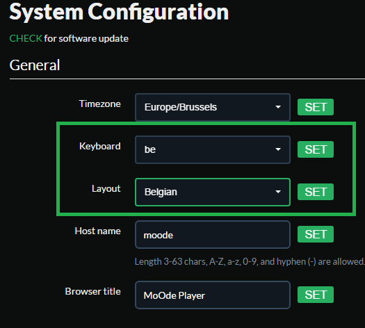

My Help for international users
Hi Tim,
Enjoying Moode 2.6 on my Pi3 which now has an IQaudio Pi-DAC+.
But as I don't have a QWERTY keyboard and thought others might not either. I wanted to add a Keyboard & Layout option to the Sys Config.
I add 2 entries into the DB, "keyboard" and "kvariant"
I added the following to worker.php
and to sys-config.php I added
and
also
To util.sh I added the following;
I added the following to sys-config.html
The two inc files I created are "keyboard.php"
and "kvariant.php"
Result as it shows in the UI see image.
Let me know if I should send over to you the files for a double check and hopefully to be included in the next update 😱
Richard
Hi Tim,
PHP:
case 'keyboard':
sysCmd('/var/www/command/util.sh set-keyboard ' . $_SESSION['w_queueargs']);
break;
case 'kvariant':
sysCmd('/var/www/command/util.sh set-keyboard-variant' . $_SESSION['w_queueargs']);
break;
PHP:
require_once dirname(__FILE__) . '/inc/keyboard.php';
require_once dirname(__FILE__) . '/inc/kvariant.php';
