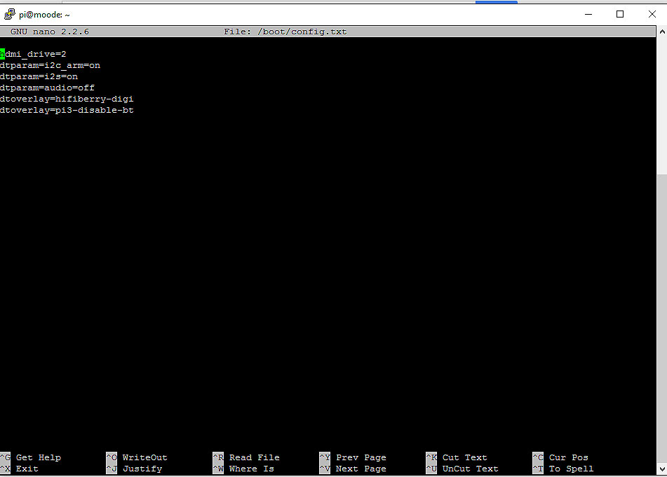

Still get white noise, but atleast with something in the background now.
Attached the boot/config.txt via a screendump of putty.
Suggestions?
