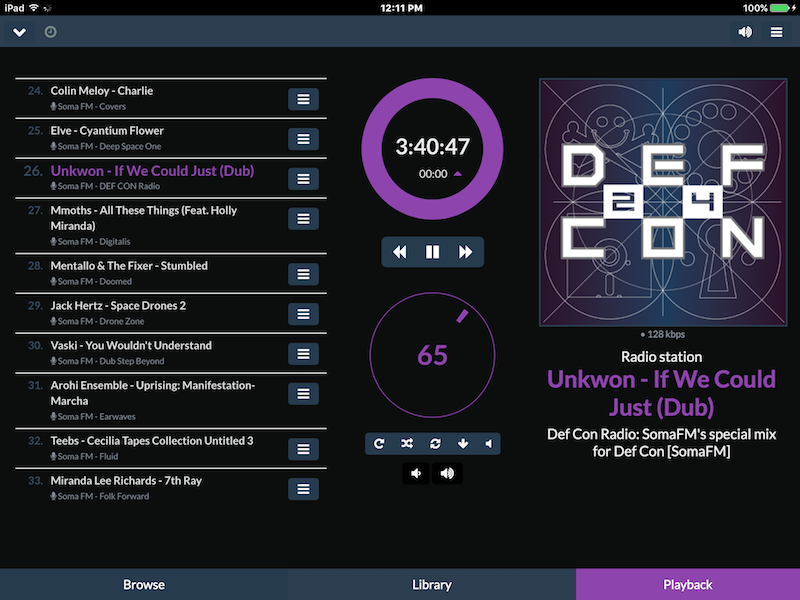

Moode Audio Player release 2.6 is available for download at moodeaudio.org 🙂
This release includes support for the wonderful new Raspberry Pi 3, moodeOS a robust operating system based on Raspbian Jessie Lite (J-Lite), automatic Access Point (AP) mode for direct WiFi connection, Auto-shuffle, Airplay metadata and cover art, a great selection of commercial-free, listener-supported radio stations and many other new features, updates and bug fixes.
Please read the attached Release Notes and view the Setup Guide at moodeaudio.org for more information.
Enjoy!
Tim Curtis
