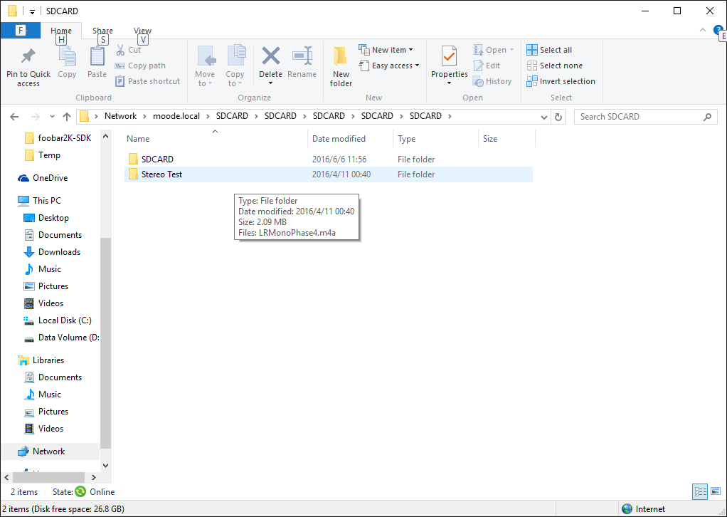

SDCard folder access from Windows
Hi Tim,
I just installed 2.6.
Lots improvements from 2.5 !
One thing I got into trouble is accessing SDCard folder from Windows PC.
When I click SDCard, it goes to SDCard endlessly.
See the screen capture.

Hi Tim,

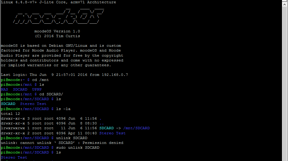

I thought I posted a reply but it doesn't appear(if duplicate, pls ignore)
I removed the symlink in SDCARD folder. SDCARD -> /mnt/SDCARD
/mnt/NAS behaves similarly.
These are bugs which I'm planning to release fixes for as a downloadable patch file for in-place updating 🙂

BUG #2: circular symlinks being established for /mnt/NAS and /mnt/SDCARD. Caused by code in worker.php plus different behavior of new moodeOS.
FIX: circular symlinks removed from /mnt/NAS and /mnt/SDCARD, code removed from worker.php
