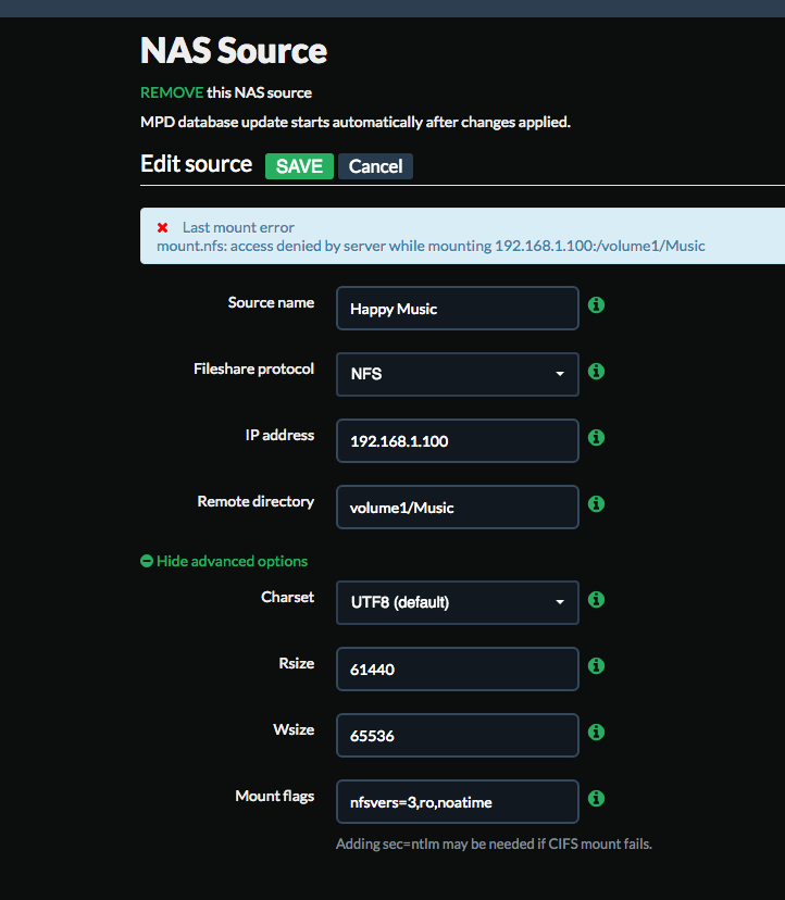

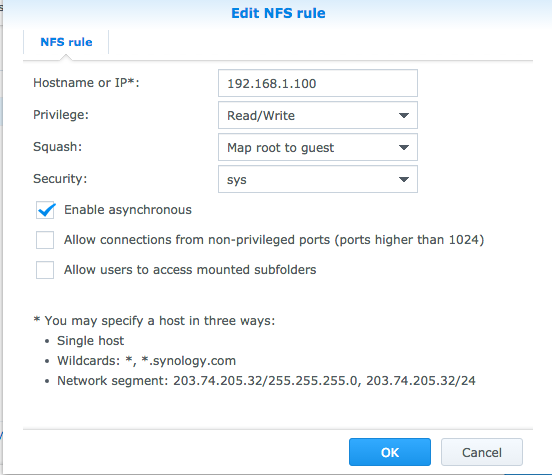

Accessing NAS via NFS
Have Pi 3 connected to wifi and it works great except I am unable to access the music files on Synology NAS. The error message seems to indicate that NAS is looking for certain credentials i. e. account name and password. At least I think that is the issue. I have included a couple of screen shots and would like some comments and suggestions on how to solve connection between Pi 3 and NAS. Thanks
MAC OSx
Synology DS415play
Pi 3
Hifi berry DAC Pro
Moode TR5
