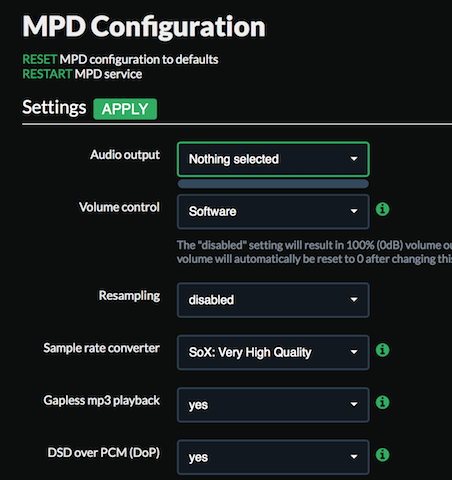

Hi
I have a problem with Moodle 2.6 Test Release 5 (TR 5) - RPi3+Soekris
There is no audio output settings 🙁
on the TR3 is ok
