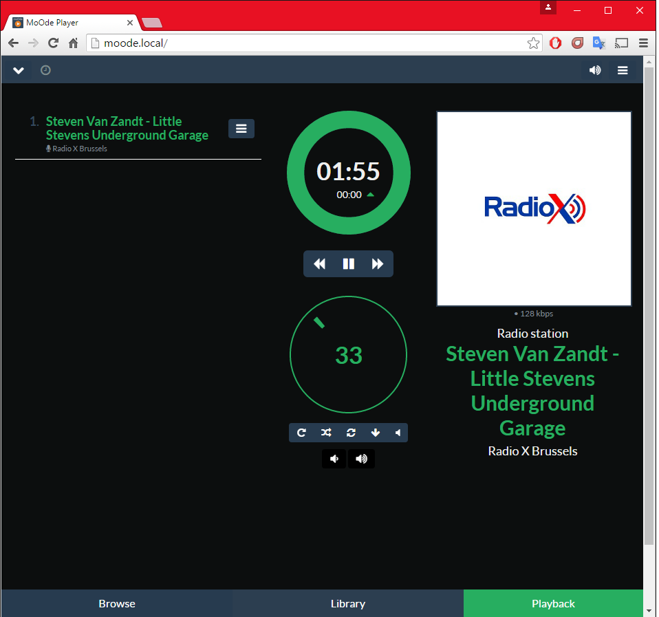

Loving the new version (esp. 320k BBC feeds 😉 ).
Still trying to perfect my install with Official 7" Touch display using Midori in application mode. Would love to find a way to react like other touch devices like iPhone/iPad..... any suggestions already tried changing User Agent...
Also new station I added "Radio X Brussels", url : "http://fire.wavestreamer.com:7885/stream/1/" and logo attached.
I installed chromium (install steps at #2108), but it isn't responsive enough... (Rpi2)
I use android and mpdroid instead....😐
I guess Chromium might be a choice worth investigating.

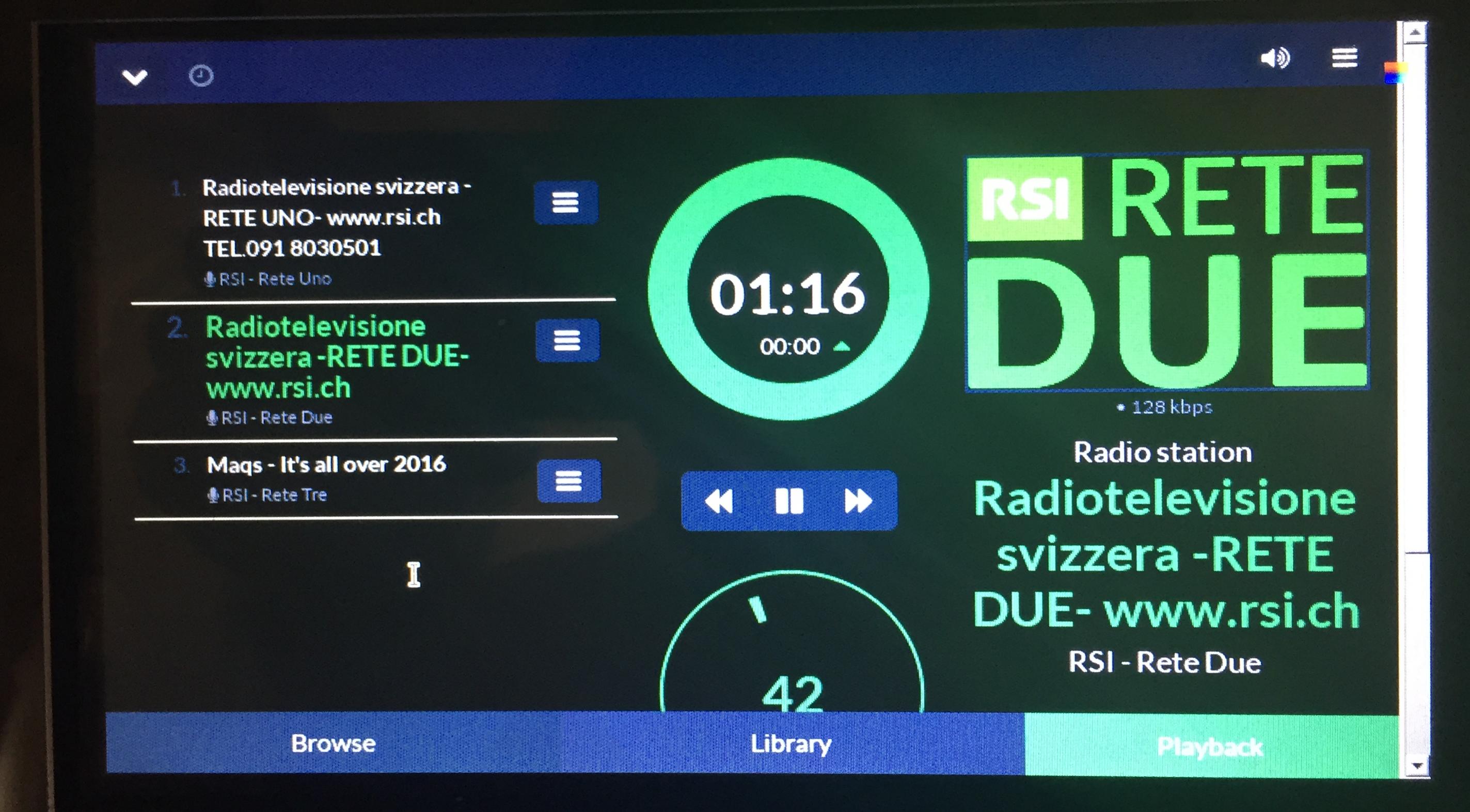

i'm using iOS devices and the extra power of Rpi3 helps I guess, here is a screenshot with RSI Swiss Italian Radio stations;
Again urls :
http://stream.srg-ssr.ch/m/reteuno/mp3_128
http://stream.srg-ssr.ch/m/retedue/mp3_128
http://stream.srg-ssr.ch/m/retetre/mp3_128
Logos attached
