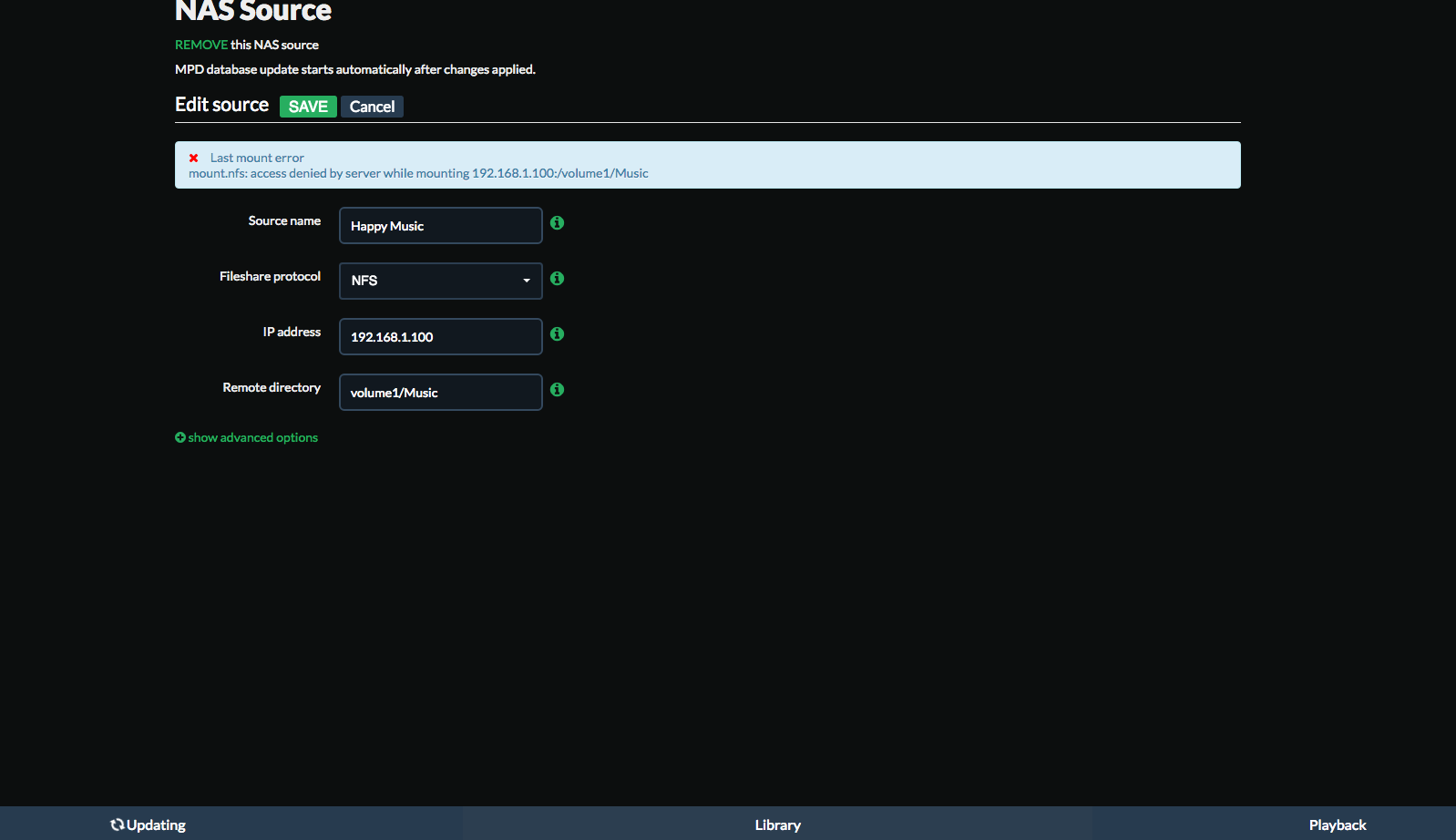

Have Pi 3 connected to wifi and it works great except I am unable to access the music files on Synology NAS. The error message seems to indicate that NAS is looking for certain credentials i. e. account name and password. At least I think that is the issue. I have included a couple of screen shots and would like some comments and suggestions on how to solve connection between Pi 3 and NAS. Thanks
MAC OSx
Synology DS415play
Pi 3
Hifi berry DAC Pro
Moode TR5
Try Squash = No mapping
-Tim
Thanks changed to No Mapping. It is weird the error appears on the screen but I noticed in the bottom left it says updating. Is that a good sign?

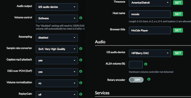

Do u know if Soekris DAC works with the plain HiFiberry DAC driver?
If not then disregard, otherwise try selecting "HiFiBerry DAC" (not the DAC+) as the I2S driver in System config.
Btw, the repro suggests that rpi-dac I2S driver in 4.4.10 kernel is broke.
-Tim
RPi3 + Soekris - I2S - I2S - audio device - "HiFiBerry DAC" = WORKS! 🙂
It will repair I2S audio device "Soekris DAM1021 (I2S)" in 2.6?
Thank you Tim
Thank you Tim
Thanks for confirming this, much appreciated!
Yes, I could make this change for 2.6 so that Soekris DAC (I2S) uses hifiberry driver instead of rpi-dac driver but I need to investigate further, and would also like to get confirmation from the other Soekris users below that hifiberry-dac driver works for them.

It works with DSD!!!
I had to move "DSD over PCM (DoP) - NO"
