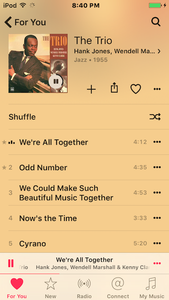

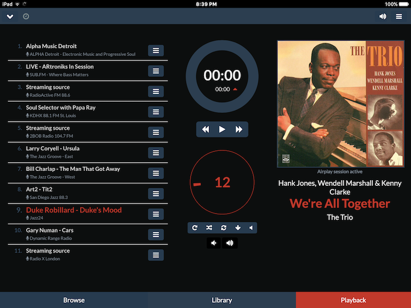

1) Airplay metadata provides the capability to retrieve artist, album, title, genre and cover art from Airplay sending applications e.g., iTunes etc. and display the items on Moode UI. Code courtesy of AndiG and MikeB, adapted and integrated 🙂

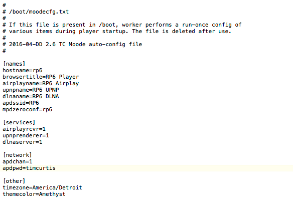

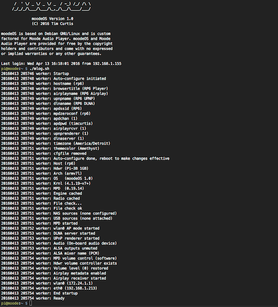

2) Auto-configure is geared for environments where multiple Moode players are deployed. It performs a set of common name and service changes to a fresh Moode image at boot time thus eliminating the need to manually make changes using System and MPD config.
Some screen shots attached.
