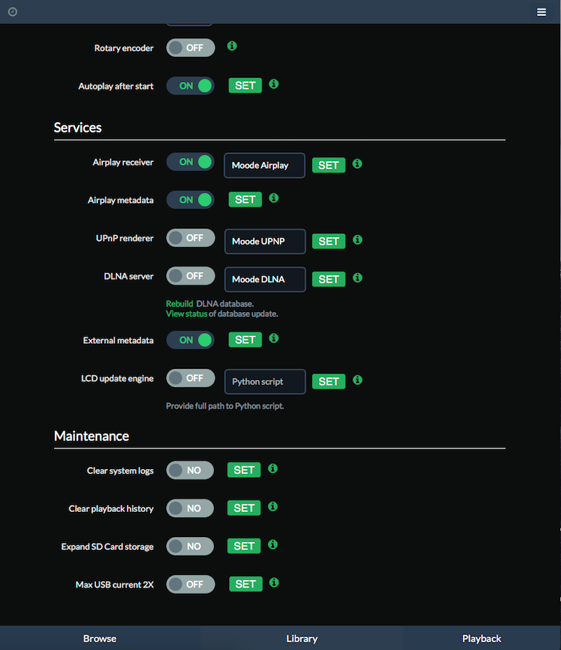

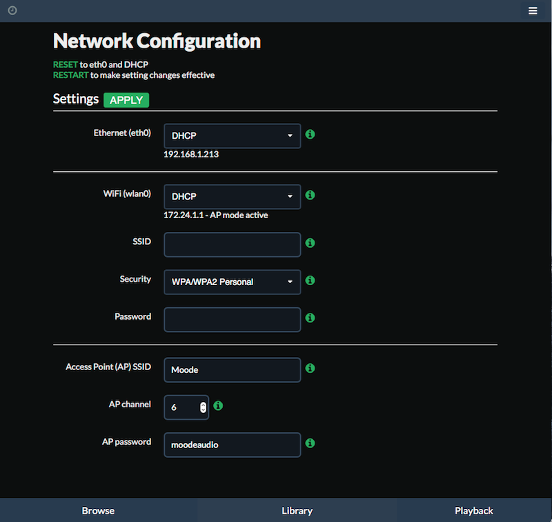

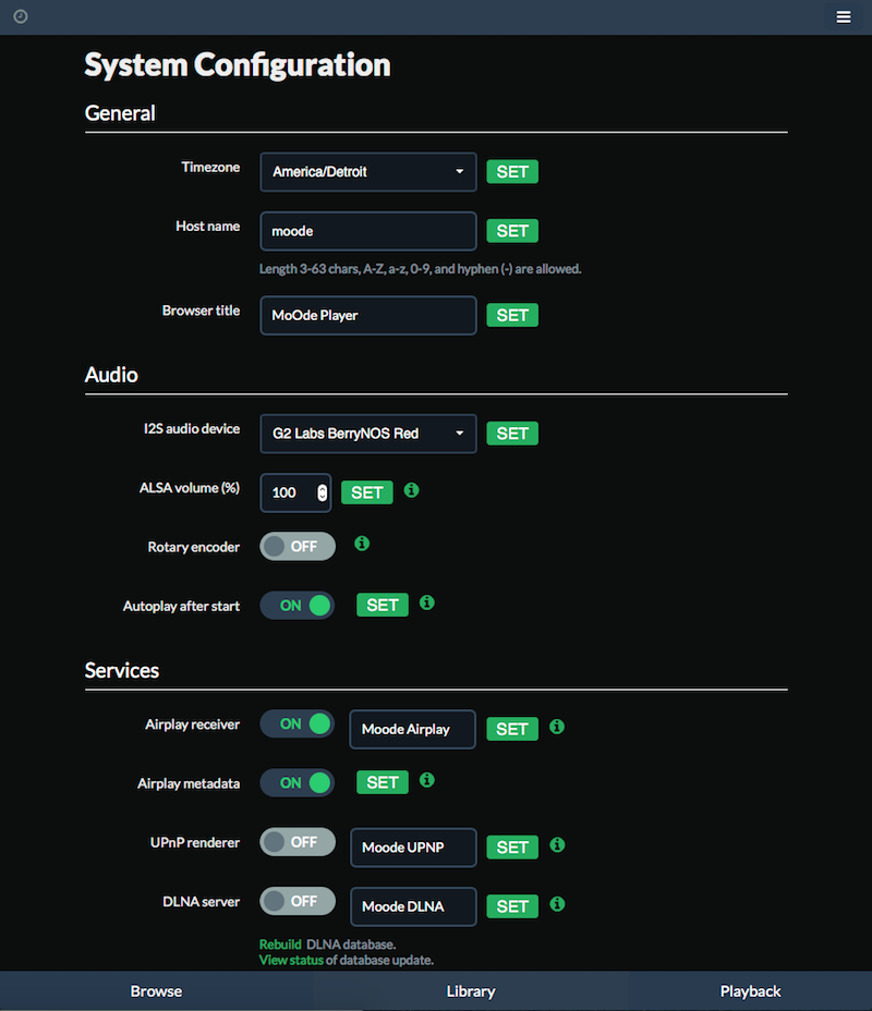

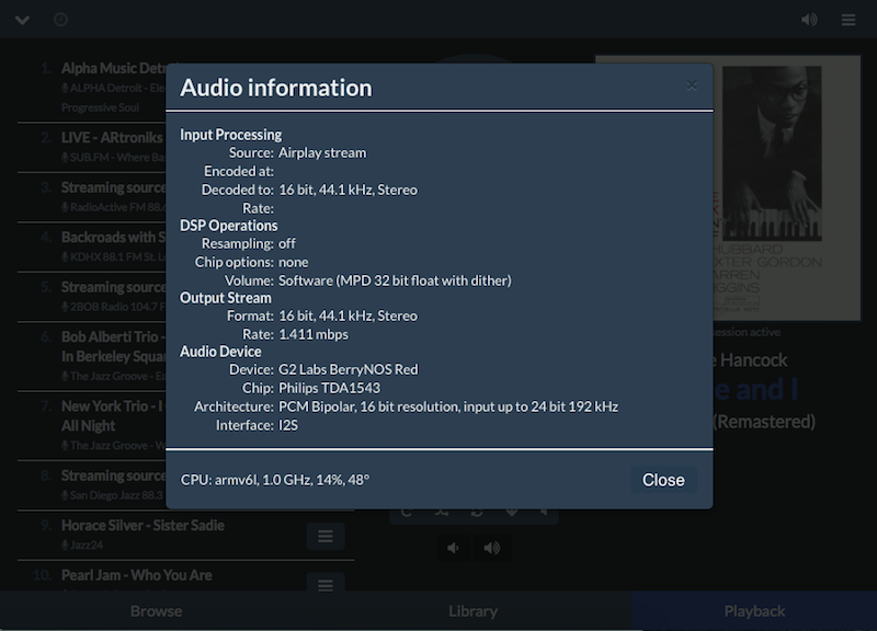

Here are a few more screen shots of Moode 2.6 as it nears completion 🙂
The Access Point (AP) mode settings have been moved to Network config and there is a new setting on System config for Airplay Metadata. I also included a screen shot of some debug logging for the new Airplay metadata feature.
Tim
"...nears completion" is sounding awesome Tim, looking forward to 2.6!!!! :spin:
I'm curious how setup will be on a secure network with the new moodeOS. I believe you mentioned something about being able to connect to Pi3 when 2.6 is initially loaded for the first time, before any network settings has been established?
In other words, we won't need an Ethernet connect for setup, correct? 😕 Will we use "http://runeaudio.local/" via a networked browser, or some other method?
