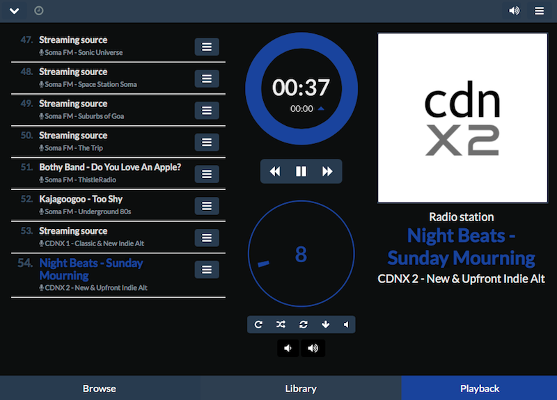

CDNX 1 and CDNX 2, the two stations operated by Camden Xperience are available via these addresses:
http://svr1.msmn.co:8136 (CDNX 1)
http://216.120.247.102:8118 (CDNX 2)
Sadly both are only broadcasting @ 128 kb/s, but hey good indie/alternative vibes... When there's a chance could they be added to the list of radio stations?
Thanks, didn't know them! I like the genre, nice to have them in moode's next version :note:
