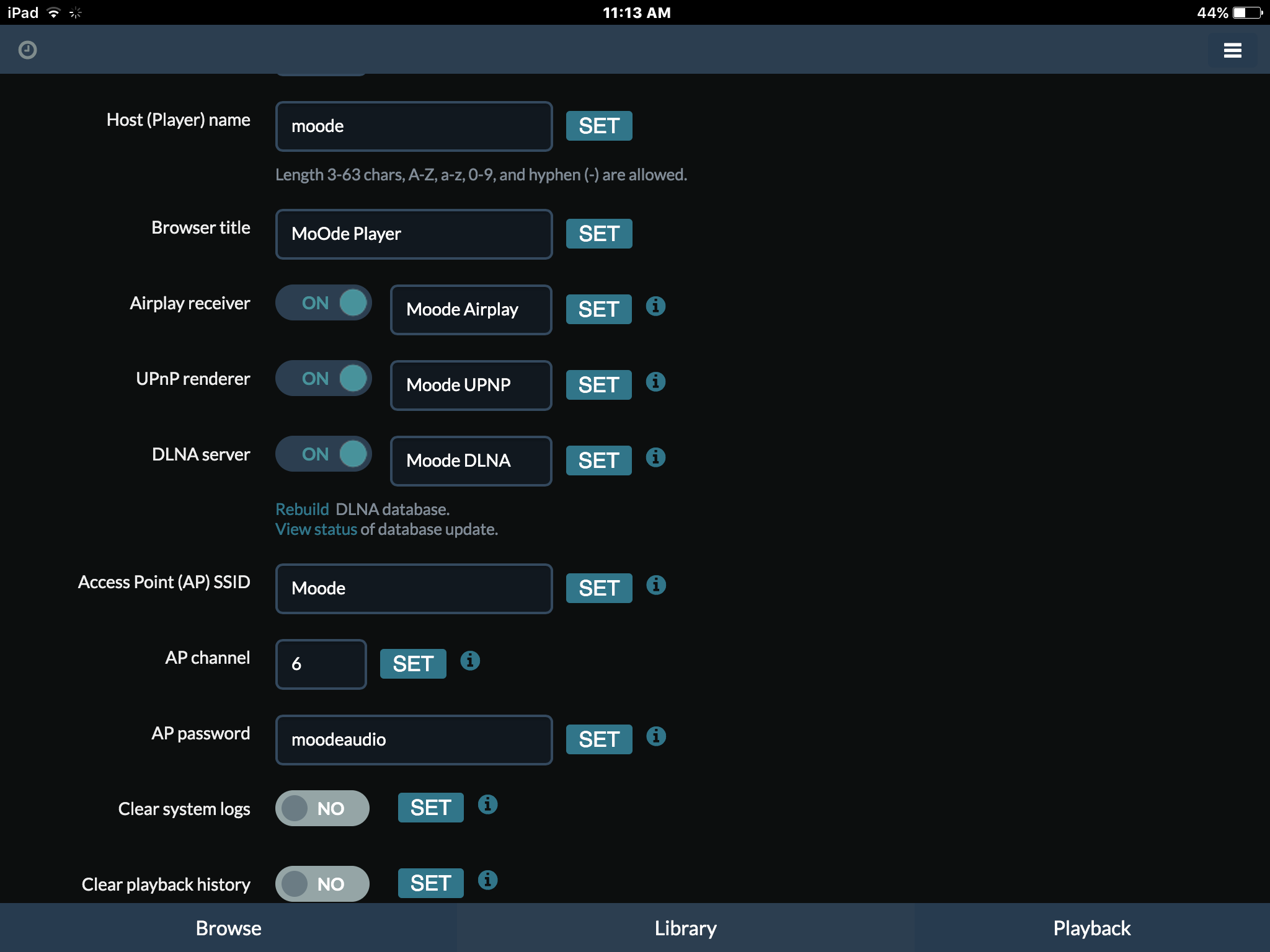

I read through the docs and it appears there is a Rebuild function but no Rescan, and the live-update feature is implemented by attaching an inotify to EVERY folder in the collection. That seems messy...
I think I'm going to have to stick with manual rebuild of the db. I can make it a bit more convenient by adding a "rebuild" button to Sys config, or possibly auto-run the rebuild whenever mpd db update happens.

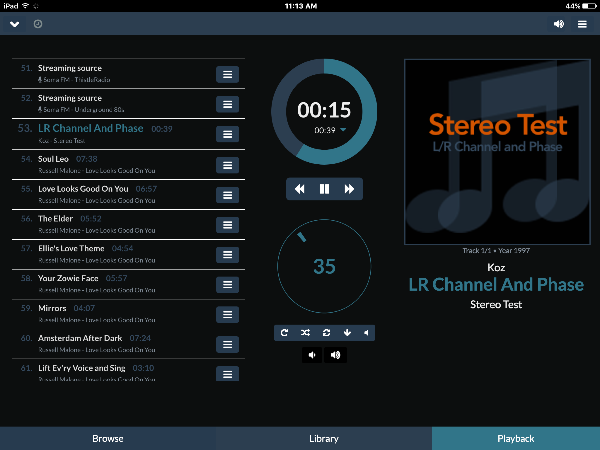

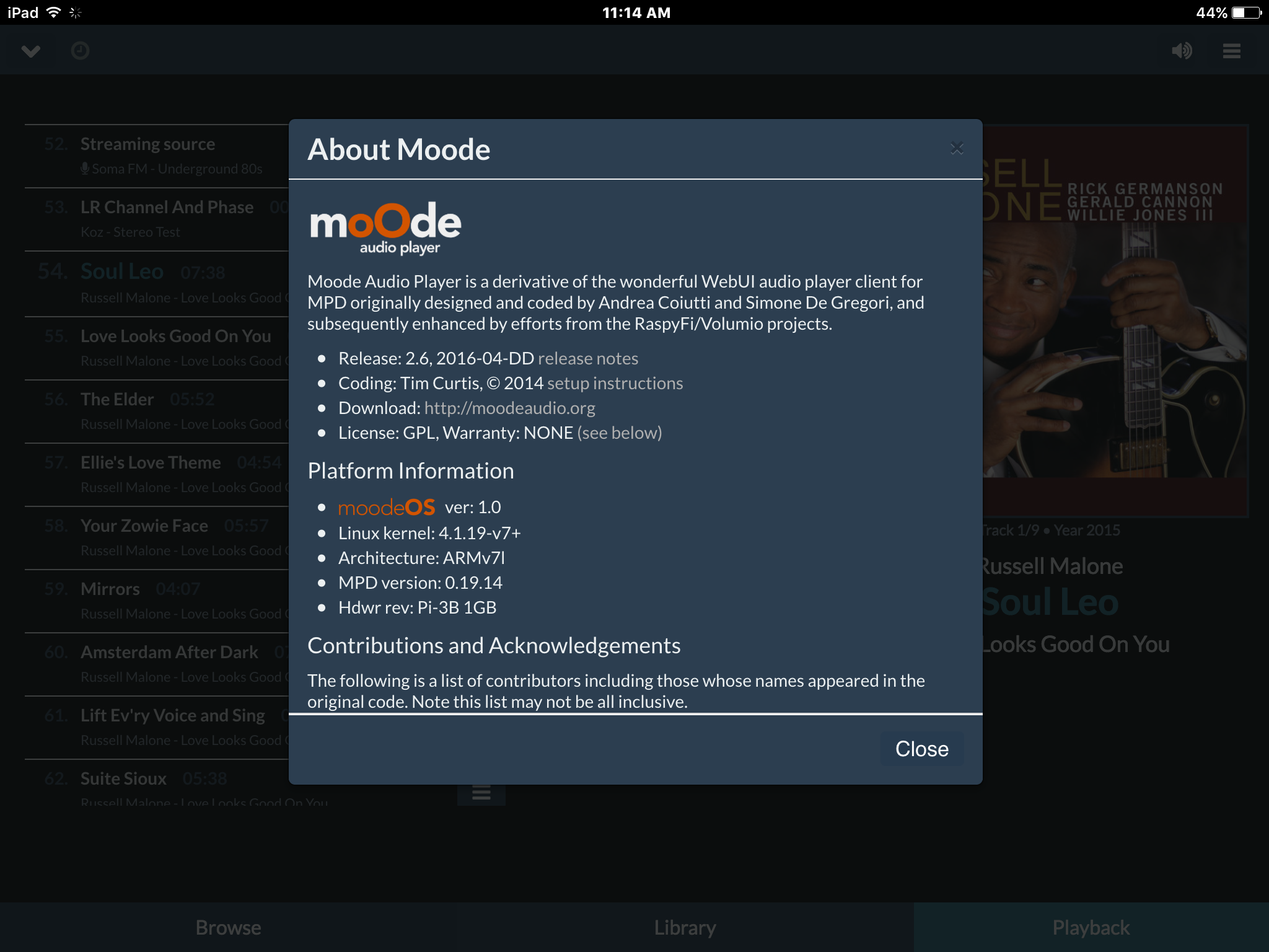

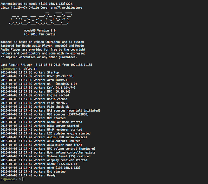

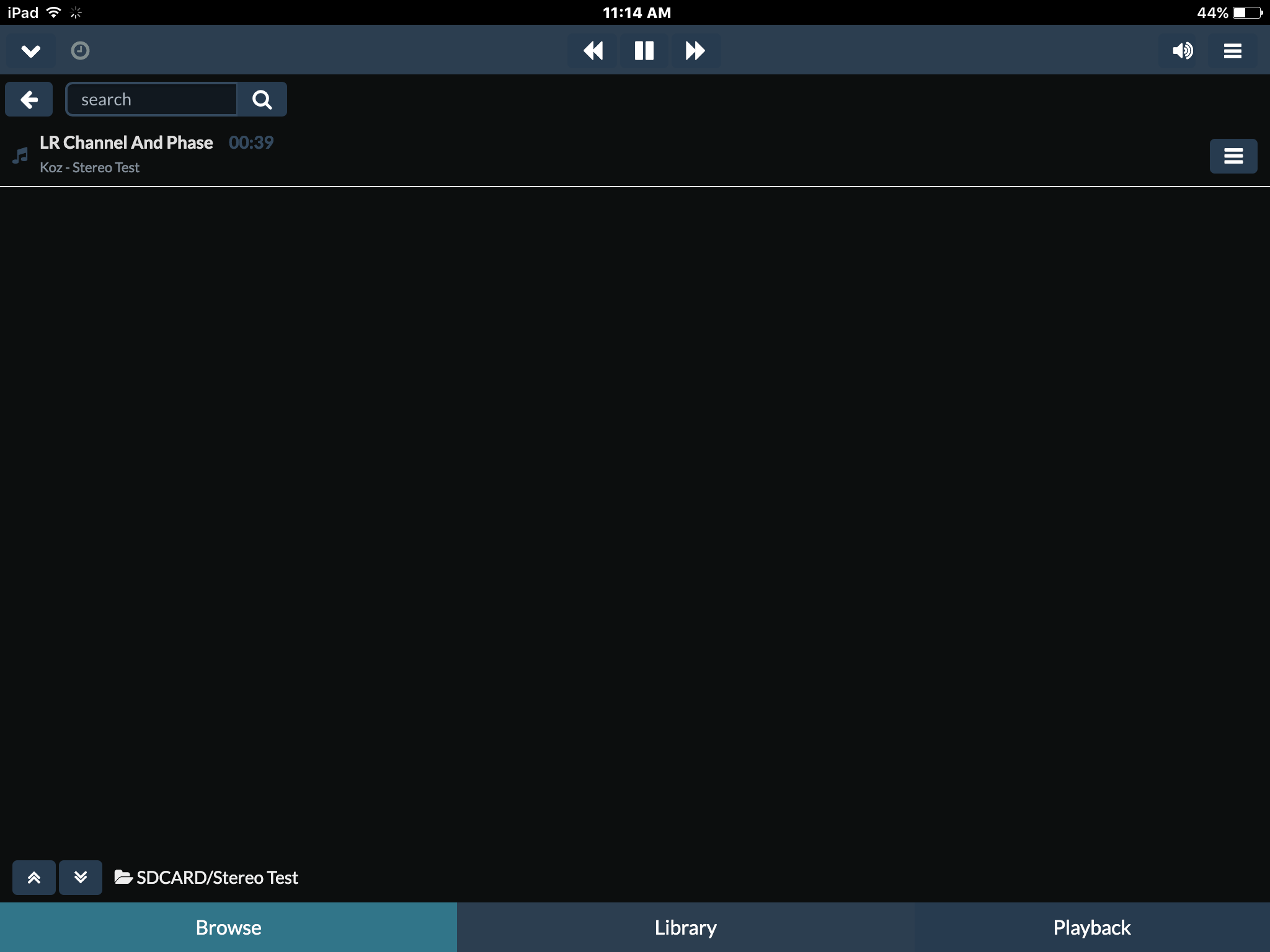

A few more screen shots of Moode 2.6 and moodeOS 1.0.
A convenience setting has been added to System config to Rebuild the DLNA database, the startup log has a bit more detail and I'm thinking of including a stereo test file. Still waiting for raspberrypi.org to release official methods for disabling Pi-3 integrated WiFi/BT adapters. This is to support usage scenarios where only ethernet is used or where user supplied wifi adapter is used.
Great idea. Are there any other test files that could be useful also? Most will take up very little space anyway especially if they're okay with being lossy encodes.
Maybe a file of silence (or a very quiet signal) for checking for any hum/interference?
