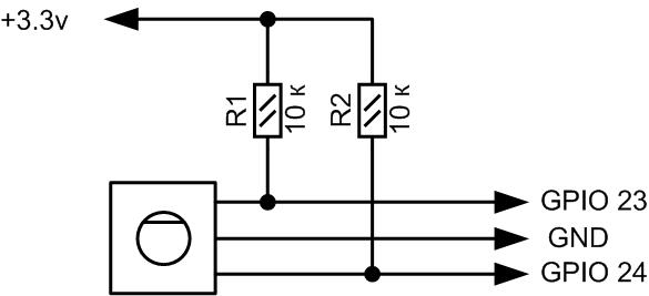

So the author of the program through which the enkoder works recommends.
Which didn't answer my question "Can't we use the internal pull-up resistors?"
That's why they are there - to pull up the pin.
Or... if it isn't being used as a pull-up (or down) to fix a floating pin to a particular state, then it's being used as a current limiter, to protect the GPIO pins from over-current damage.
But... if it is to fix the floating state, you should enable the internal 1.8K pull-up resistors, they are there for a reason.
Which isn't to say that you don't put protection from random stray currents externally, depending on what you are doing, that can be a fine idea.
But, in your example, it's being used as a pull-up, when the Pi has a perfectly functional internal pull-up/pull-down mechanism built in.

Most likely you are right and it is possible to use internal Pi resistors. I had available had an enkoder on a board with already soldered resistors, I have connected him, he works. I can't experiment with other enkoder yet.
What Moode version are you using? I've tried this on my Pi2 running Release: 2.4 and it's not responding. I've done a continuity test to ensure that the encoder's functioning properly...
I've got center pin to connected directly to ground, pins 1&3 are connected to GPIO pins 23&24. I've also got 10k resistors connected between 3.3v and encoder pins 1&3
Any advice?
DarpMalone
I have connected as I have drawn, to Moode 2.5.
The sound card of Suptronics X400 at me. Because of a mistake in display of the Customize menu I have chosen from the list of I2C devices IQaudIO Pi-DAC+ (both of them are brought together on PCM5122). Volume control has to be established in the Hardware mode.
