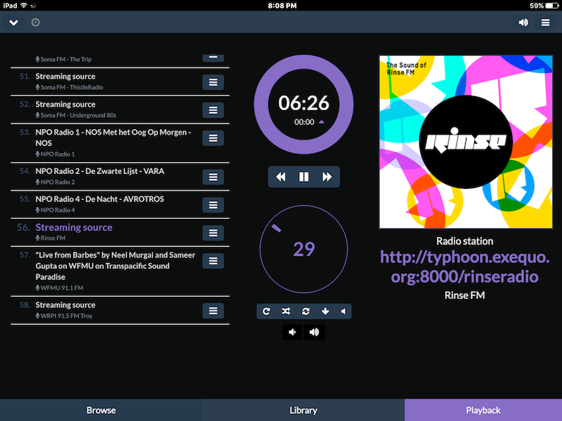

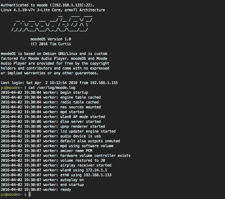

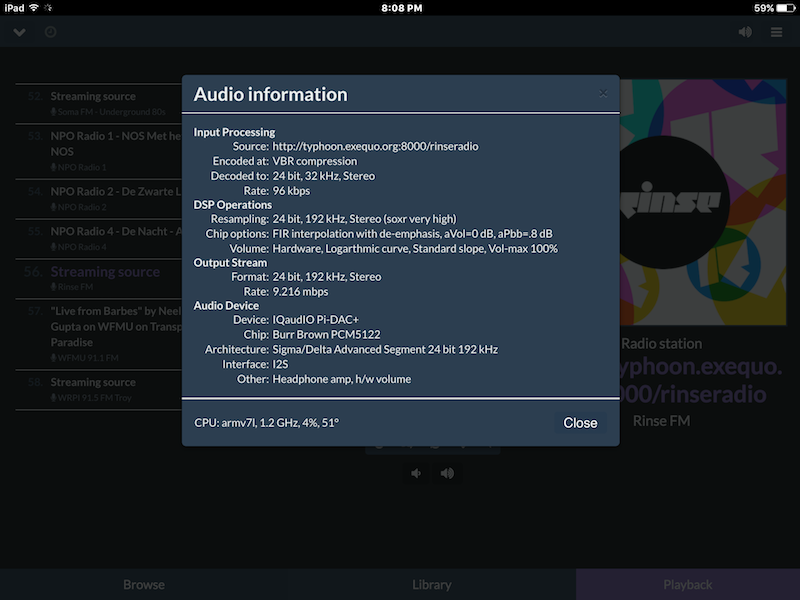

Some screen shots of Moode 2.6 all options enabled, enhanced startup logging plus incredible RINSE FM radio station running on a Pi-3. Note the 1.2 GHz dynamic CPU action 🙂
Regards
Tim

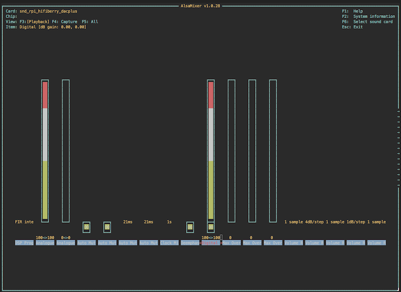

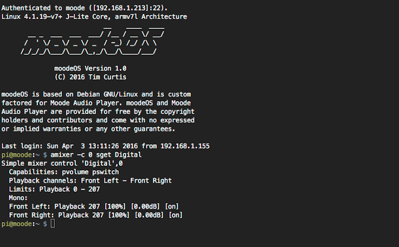

Hifiberry DAC+ showing 0dB at ALSA 100 in moodeOS (J-Lite) so apparently some fixes have been made in kernel and/or overlay drivers. This means that in Moode 2.6 there should be no need to compensate for Hifiberry clipping 🙂
Tim
