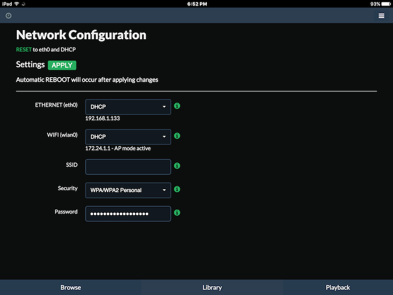

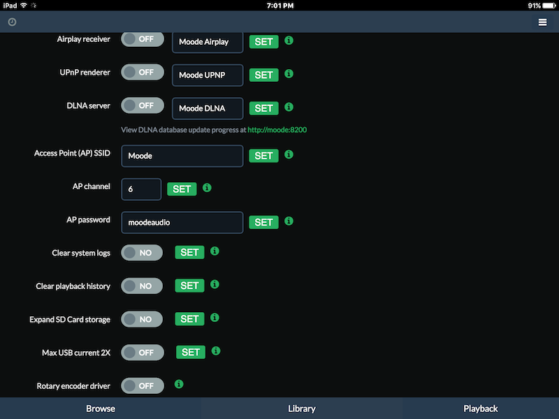

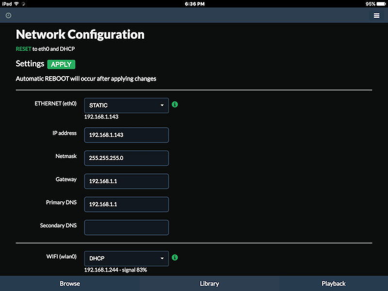

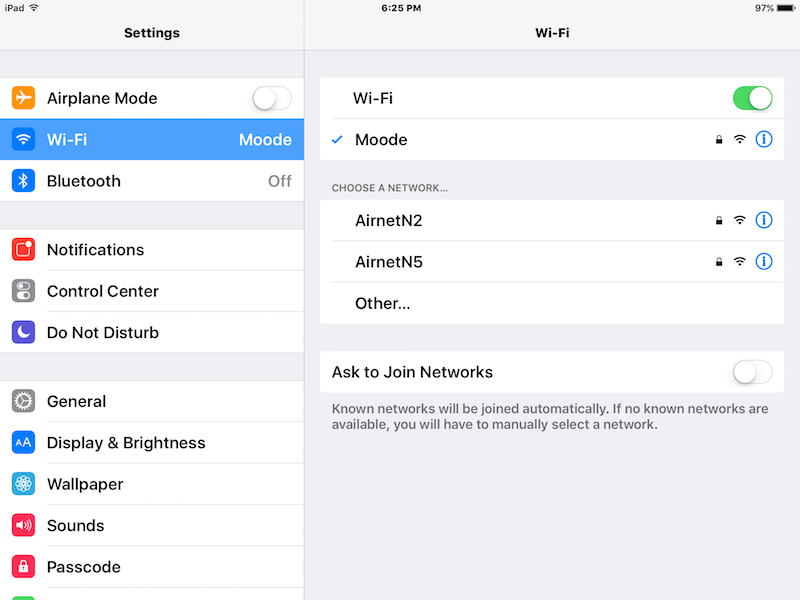

Here are some screen shots of the new Network config system including automatic Access Point (AP) Mode running on Pi-3 🙂
Auto-AP mode works as follows:
1) If SSID has not been configured for wlan0 then it will be auto-configured for AP mode.
2) AP wlan0 interface address is 172.24.1.1/24
3) AP dhcp address range is 172.24.1.50,172.24.1.150 with 12h lease time
4) AP default SSID=Moode, Channel=6, pwd=moodeaudio
5) AP defaults can be changed via settings on System config page
Other capabilities of new Network config system:
6) Both eth0 and wlan0 interfaces can be active at same time
7) Both eth0 and wlan0 can be configured with static addresses
8) Eth0 interface is hot-plug
9) Signal strength is displayed for wlan0
Yet to be completed are:
- Setting to turn ON/OFF integrated WiFi adapter on Pi-3
- Setting to turn ON/OFF integrated BT adapter on Pi-3
Tim

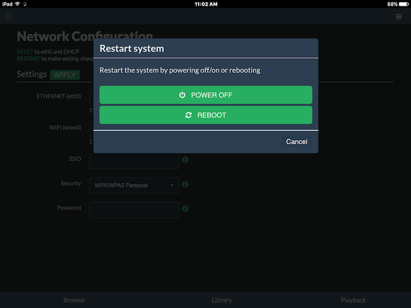

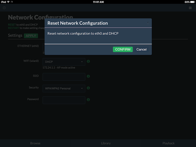

Here are some pics of final Network config screen. Setting changes (APPLY) return the screen instantly 🙂 RESET and RESTART functions require confirmation.
Tim
