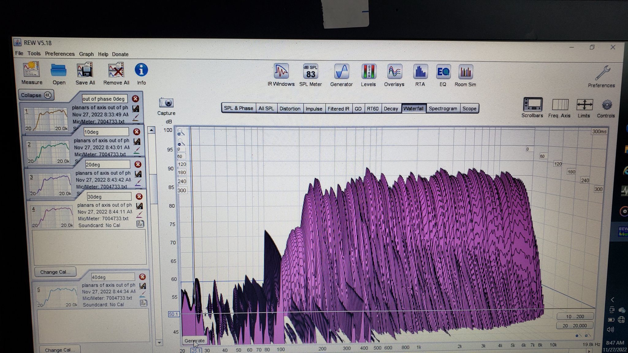

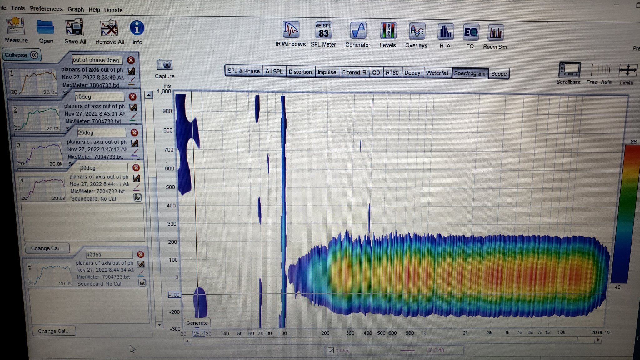

Monsoon planars

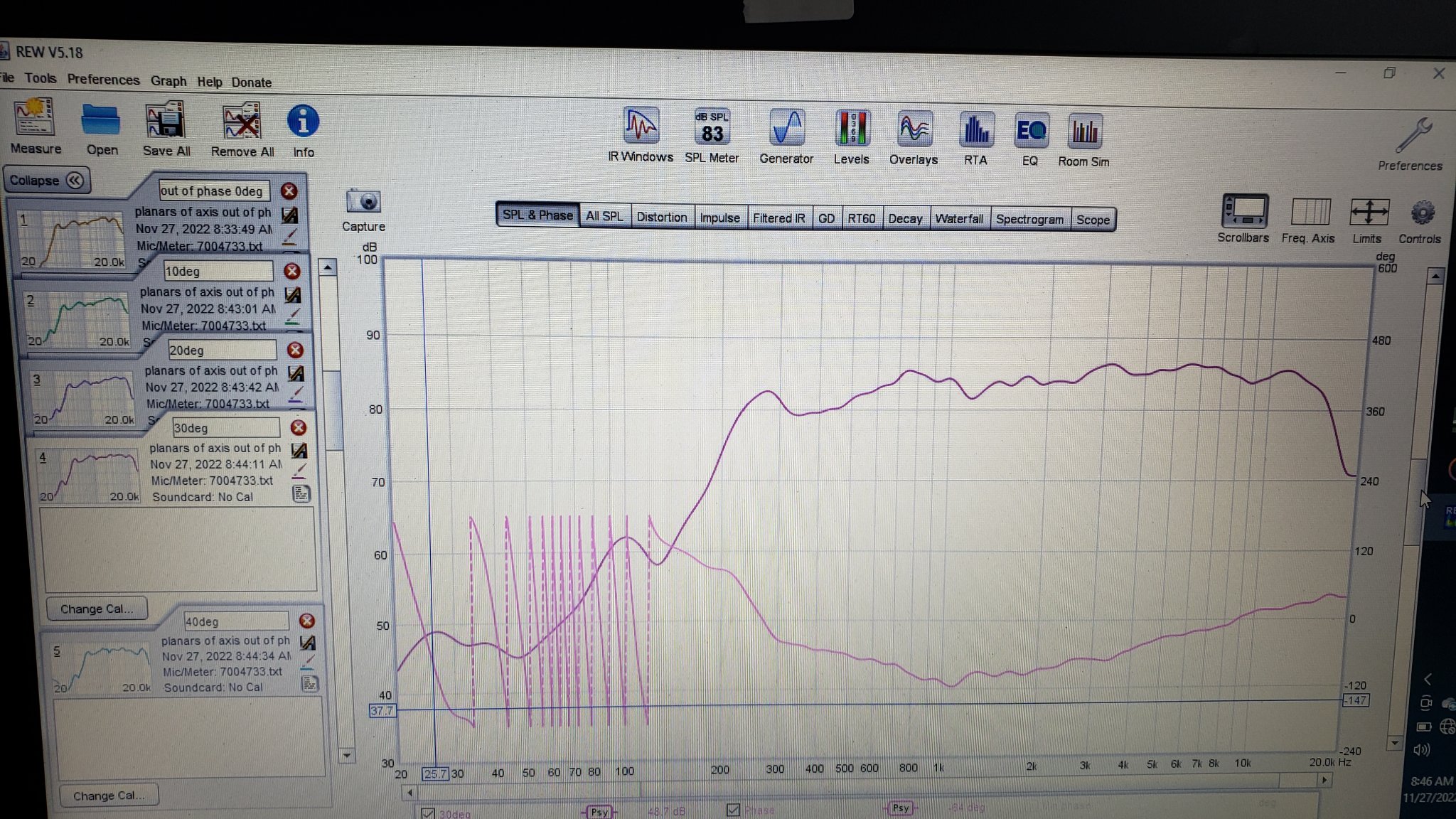

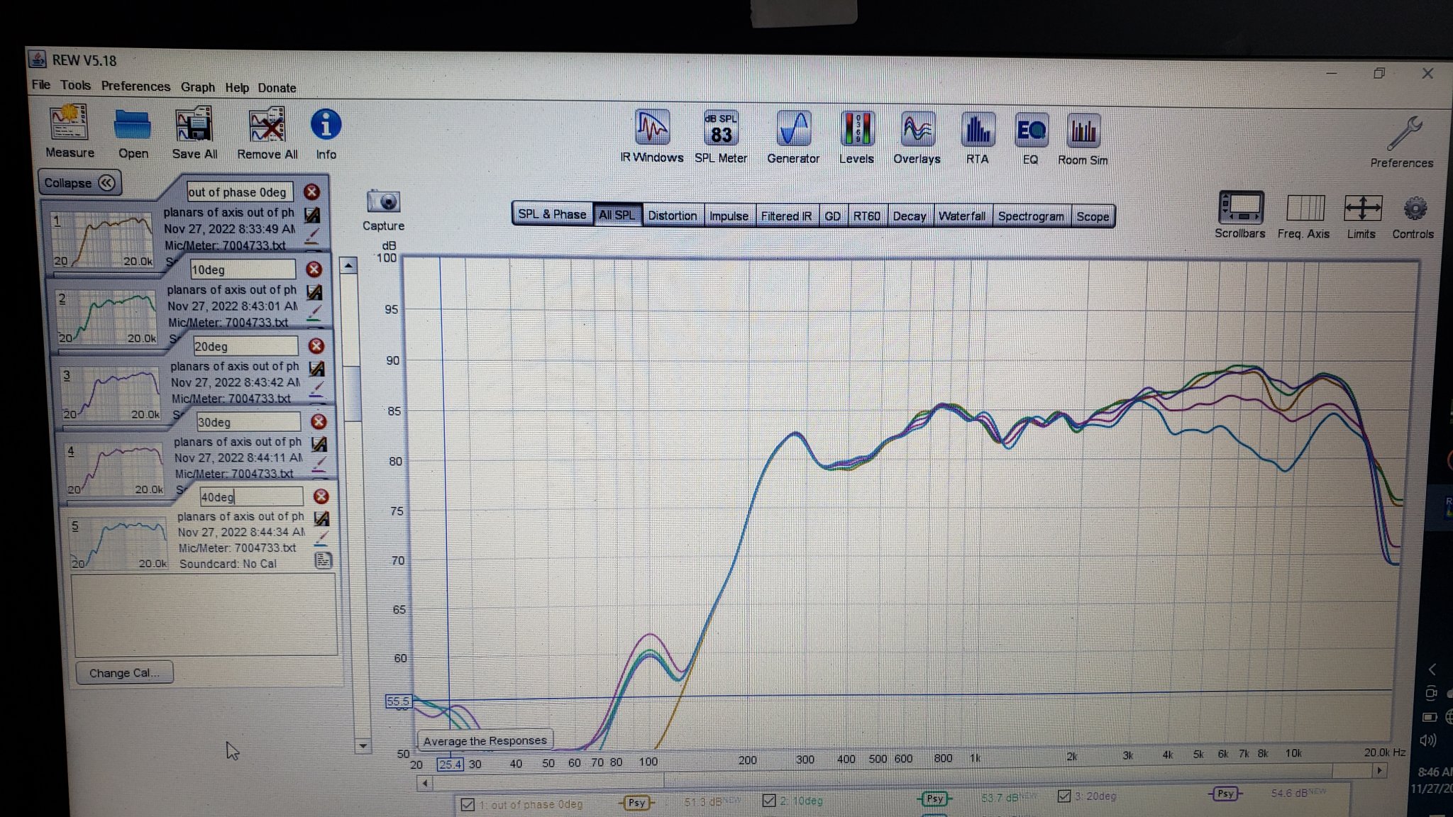

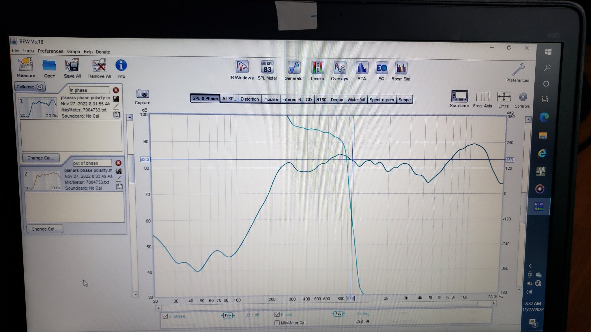

When tweeter is not flipped, thare is dip around crossover frequency and phase goes to hell.

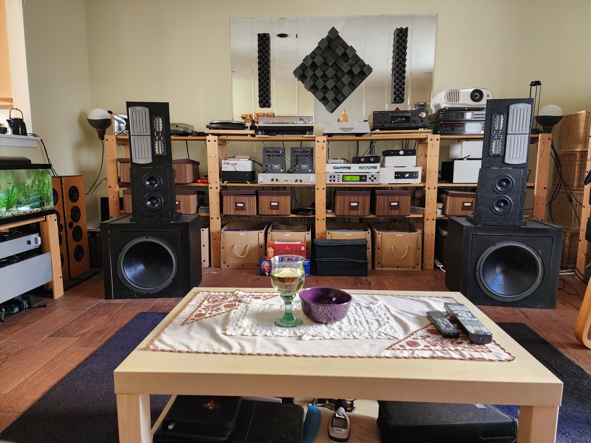

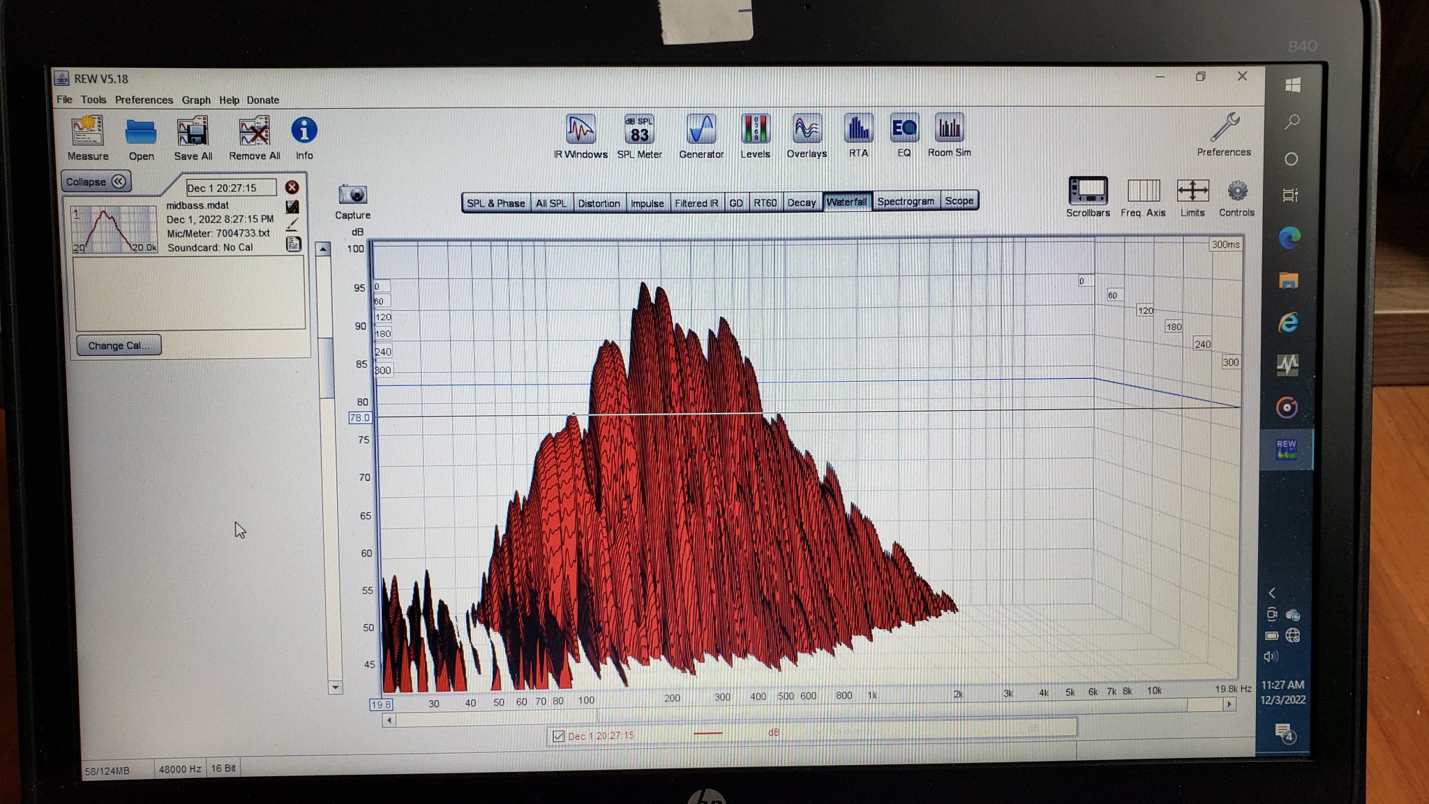

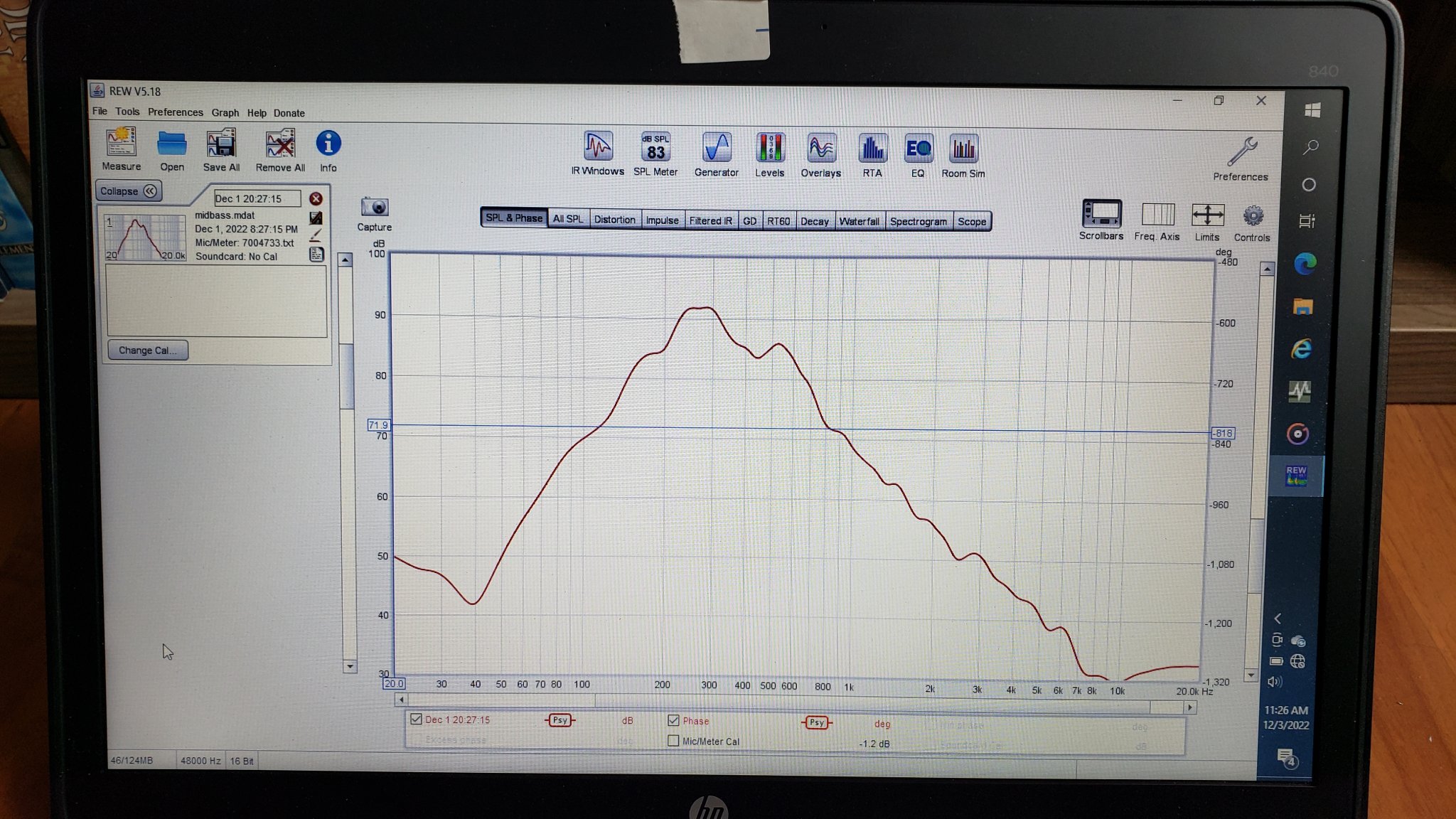

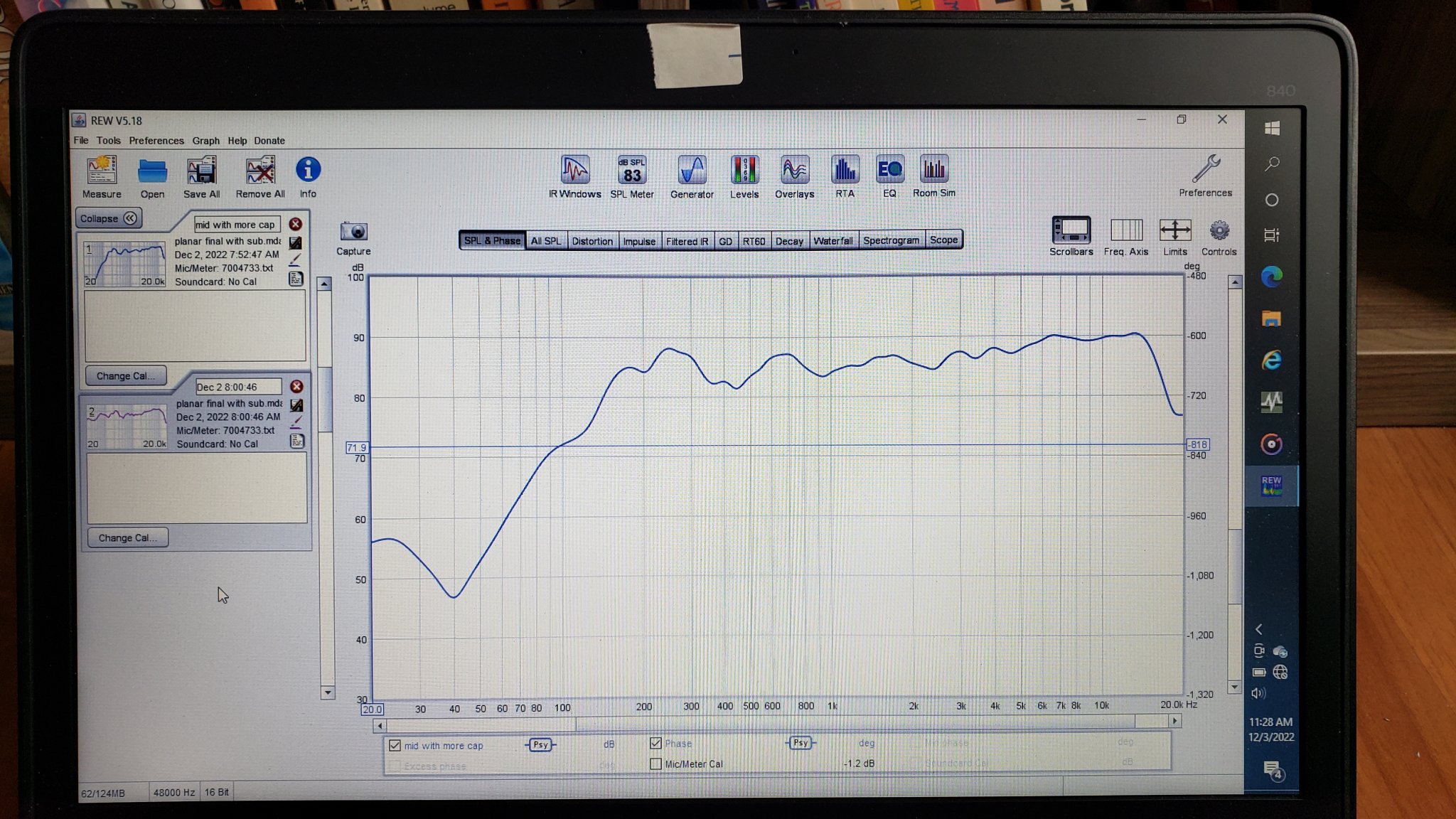

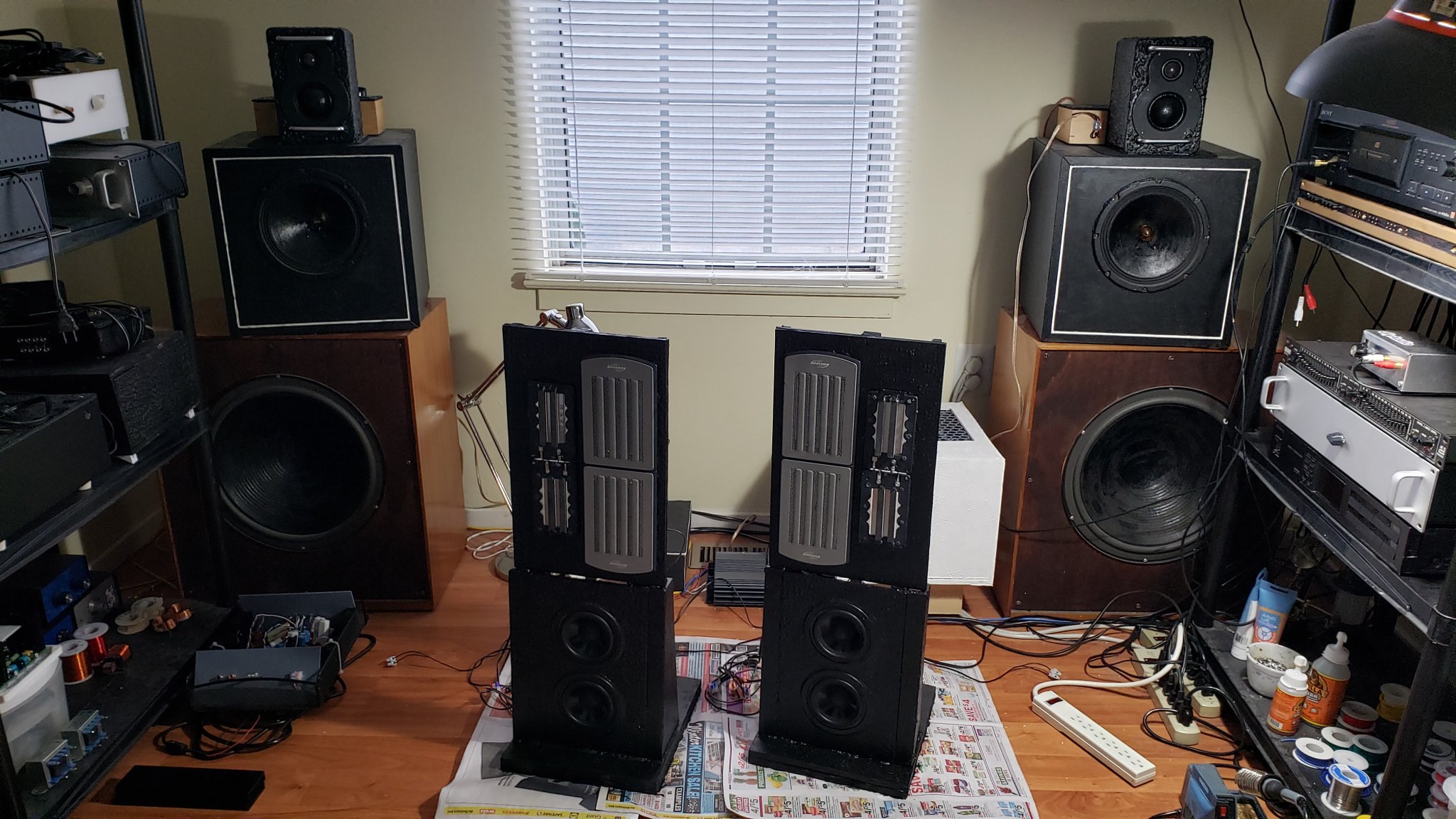

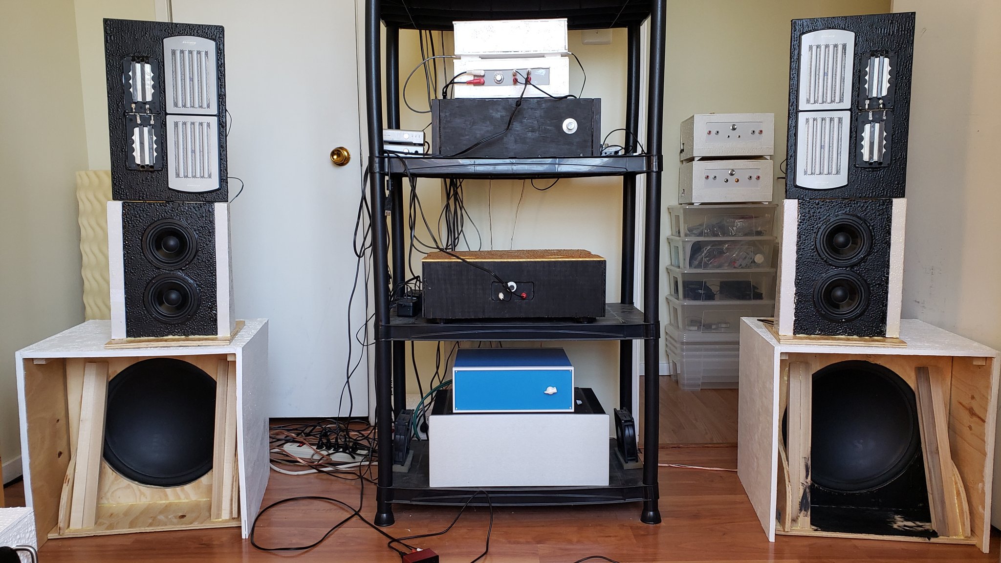

I worked a little on midbass crossover, since its raining. Got second order working ok. This is how it looks with 150Hz high pass by simple active crossover and 300Hz low pass.
Just to bridge 15" woofer to the planar mids.
And the response of midbasses with planars

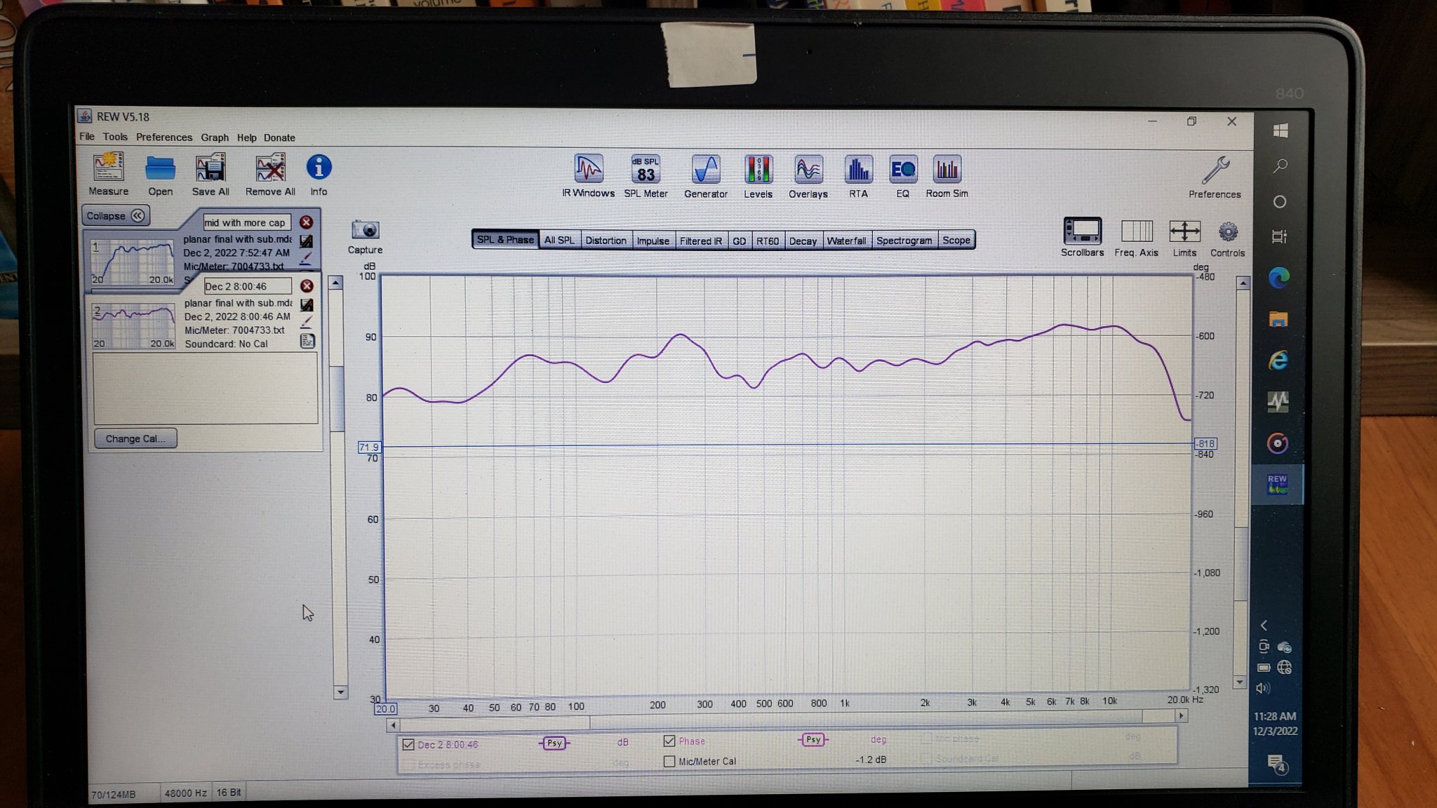

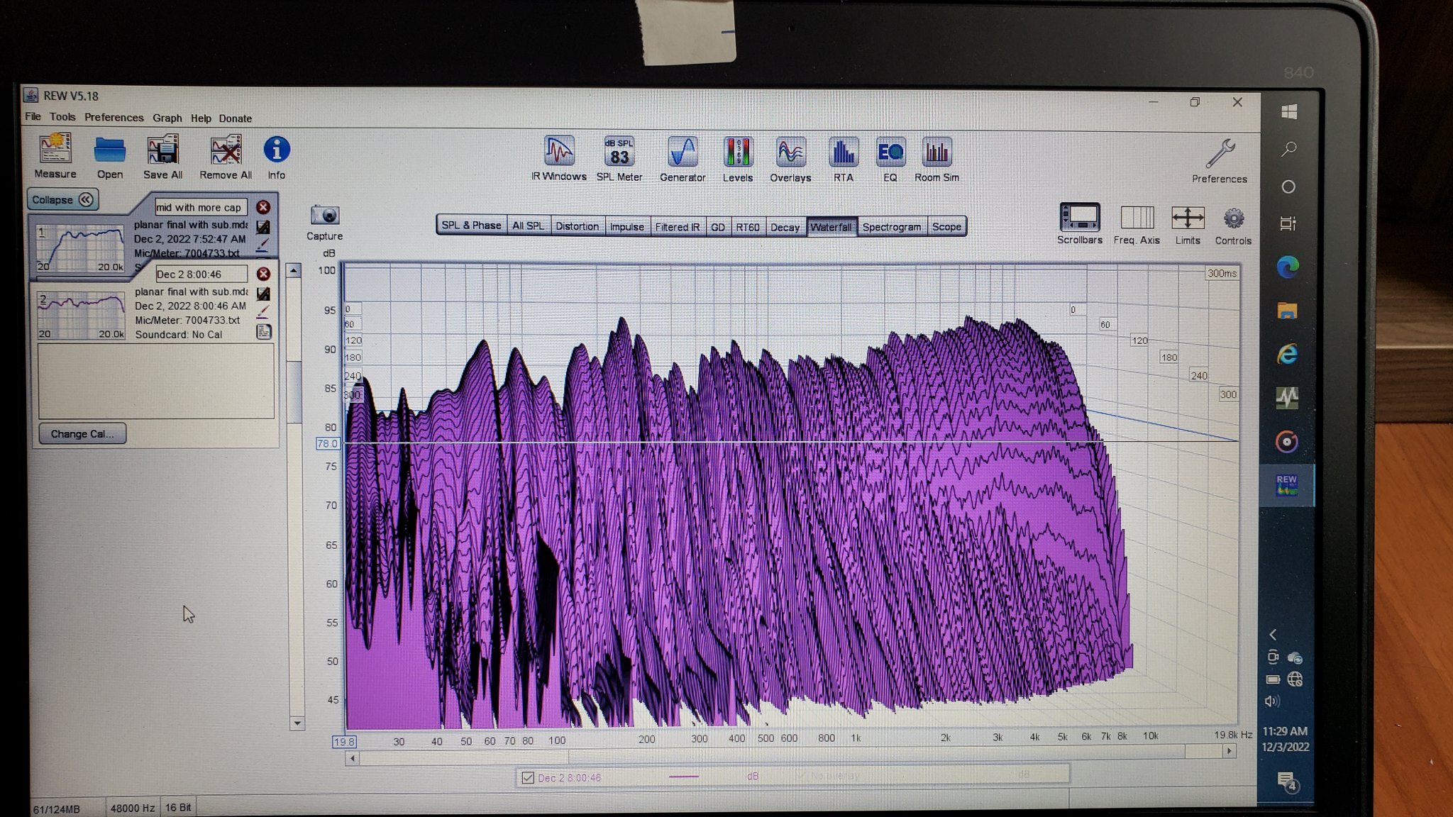

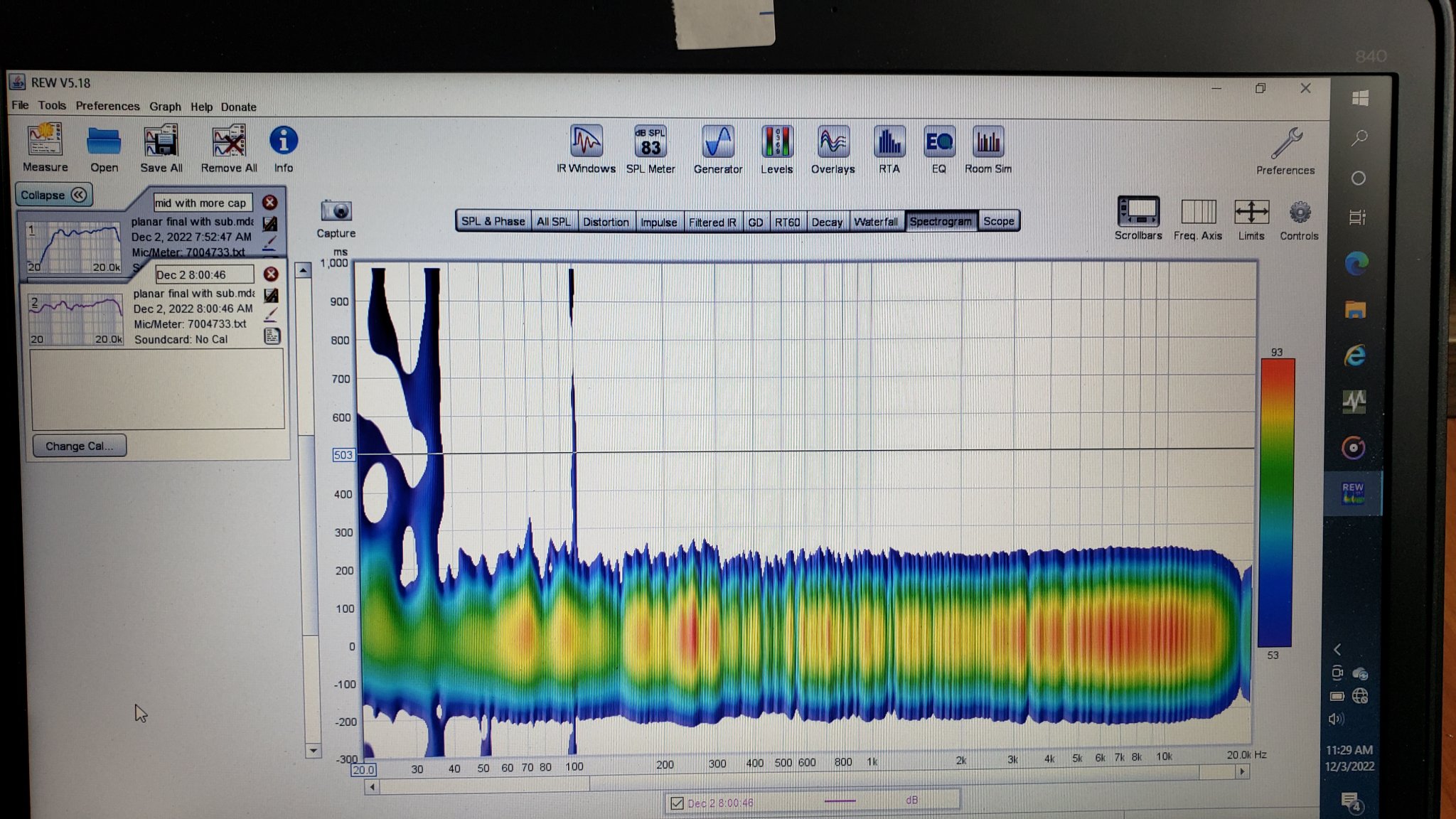

Total system response. Yes, there are room modes. Its a small room and no eq is used. Sounds ok. After some more painting I will test it downstairs in the main system.
