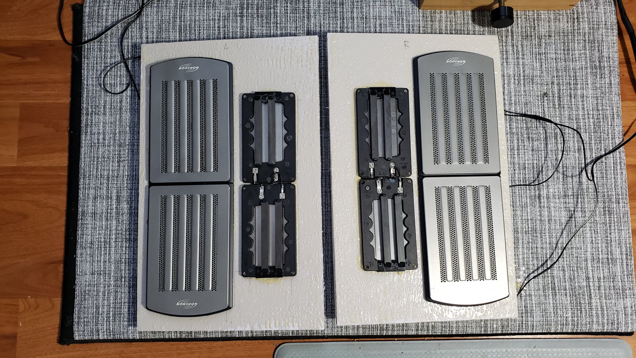

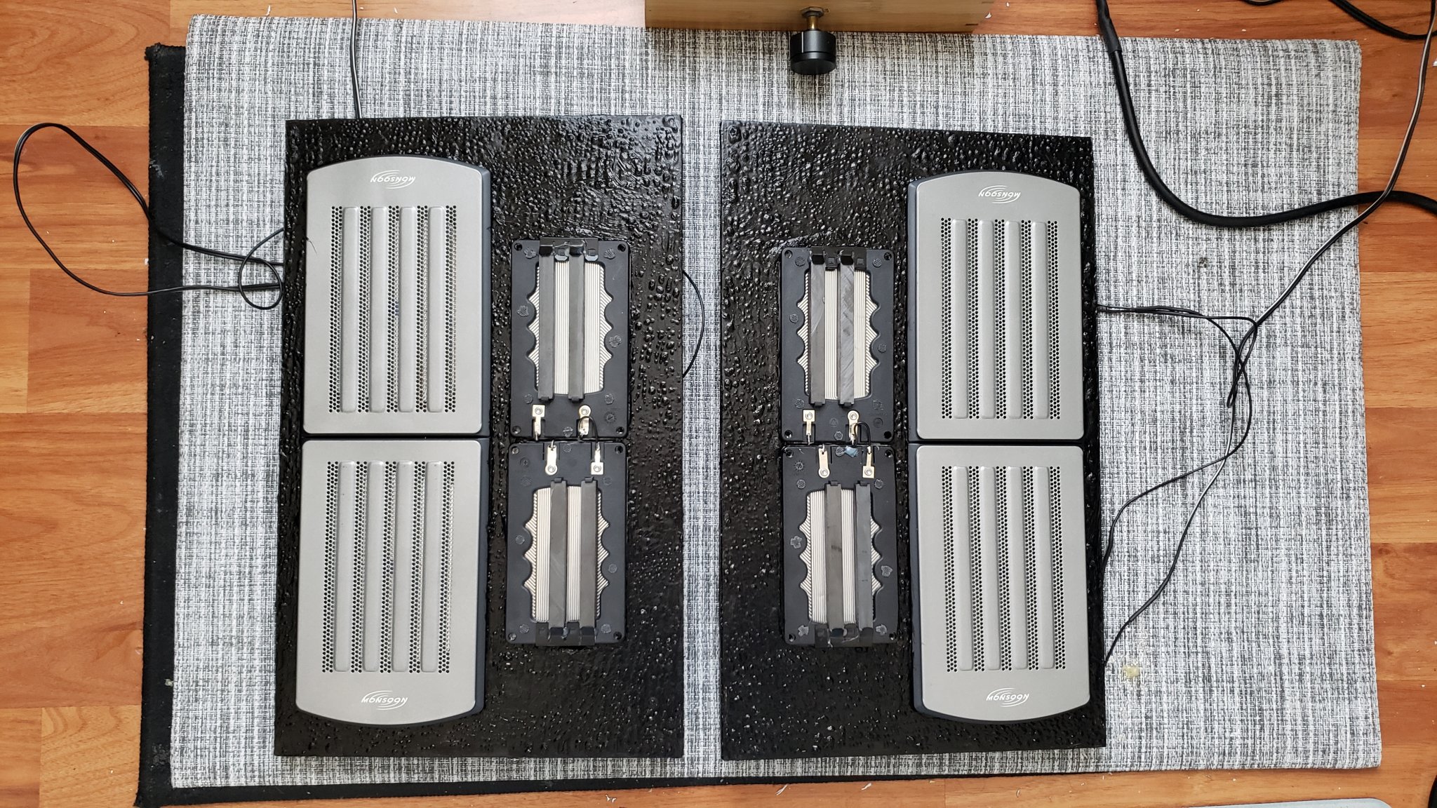

If you decide to do something better with those, remove the monsoon logo, its just glued with hot glue. There is one screw under. This holds entire metal grill. However, they use sticky stuff all around, you need to use some force to remove it.
Then you are facing the drivers, each held in place by four screws.

PM-9 shown in this mock-up. Needs tweeter and woofer....
(PM-9 is held together with screws, not rivets btw.)

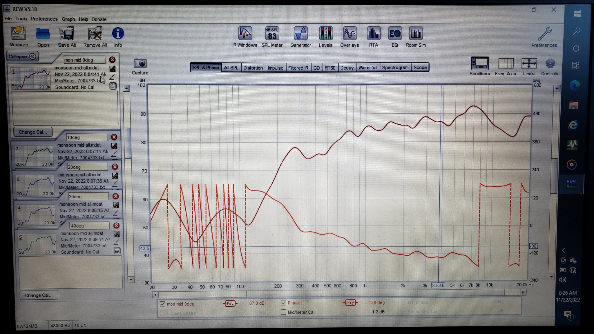

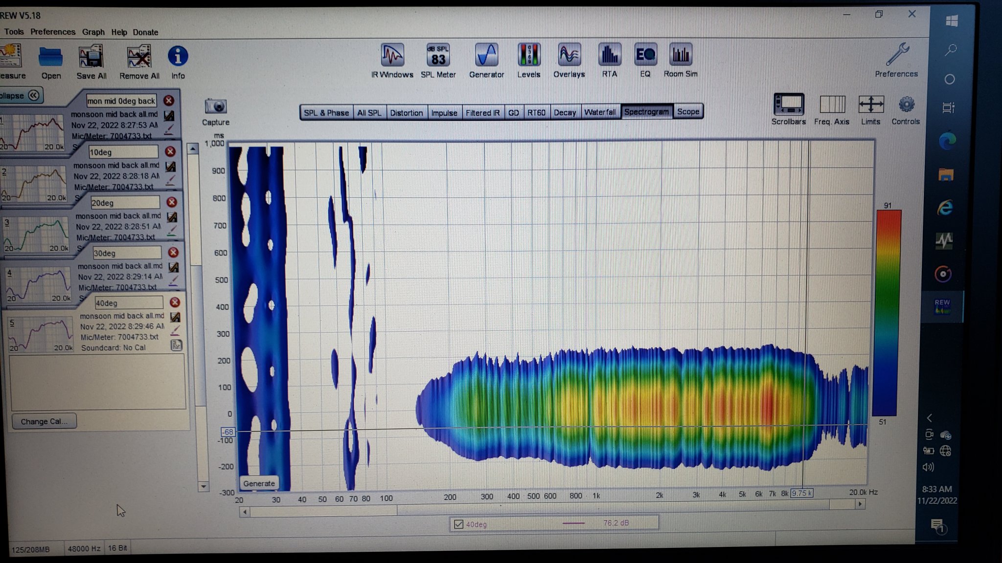

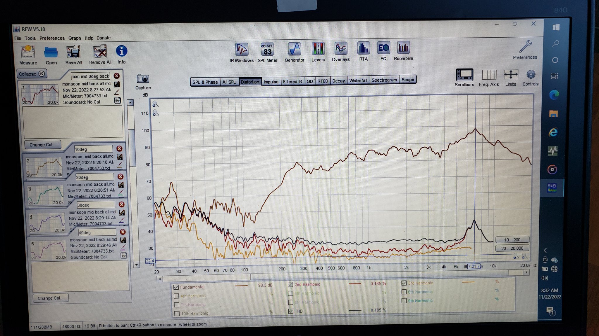

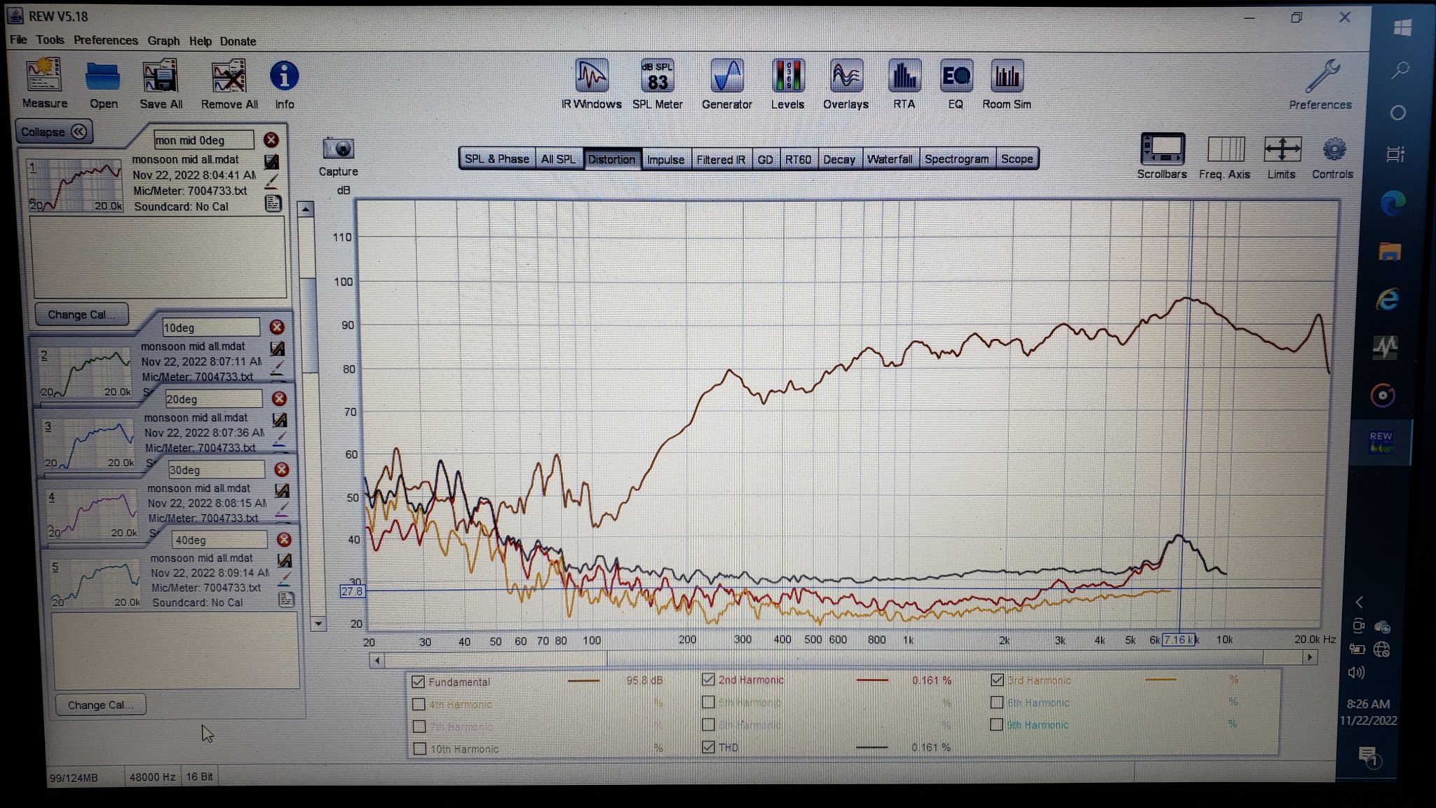

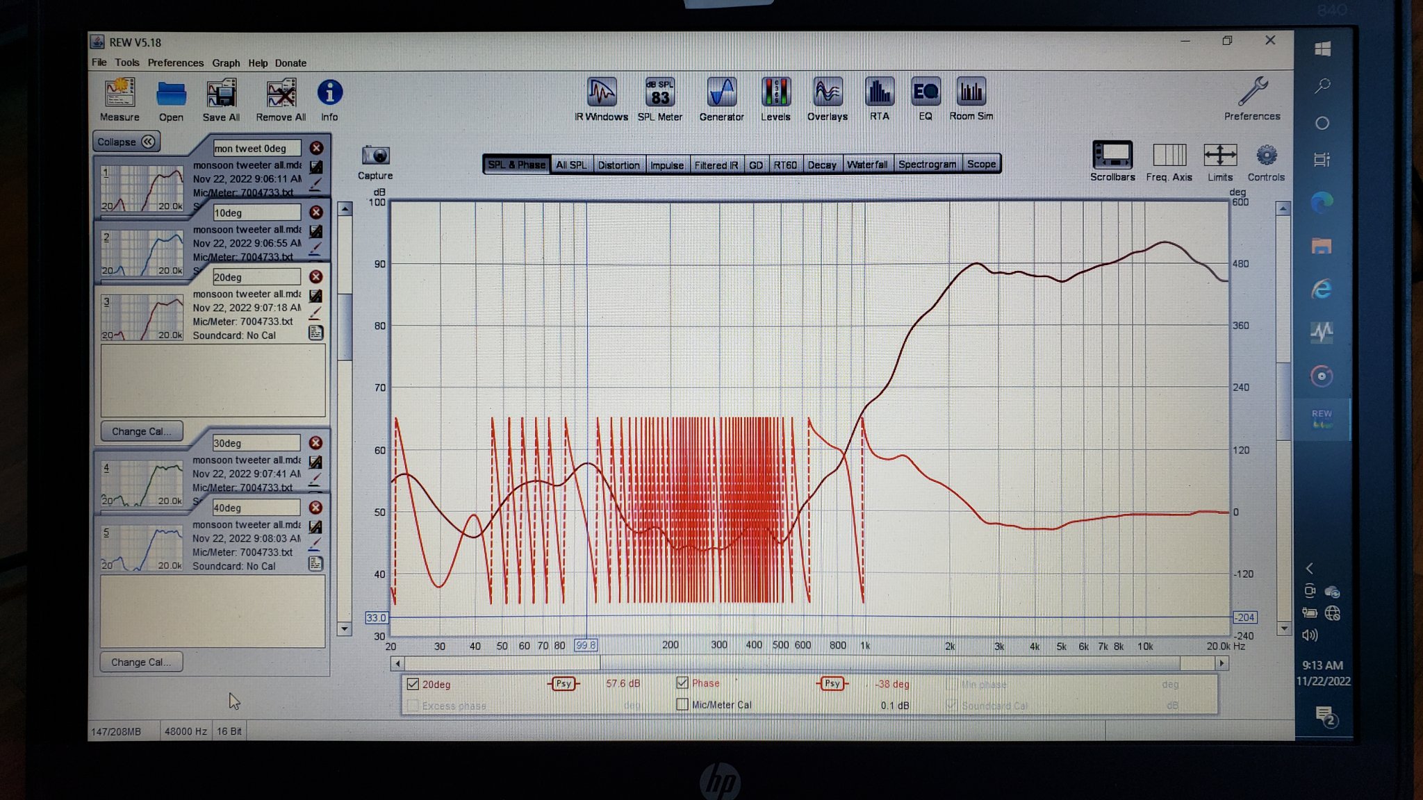

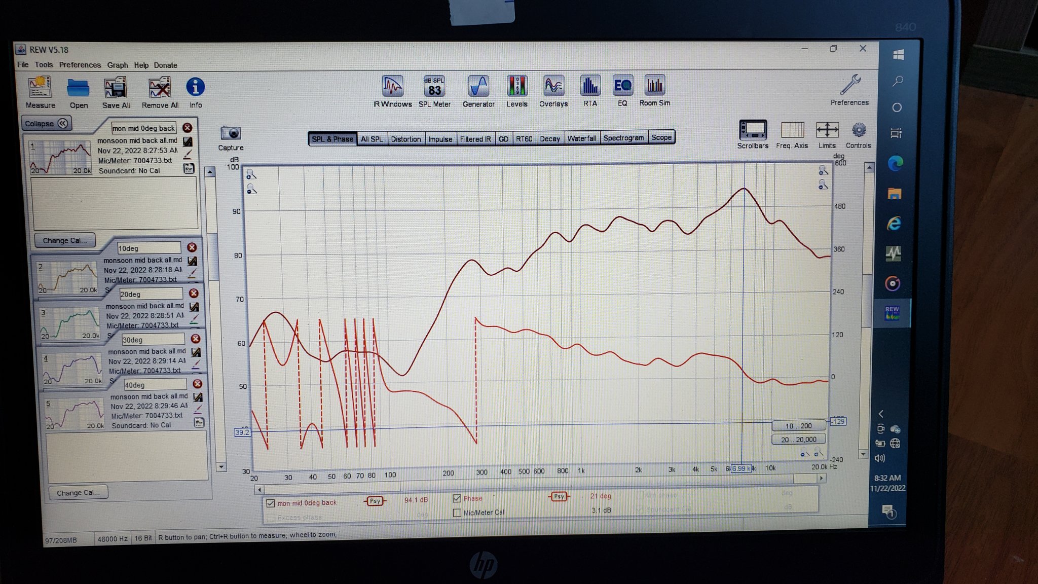

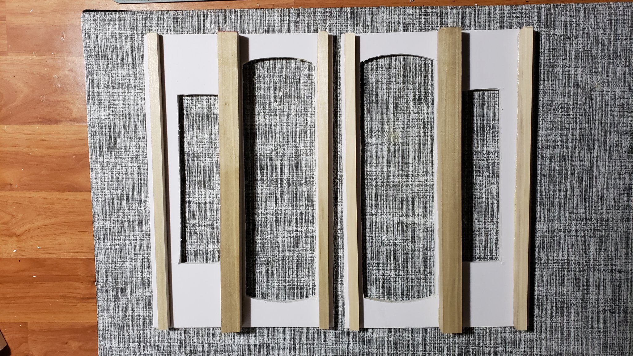

I made this frankenspeaker which has been my desktop mini-monitor for several years - better than my wildest hopes
The base is a radioshack cast alu ported box with a replaced tangband long throw mid-woofer , minor crossover tweaks, the box and planar have great synergy. I did measure this way back but don't have the graphs at hand.
..dB

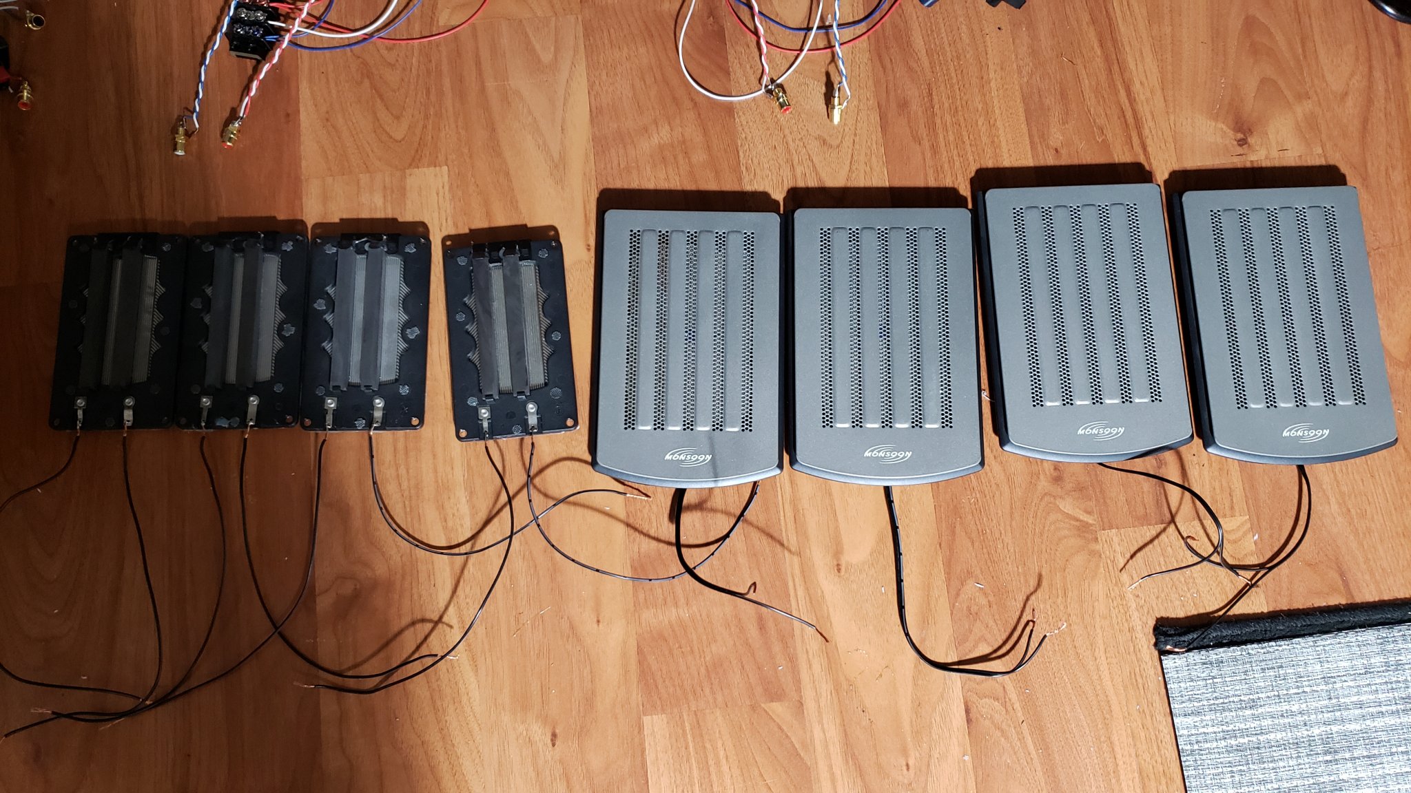

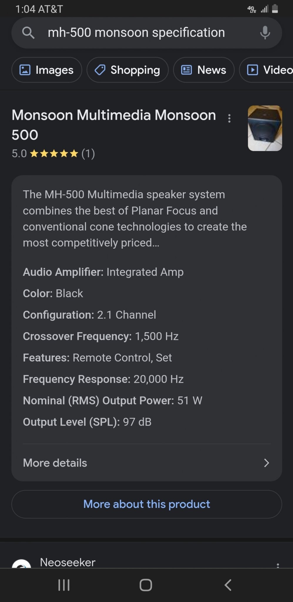

I found a set of MH-505 speakers (MH-500 but configured for 5.1, with 4 sats + 1 center) for sale at a local marketplace, minus the subwoofer/amp, for under $20 in mint condition.
Is it a good deal? Can I turn it into a 2.1 nearfield setup, with new enclosures for the sats (since the OG is ugly as sin)?
