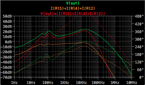

Yes, I have studied the Howland Current Pumps while playing around with the MyRef. It did not seems to satisfy my needs... anyway, I have something that seems to be working better than pure voltage. Below is a simple sim.

I think trying to get a perfect working spice model is not possible. When I asked about the LM3886 spice model, TI recommended I use the LM3876 model.

At a moment I don't have it as it is very hard to make "real" model (not impossible) which will include all parasitics in it and which are highly dependent on practical implementation.
Try basic schematic if you are interested in general overview …
