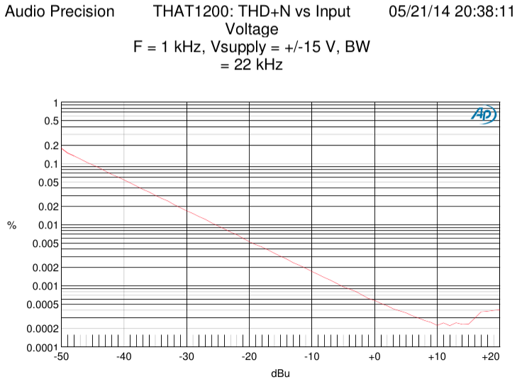

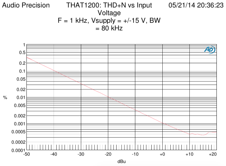

In other news I did look at the THAT1200 specs last night and I have either misread or it is possibly the major contributor to the overall THD performance. Usual caveats of never believe a spec sheet until you have measured it but typical is 0.0005% which is more than the whole mod-86 typical. Am I bovvered? no. I will take the CMRR any day. But for those who fret...
Different measurement bandwidth, 20k - 80k?
It looks like THAT measured at 20 kHz bandwidth, just like I did. My suspicion is that they measured THD+N but wrote THD on the data sheet. I've attached my measurement of the THD+N of the THAT1200. This measurement was performed on the Modulus-86 Rev. 0.11 prototype board (eerily similar to the Rev. 1.0 production board).
However single point measurements are higher drive and into lower impedance makes it very hand wavey for those of us who don't own their own AP stuff.
Yeah... One does have to pay attention to the test conditions and footnotes, though. 1 kHz, 2 kΩ load impedance, 20 kHz bandwidth is a common test point reported in the data sheets. This makes for easy comparison, assuming the amplitudes are the same.
As with any other system consideration, it is important to not get sucked into looking at just one spec. As you pointed to above, the 0.0005 % THD+N of the THAT1200 is likely the limiting factor in the Modulus-86. I chose to accept this in exchange for 90 dB of CMRR, as the high CMRR is much more likely to make a positive impact on the perceived sound quality than the last few µGnatFarts of THD+N.
A good design is all about balancing the many tradeoffs within the design space.
~Tom
