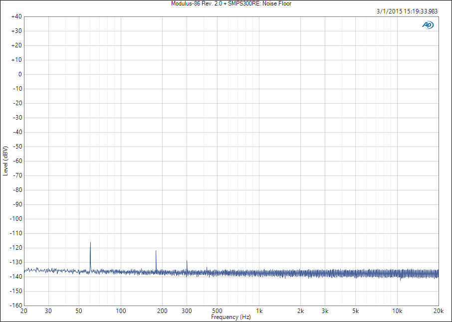

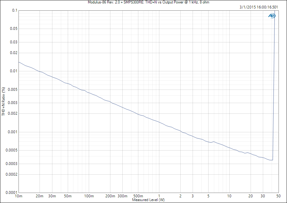

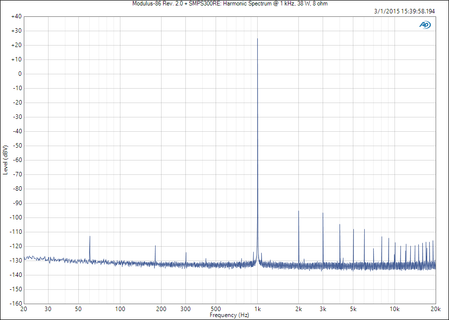

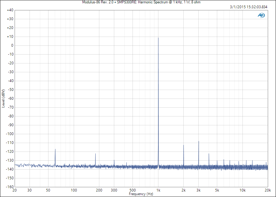

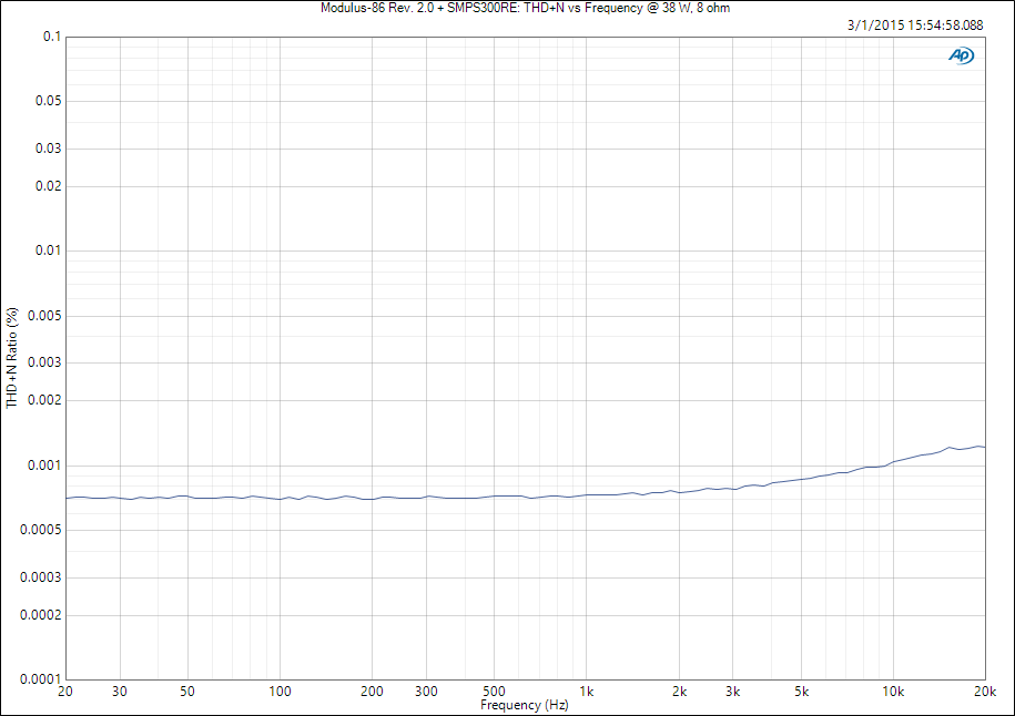

MOD86 R2.0 + SMPS300RE
A while back, I promised to take measurements on the Modulus-86 when powered by a Connex Electronic SMPS300RE. Attached graphs are from the Modulus-86 Rev. 2.0 when powered by the SMPS300RE.
I bought the ±30 V version directly from Connex. The shipping ran about $20 and the supply was delivered within 2-3 weeks as I recall. Not too shabby.
~Tom

Modulus-86 Rev. 2.0 + SMPS300RE_ Harmonic Spectrum @ 1 kHz, 38 W, 8 ohm.png41 KB · Views: 795
Modulus-86 Rev. 2.0 + SMPS300RE_ Harmonic Spectrum @ 1 kHz, 1 W, 8 ohm.png39.2 KB · Views: 802
Modulus-86 Rev. 2.0 + SMPS300RE_ THD+N vs Frequency @ 38 W, 8 ohm.png37.2 KB · Views: 797
Modulus-86 Rev. 2.0 + SMPS300RE_ THD+N vs Frequency @ 1 W, 8 ohm.png36.2 KB · Views: 790
Modulus-86 Rev. 2.0 + SMPS300RE_ THD+N vs Output Power @ 1 kHz, 8 ohm.png42.6 KB · Views: 790

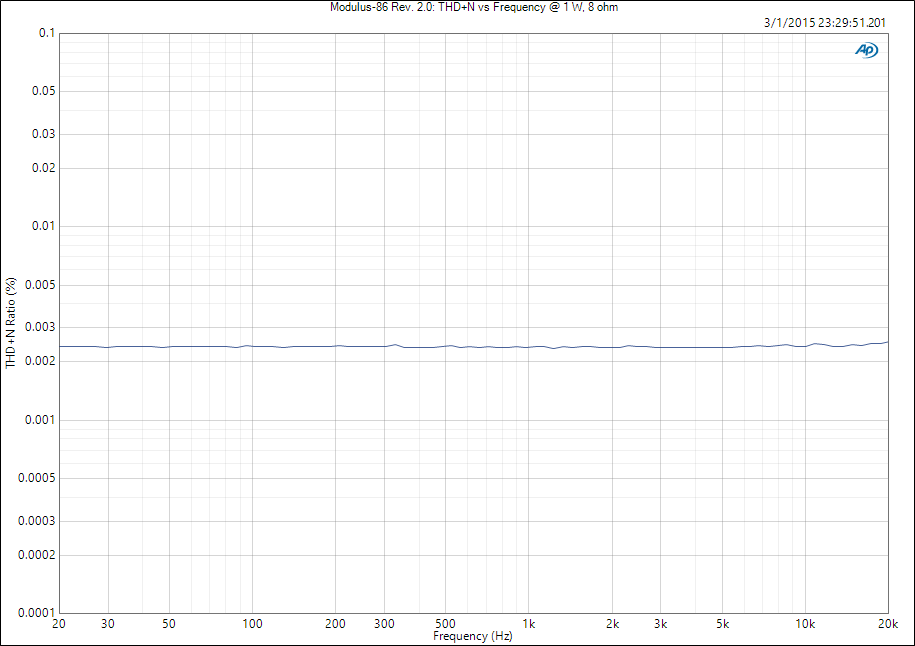

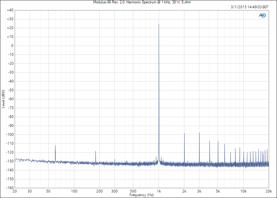

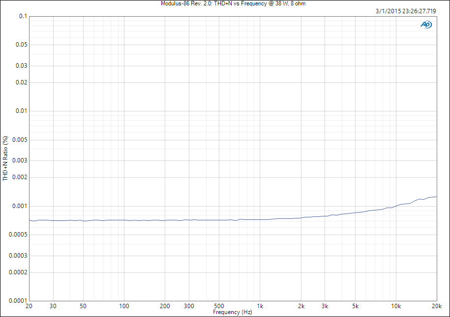

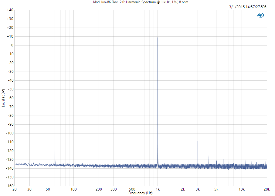

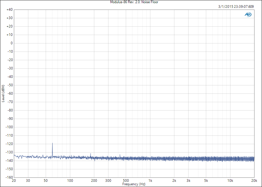

While measuring the MOD86 with the SMPS300RE, I found a way to clean up the measurement setup and eek out the last bit of performance from the APx525. Here are the measurements for the Modulus-86 Rev. 2.0 with an unregulated supply (toroid + bridge rectifier + 2x22000 uF). The THD vs Output Power is the same as I posted earlier. I'm just adding it here for completeness.
~Tom
Modulus-86 Rev. 2.0_ THD+N vs Frequency @ 1 W, 8 ohm.png35.8 KB · Views: 169
Modulus-86 Rev. 2.0_ THD+N vs Frequency @ 38 W, 8 ohm.png36.7 KB · Views: 188
Modulus-86 Rev. 2.0_ Harmonic Spectrum @ 1 kHz, 1 W, 8 ohm.png38.6 KB · Views: 214
Modulus-86 Rev. 2.0_ Harmonic Spectrum @ 1 kHz, 38 W, 8 ohm.png40.7 KB · Views: 249
Modulus-86 Rev. 2.0_ THD+N vs Output Power @ 1 kHz, 8 ohm, 20 kHz BW.png38.5 KB · Views: 172
as always, very good figures showing a job well done.
I have a question:
The 60Hz and harmonics is still showing with the SMPS as the PSU.
Why?
Is the mains interference getting in via a route that is not from the PSU?
Is it an attribute of the "test" cabling/setup?

There is actually a bit of 60 Hz ripple present on the output of the SMPS300RE, in addition to the 90-120 kHz ripple from the switching. The SMPS300RE switches directly off the rectified mains voltage, which may be the reason for this.
I think it was Sy a couple of years ago that found a massive reduction in measured mains interference when changing from single ended testing to balanced connections for all the test gear cables.
Well, yeah... If you have a ground loop that is part of the signal path in your test setup, you will see a dramatic increase in mains-related interference. That's life in precision analog.
The improvement in my test setup came from better grounding to ensure that the AP wasn't floating, and from using the precision ADC rather than the high-bandwidth ADC for the measurements with 20 kHz bandwidth (so the FFT plots and THD vs Power @ 1 kHz).
I suspect the last little bit of 60 Hz hum in my setup is from inductive coupling to the environment. My test setup is the Modulus-86 Rev. 2.0 board mounted on a heat sink sitting on my workbench. I bet the last remaining 60 Hz will disappear once the circuit is in a grounded enclosure. That said, the last little bit of mains hum comes in at -120 dBV, 15 dB above the noise floor of the amp. -120 dBV is 1 µV. Pretty small... 🙂
