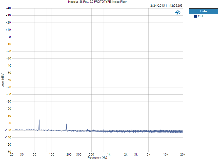

In addition to the new DC servo, there were a couple of tweaks to the PCB layout to reduce the last little bit of mains hum and lower the noise floor. Also, the compensation networks were revisited and optimized to allow for better performance near clipping. This optimization led to an increase in output power from 35 W to 38 W (on ±28 V rails).

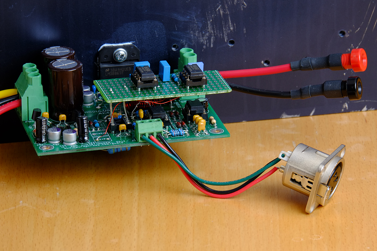

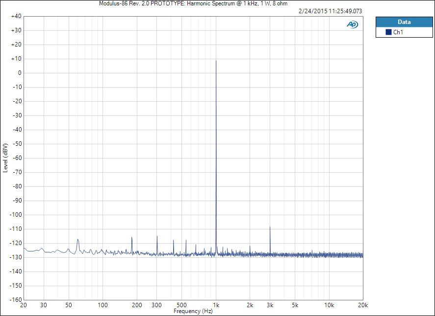

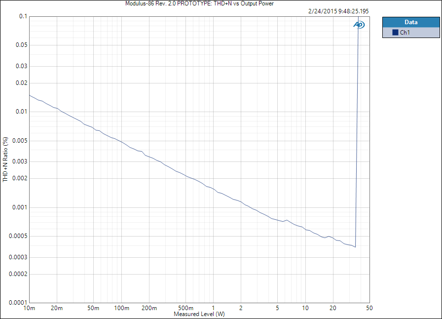

The image shows the prototype for the Modulus-86 Rev. 2.0. All measurement below were performed on this prototype using a ±28 V unregulated power supply (toroid + bridge + 2×22000 uF). The module flying MacGyver style above the main circuit board is the new DC servo.

- Improved performance near clipping, resulting in an increase of approximately 10 % in maximum output power.
- Improved ground layout resulting in a 10 dB reduction in residual mains hum.
- Significantly improved DC servo. The 10 second settling time of the DC servo represents a 25× improvement over Modulus-86 Rev. 1.0.
- 5 dB improvement in noise floor.
- Turn-on transient has been reduced by approximately 2.5× for thump-free power-up.
- Same PCB size and mounting hole locations as Modulus-86 Rev. 1.0 for easy upgrades of existing Modulus-86 amplifiers.

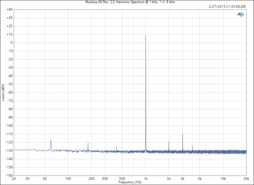

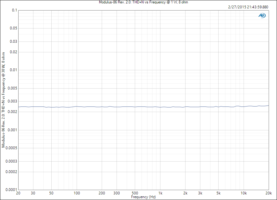

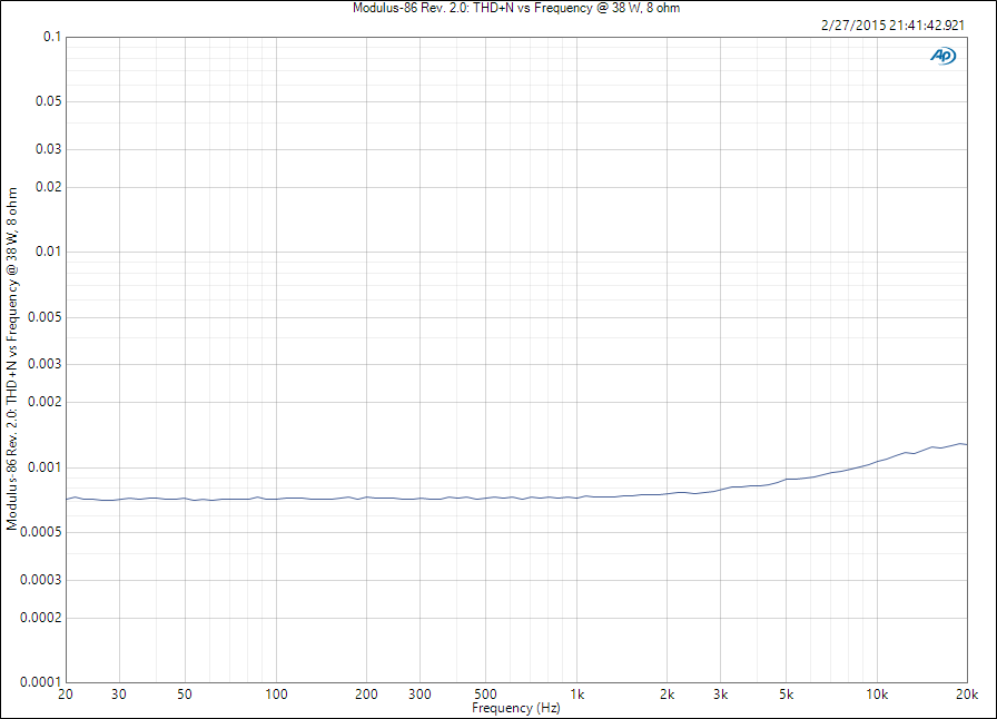

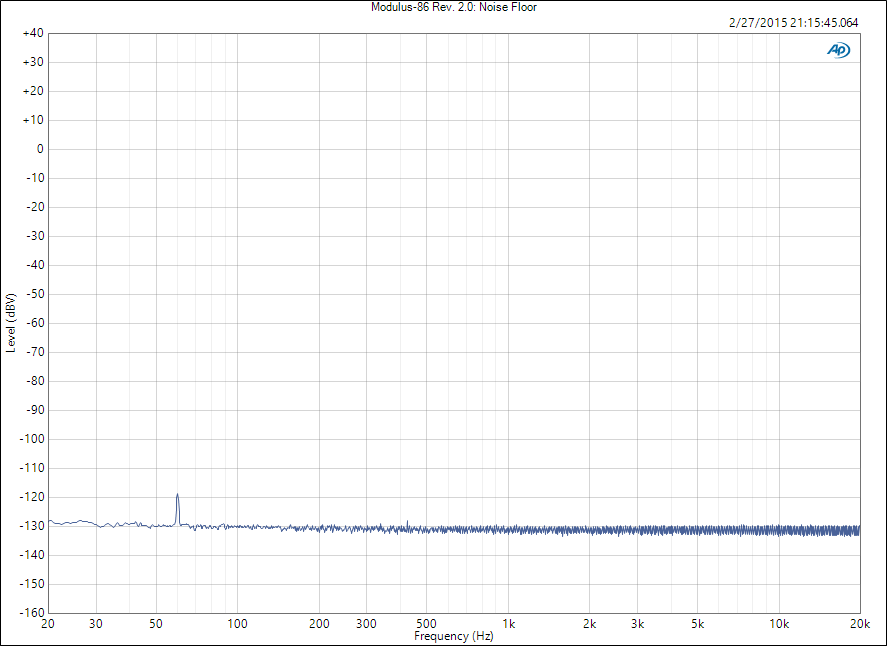

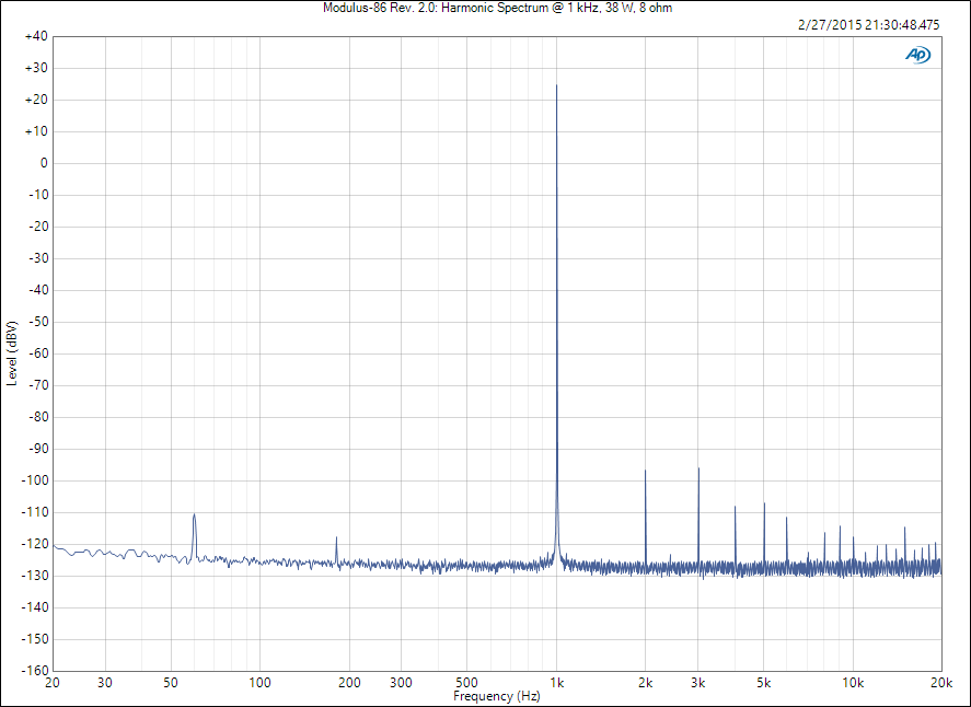

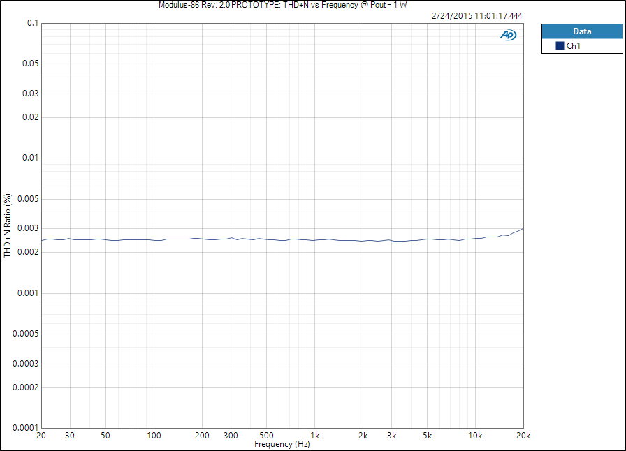

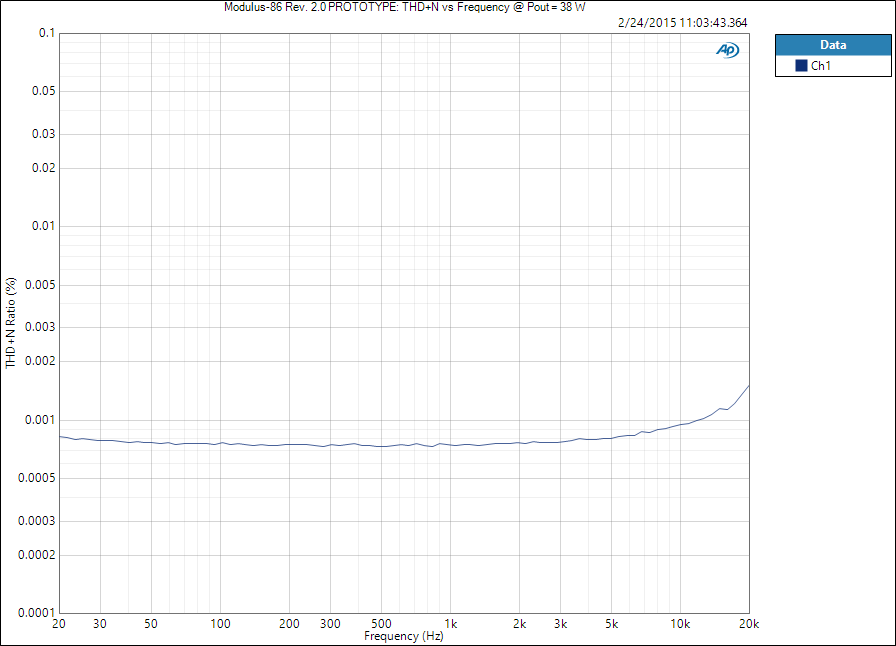

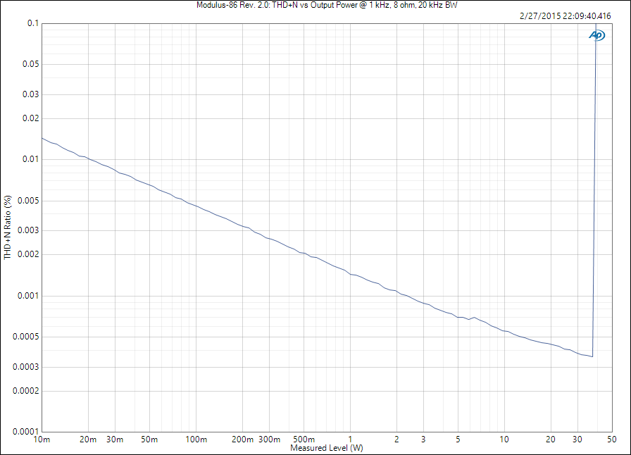

Boards are in!
The Modulus-86 Rev. 2.0 boards have arrived. I've assembled and tested one of them. See the results below.
The measurements were taken with an unregulated power supply consisting of a toroidal transformer, diode bridge, and 2x22000 uF of reservoir capacitance. The supply voltage was adjusted using a variac to provide ±28 V at the full output power (not including ripple voltage).
The boards will ship tomorrow to those who preordered. Thank you for your business!

Modulus-86 Rev. 2.0_ Harmonic Spectrum @ 1 kHz, 1 W, 8 ohm.png47.8 KB · Views: 294
Modulus-86 Rev. 2.0_ Harmonic Spectrum @ 1 kHz, 38 W, 8 ohm.png48.9 KB · Views: 291
Modulus-86 Rev. 2.0_ THD+N vs Output Power @ 1 kHz, 8 ohm, 20 kHz BW.png38.5 KB · Views: 772
Modulus-86 Rev. 2.0_ THD+N vs Frequency @ 38 W, 8 ohm.png26.9 KB · Views: 856
