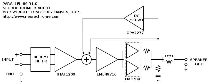

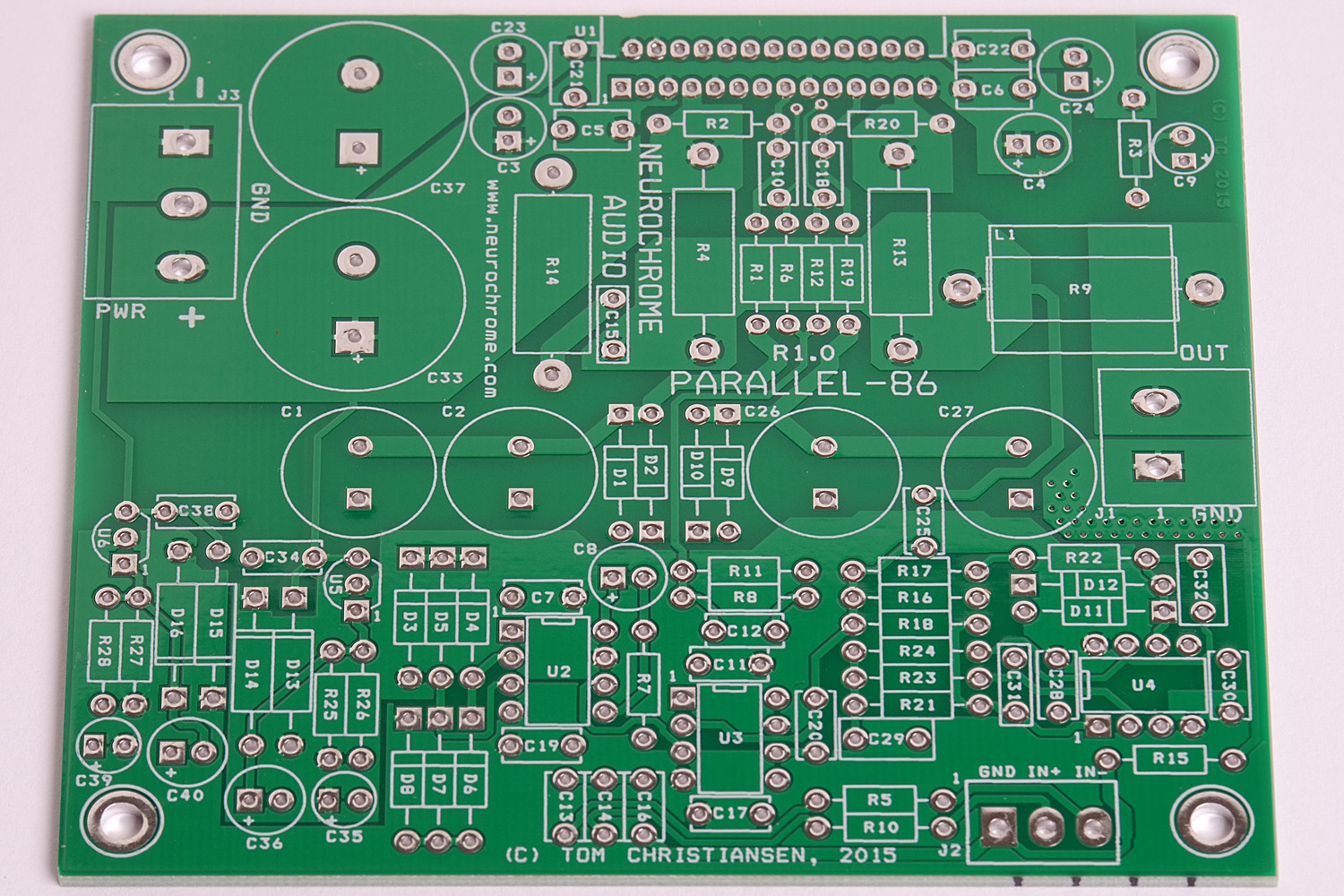

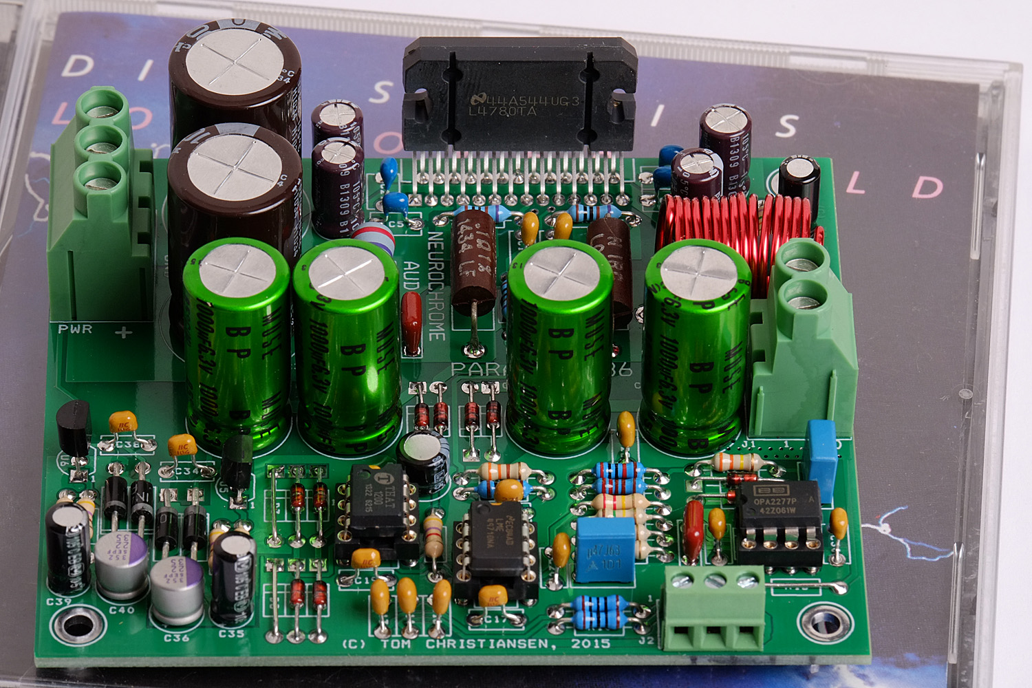

Submitted the Parallel-86 board to the fab today. I should have boards in early April.
The initial batch will only be 12 boards. I will build up at least one for my characterization and measurements. All the simulations look good and my early prototype indicates that the circuit should work well. I'd still like to see the actual circuit before committing to specs. In particular as the layout is such a big part of the high performance level I'm getting with this composite amplifier topology.
I conservatively estimate that the Parallel-86 should be capable of delivering about 60 W into 8 Ω and 120 W into 4 Ω. With two boards bridged, output powers exceeding 300 W should be possible, assuming sufficient heat sinking.
I decided to use the LM4780 rather than two LM3886es in parallel as this provides a much cleaner layout. I am also seeing much tighter matching between channels of an LM4780 than you can hope for with two LM3886es. This helps tremendously in ensuring proper load balancing between the two amp halves. I've attached the block diagram for the Parallel-86.
I have opened up for pre-orders on my website: Parallel-86
~Tom

Math says: 359 W into 4 Ω, 285 W into 8 Ω for ±35 V, bridged. Reality will probably be a tad lower.
Input Sensitivity 2.20 V RMS 60 W, 8 Ω
Then with 2 V RMS (DAC output standard) the power will less.
Correct. There are various ways to solve this:
1) Use a DAC with higher output voltage. My Focusrite Saffire PRO 24 has no trouble delivering over 4 V RMS.
2) Use a preamp with gain. A THAT1646 would be just about perfect for this as it has a gain of 6 dB. One could also configure an LME49724 to provide a bit of gain.
3) Increase the gain of the PAR86 as described in the design doc.
Those who's followed my posts for some time will recognize that I'm a big proponent of good gain structure. 99.999 % of the time, the power amp will operate below a few watt, even when playing relatively loud. No additional gain is needed for these use cases. For the 0.001 % of the use cases that need extra power, I strongly suggest putting the gain where it belongs; in the preamp...
~Tom
I guess input sensitivity 2.2V RMS is via RCA and therefore 4.4 V RMS via XLR.
No. The gain of the THAT1200 is 0 dB (= 1x). If you apply 2.2 V RMS differential, you'll drive the PAR86 to clipping. If you drive it with 2.2 V RMS single ended, you'll drive it to clipping as well.
Suppose we had, exaggerating, 3 V RMS at the RCA, what problems would result if the DAC had no potentiometer to reduce it?
That would cause the amp to clip pretty hard. Just like any other amp does when you overdrive the input.
~Tom
