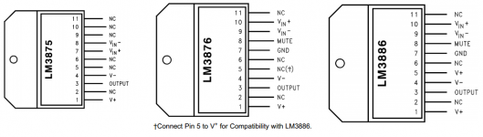

I recall somebody asking a while back if the Modulus-86 board could be used with an LM3876. According to the data sheet, it should work just fine, but it's always nice to try it out in the lab.
I'm pleased to report that the LM3876 can be used in the Modulus-86 board. I've taken a couple of spot measurements and checked the stability. It performs well. The THD is the same low 1.8 ppm as with the LM3886 (@ 1 kHz).
The LM3876 offers better SNR but also lower output current drive compared to the LM3886.
~Tom
LM3875 can be used too? Without pin 5, of course.
Comparing the pinouts in the data sheets, it quickly becomes rather obvious that the LM3875 and LM3876/LM3886 are NOT pin compatible.
The LM3876 and LM3886 are pin compatible, provided that Pin 5 is connected to VCC on the PCB.
~Tom
