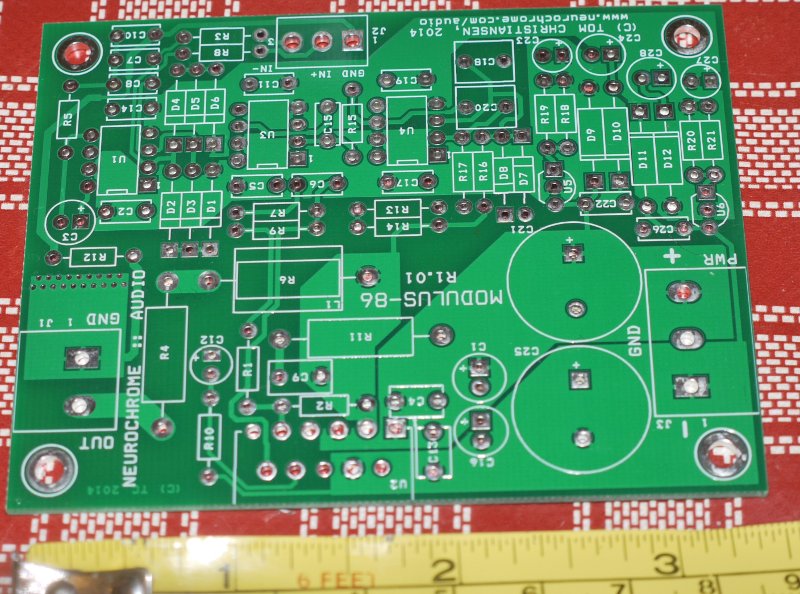

http://www.diyaudio.com/forums/atta...d1421026360-modulus-86-build-thread-board.jpg
On this pic you can see some of the detail in routing pairs of traces together.
Neat !
Neat !
