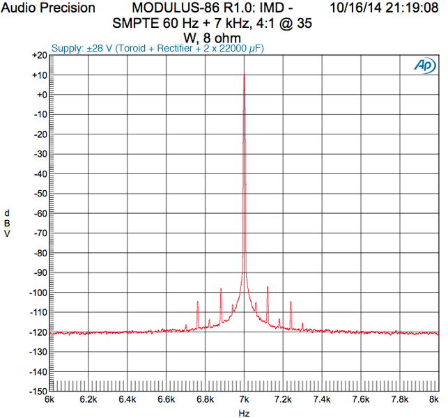

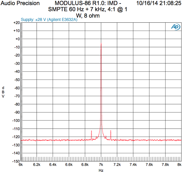

On a serious note, I suspect the MOD86 will go "meh!" and continue on with life. At least if the intermodulation measurement I took a while back is any indicator. See Post #213. Two of the plots reproduced below.
~Tom
