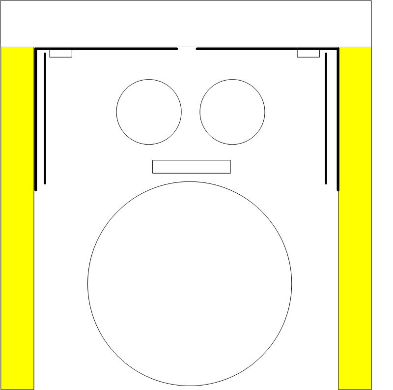

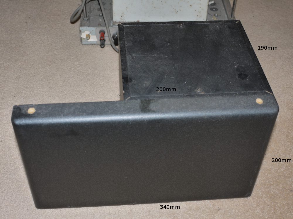

I'm risking going way OT on this, so @Tom: stop me if I am dragging things the wrong way, but figured some discussion on packaging options might be interesting. After all the mod-86 is small enough and can be made low power enough for some neat installations.
So as I am making my speakers active, as well as converting them to open baffle operation, seems churlish not to try and pack the amps in whilst I do it. Plus it means the box is hidden, and nice metalwork was never my strongpoint 🙂
So I have the stands (first picture), or the bottom of the enclosure (most of which will be cut out to make it OB). Nothing is allowed to stick out at the sides and sadly I can't replace the 350mm wide front of the stands as heatsink (sob).
options for 2 heatsinks are limited so looking at a single of around 0.5C/W (200x150x40mm profile). If I could mount the Mod-86 parallel to the heatsink then all hunky dory, but with 190mm depth would have to put the boards vertically with the PSU caps in between.
Just working up a drawing to make sure I've taken everything into account, then I can work out how to build the metalwork.

Well it's a tight fit even without I/O, and one board will be upside down, but I think I can do it. Dropping the transformer to 120VA gains 20mm if I start to struggle. Would appreciate any thoughts on how it could be made more compact (other than reducing power).

well I have not assumed a power supply board, so I just marked the size of the caps for a stock M86 and a small box for the (as yet undefined bridge). The GBU2510 Tom looks like he is using in the power86 is in a small case, so I would heatsink, or bolt to the baseplate. I wouldn't want to drop below 22000u per rail and they are only 35mm diameter, so fine. I am still doing the vertical layout, as the mod-86 boards should start above the height of the caps.
there is always the vertical mounting of the transformer to consider as well.
That would be my choice for mounting as well. For the Power-86, I didn't want to paint the customer into a corner by requiring that the board be mounted near a chassis edge or otherwise within reach of an existing heat sink surface. Also, by specifying the heat sink, I have a better control over the thermal system and can ensure that the rectifier will survive even if the customer connects more than two channels to a supply board and runs the channels at the published headline power specs. Math. Useful. 🙂
