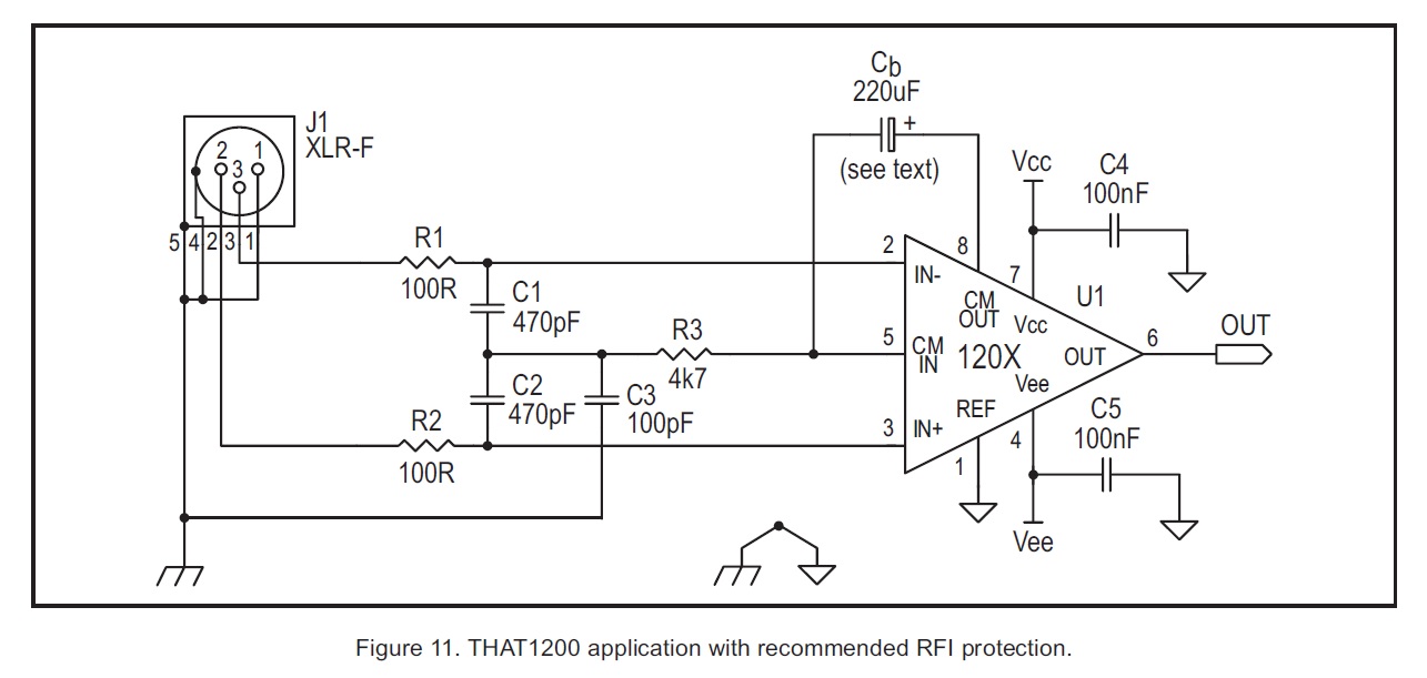

Anyway, just sayin' that for audio you actually need some actual lowpass filters ("lowpass" as the RF guys mean it, ie, passive with suitable parts which still works at GHz, not active opamp filter)...
The Mod86 uses something like the THAT1200 EMI passives as indicated in the datasheet:
"Figure 11 shows a more elaborate and robust circuit for RFI protection.
While more complex, it offers many improvements over the circuit of Figure 10 that make it worth serious consideration. First, C1 and C2 are larger than their counterparts in Figure 10. Because they are in series with each other, they act as a 235 pf capacitor across pins 2 and 3 of the XLR. This allows them to be effective at lower frequencies.
Second, because their center point ties to chassis ground through a smaller, common capacitor (C3, 100 pf), any mismatch in their values has less tendency to unbalance common-mode signals compared to the circuit of figure 104. Third, because they are driven from the common-mode bootstrap circuit through R3, this common point gains the benefit of the InGenius common-mode bootstrapping.
Finally, R1 and R2 provide some additional buildout impedance against which the bypass capacitors can work, making the entire network more effective against strong RF signals."
www.thatcorp.com/datashts/THAT_1200-Series_Datasheet.pdf

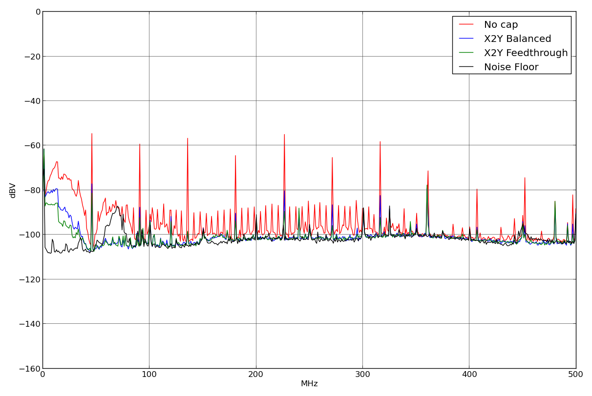

Could you explain
X2Y Balanced, X2Y Feedthrough?
It is a X2Y C0G capacitor specced at 1nF. These contain two 1nF caps actually, which are well matched. It has 2 GND electrodes (G1 G2, internally shorted) and each capacitor has its own pin (A,B). So if you want to filter a balanced signal you can place it like this :
GSM RFI Suppression with X2Y® EMI Filters
This is the "balanced" label in the plot I posted. It has excellent CMRR because of the good matching between the two internal caps.
The "feedthrough" mode uses one X2Y component with both internal caps in parallel, across the signal line. You use this mode for decoupling also.
Note the measurement is single-ended.
Anyway. In feedthrough/decoupling mode, when properly mounted this thing has low ESL, about 100-150 pH, due to the internal structure which cancels magnetic flux (it is pretty clever). So it makes a pretty good decoupling cap, or filter, if you got one line to filter only. It is about 10x better than properly mounted MLCC capacitors (which themselves are, by the way, about 10x better than the traditional red WIMA plastic inductors which have some capacitive properties at low frequencies)...
In balanced mode, with two signal lines, it is a bit different... For common mode noise it behaves just like the decoupling mode above, that means it is extremely good, with its very low ESL. For differential noise it behaves like a normal capacitor, because the internal flux-canceling structure no longer works (it depends on the current in the two internal caps flowing in opposite directions).
As far as sticking ceramic caps in the audio path, well, it is C0G. Anyone who can manage to measure some THD on this thing needs to clean solder flux better and measure again.
Careful with that. The 2Y matching of 2-3% is tighter than X2Y caps' 20% rating but in no X2Y datasheet I've looked at has it been a specified parameter, meaning it's not guaranteed. It's also not anything special. At least with the distributors I use two 1% C0Gs cost less than one X2Y. So, unless board space is really limited, one might as well go with the 40dB CMRR typ 1% caps offer. Compared to the 85 to 100dB that's routine for difference amplifiers 40dB is pretty poor. It means the cap mismatch will start to degrade CMRR two or three decades below the filter's corner frequency. So if one corners an EMI filter at a few hundred kHz one has to pay attention to avoid CMRR degradation around 1kHz.
THAT's EMI network is pretty elegant about mitigating this by kind of floating the 2Y so it behaves more like an X and taking advantage of the bootstrap servo. Johansen's marketing doesn't document their test configuration well but it wouldn't surprise me if the 10x improvement claimed is relative to 20% MLCCs. If so, it's both specious with regards to component tolerances (I often see 5% MLCCs coming up cheapest in the parts selector) and wanting some care when being applied to audio circuits where some flexibility exists as to how the connection to "ground" is made.
THAT1200 Figure 11 is what you want for EMI protection. You can then expand further and include ESD protection as well, as I did on the MOD86.
~Tom
