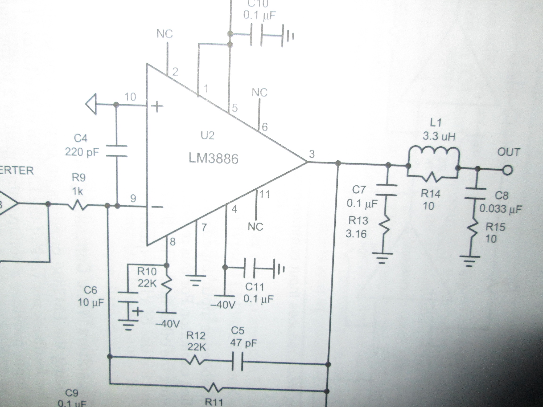

And you can get fancy and add an extra output zobel at the speaker cable entrance:
like Cordell does to his chipamp in his Amp book (pg 540, Fig 27.3 The Super Gain Clone Employing a DC Servo)
On pg 541, he writes:
"Output Network
The output network is a pi-section arrangement with Zobel networks on both sides of the L-R network. This provides enhanced resistance to RFI ingress via the speaker cables. The inductor is optionally constructed as an air-core toroid to keep the magnetic field circulating largely inside the toroid, reducing possible magnetic coupling to other circuits. The first Zobel, comprising C and R, is located close to the output of the LM3886. The L-R network and second Zobel are located close to the speaker output terminals, optionally on a small separate board. The output signal is carried from the main board to the output network board by about 6 in. of high-quality speaker cable."
Jeff
