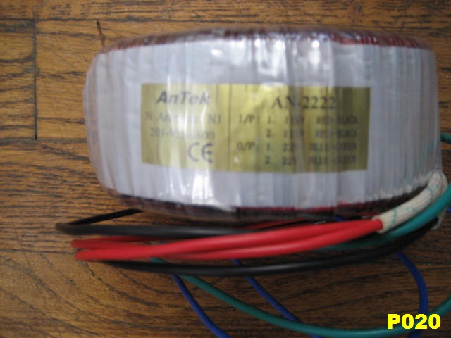

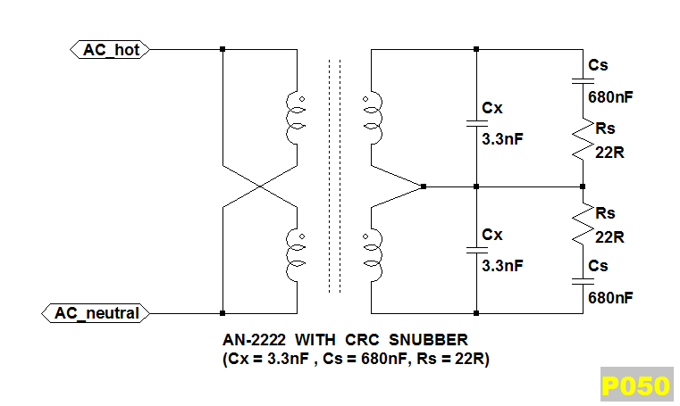

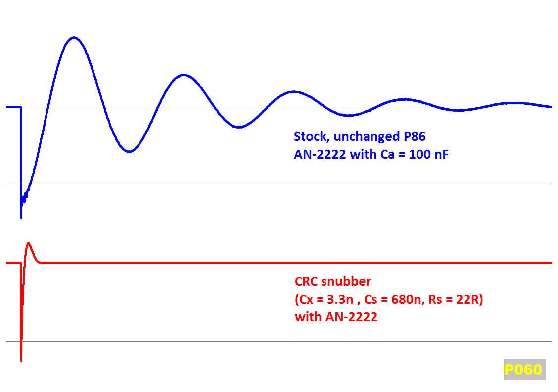

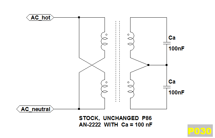

If anyone's interested in attaching a 3-element snubber to the secondary of their AN-2222 power transformer, I have some news. I connected an AN-2222 to the 3-element "Universal Modulus Toroid Snubber" described in post #408 , and got a well-damped, non-oscillatory waveform on the secondary. It's the red waveform.

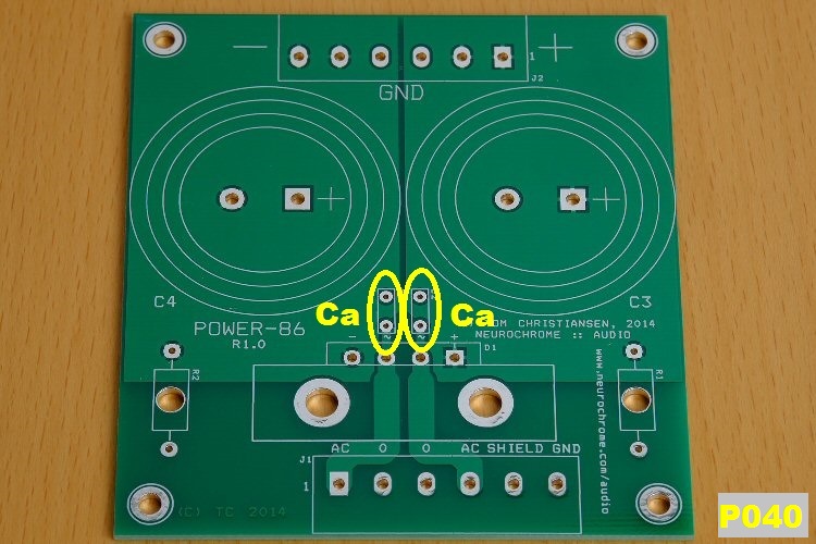

Tomchr has designed a 1-capacitor, zero-resistor snubber into his Power86 power supply PCBoard; I tested that snubber too. As Tom mentions in post #406, the transformer secondary rings at an ultrasonic frequency with this configuration, and my testing agrees. It's the blue waveform.
If you prefer the blue waveform, the stock unmodified Power86 board provides it. If you prefer the red waveform, you'll need to add the Cs and Rs components. Total cost is about $2.50 for the additional parts, plus shipping.
