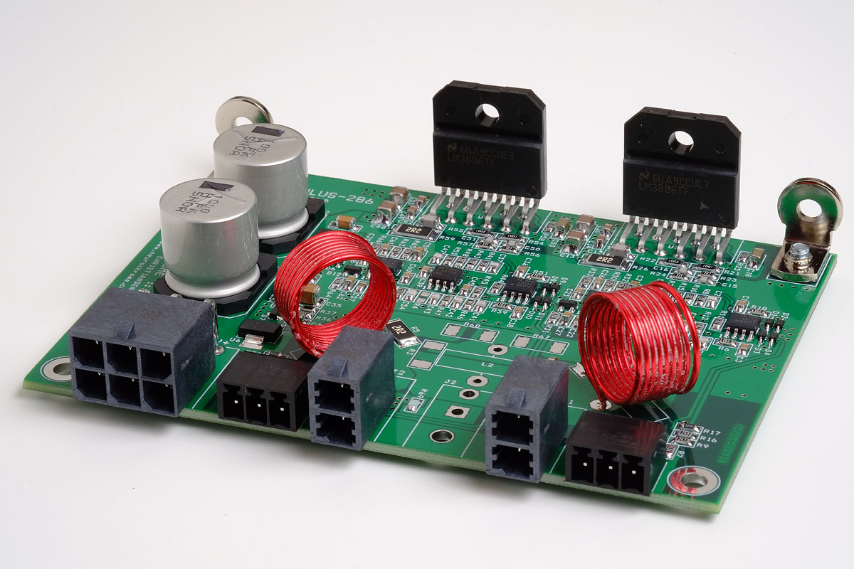

I'm working on the Modulus-286. It is an all-SMD build on a 4-layer board of two channels of Modulus-86. I have a prototype running and it performs very well. It has lower noise than the Modulus-86 and has a default gain of 26 dB (20x) and an input sensitivity of 900 mV RMS. The channel separation measures about 90 dB, which is quite good, but I may be able to improve that further.
There will be resistor options to allow the two channels to be coupled in parallel for higher output power.
In stereo mode (±30 V supply), this amp provides 40 W into 8 Ω and 60-65 W into 4 Ω.
In parallel mode (±35 V supply), the amp provides approx. 60 W into 8 Ω and about 115 W into 4 Ω.
I'll start out the boards at $150/each for the final version. I expect to have the final version available in late September. The BOM cost is $90ish.
For those looking to become early adopters and would like to save $50/board in exchange for having to live with a few limitations have a new option: I have 11 of the prototype boards (Rev. 1.0) and will need 3-4 of them for my own use. I'm willing to part with the rest for $100/each. They will work well for stereo builds and operation up to ±35 V (absolute maximum) but will not support parallel operation. In addition, you need to stack two ceramic caps in four places. The final board will have these kinks ironed out, allow parallel operation, and up to ±42 V supply voltage (absolute maximum, ±35 V is the recommended design target).
Early adopters interested in these boards, please toss me an email through the Contact Us page on my website or PM me.
Attached image shows the Modulus-286 Rev. 1.0 prototype in stereo configuration.

1. What are the physical X*Y dimensions of the mono Mod-86 and the projected stereo Mod-286 PCB's?

The MOD86 board measures 3.550 x 2.725 inches. You need to allow some space for the wiring to get into the terminal blocks, so I'd keep at least 1" of clearance around the board.
The MOD286 board measures 4.450 x 3.150 inches. That is the size of the prototype board and I fully expect the final board to be the same size. All connections are made along one edge of the board. You'll need probably 1.5 inches of clearance there.
Right now I perform the assembly and test by hand, which drives up cost. I haven't figured out the pricing on assembled MOD286 yet, but I figure around $400-450. The board takes a couple of hours to build and test. Once I develop a relationship with an assembly house, I expect that cost to go down.

Hello Tom,
How much lower will the noise floor be?
I ask the question because the residual noise of the MOD86 is what has been holding me back from trying it on my compression driver (nc400 has a 25uV unweighted spec, which is already audible on my compression drivers with input shorted).
Regarding gain, will it be easy to adjust to a lower value? How much will it reduce residual noise (internal noise, input shorted)?

Don't be afraid of noise in the MOD-86. I just connected mine to my 100dB/W/M Unity horns and it is dead quiet, I mean head inside the horn - no sound - dead quiet. My system has never been this quiet before, despite running very high quality amplifiers and an optimised gain structure.
Make sure your gain structure is good, this can increase your noise floor by >20dB if you get it wrong. I drive mine from a DCX2496 and built my MOD-86 with 14dB (X5) gain - details given in the design docn.
You won't regret this build.

He has stated he already hears noise from a specified 25uVac with his set up.
The mod 86 is about 4dB to 5.5dB noisier.
He recognises that gain affects noise output.
+20dB and +26dB gain values of chipamps may be too much for a high sensitivity horn.
30W to 50W of maximum output power may be too much for a high sensitivity horn.

have a look at the lme49600 datasheet.
there are a few headphone amplifiers that use that topology.
The gain could be set to +0db or +3dB or even +6dB to drive a horn.
The max output of the 49600 is 250mApk and that equates to 250mW into 8ohms.
The datasheet shows the opamp+buffer. What about replacing the 49600 with a diamond driver + ClassA biased EF output. There are probably Threads with this topology.
Potentially you are in the 0.3ppm distortion and noise is ultra low using a modern low noise low distortion opamp like the lme49990.
