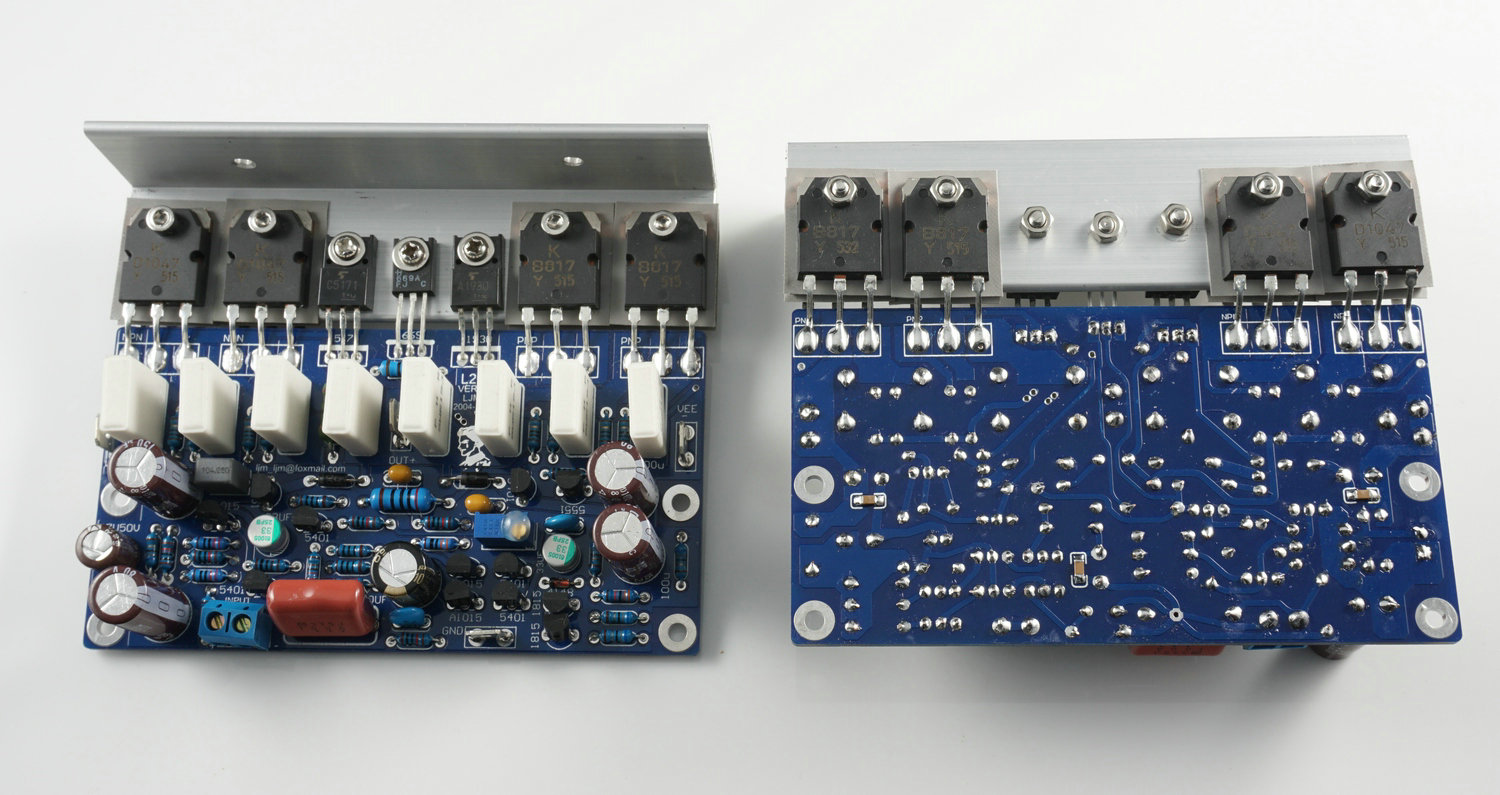

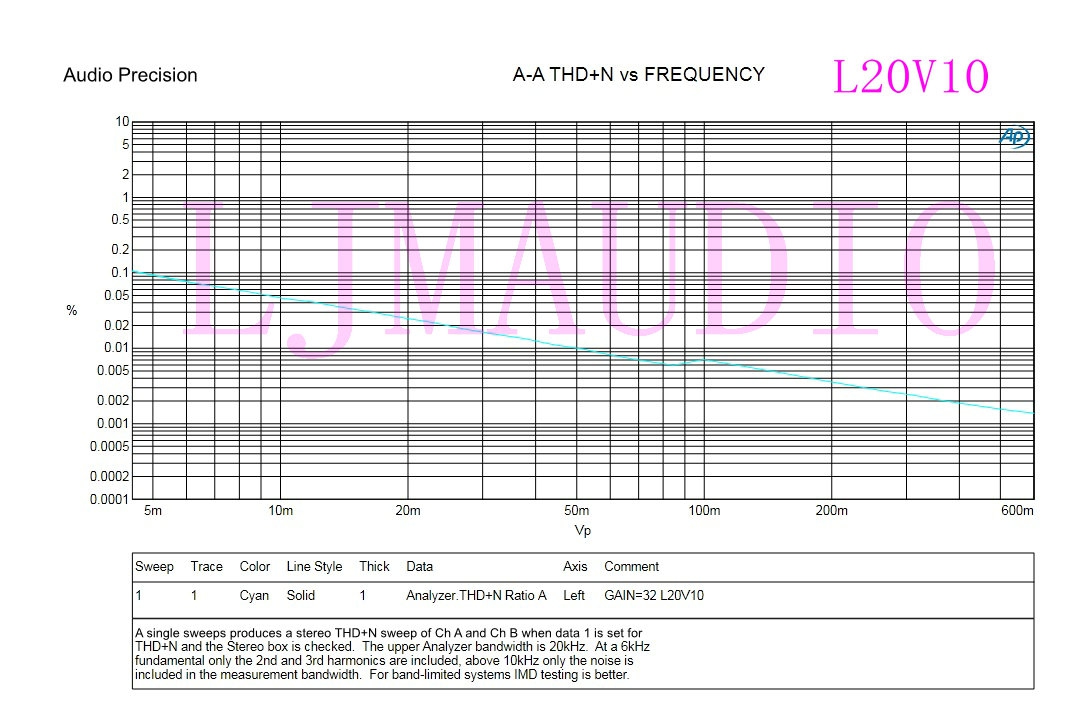

What load?This is my LME49810 power amplifier.
After my test, 40 w THD + N = 0.002%.

L20 AMP VER10. 200 w 8r + -65V
It has the strong ability of driving.

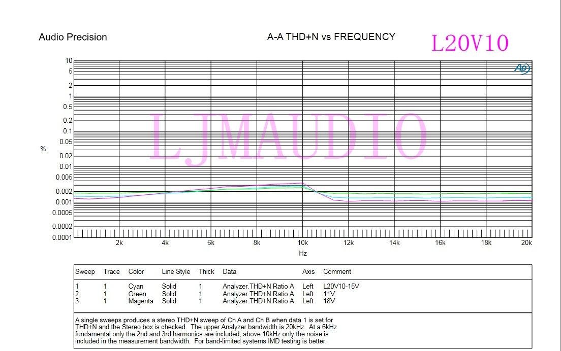

50W THD+N =0.0015%。
Etc. Have time I will measure. I also have many LM3886. But I don't like to use them.
L20 might be L series in larger distortion.
But it has a strong effect.
In comparison, L12-2 THD + N = 0.0005%.
But I prefer L20 very much.

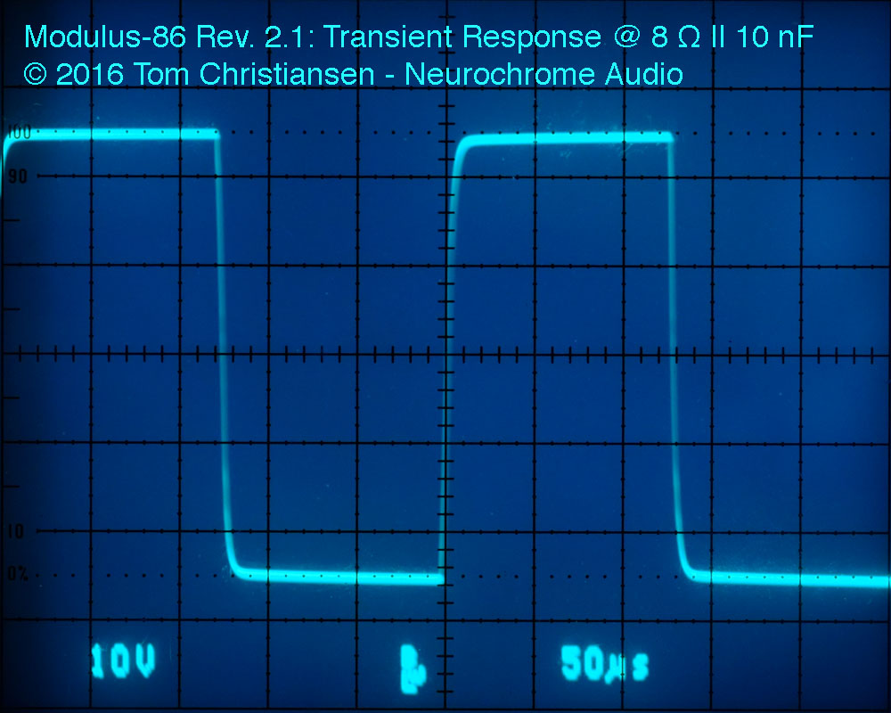

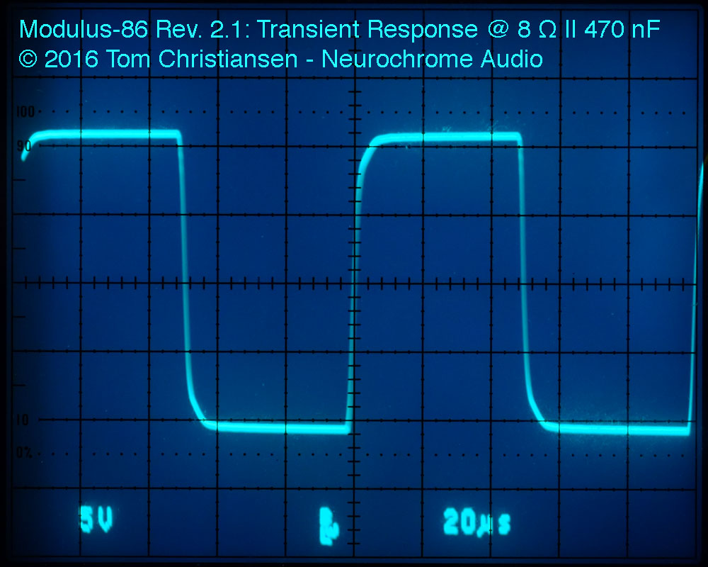

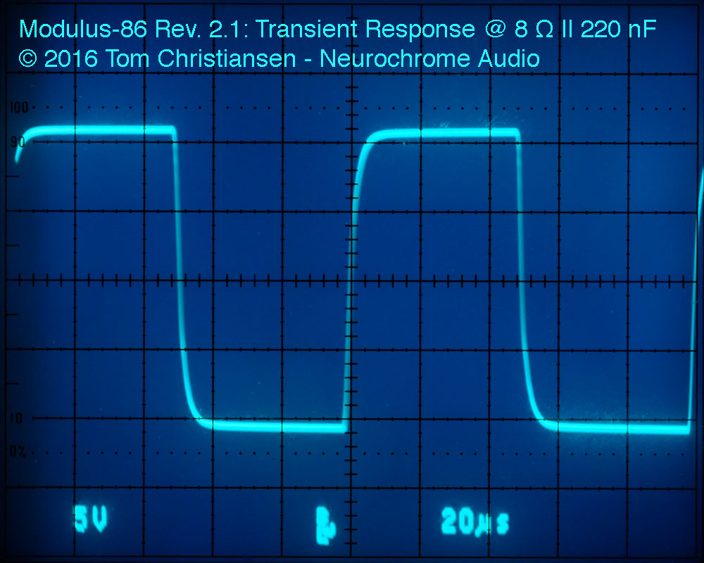

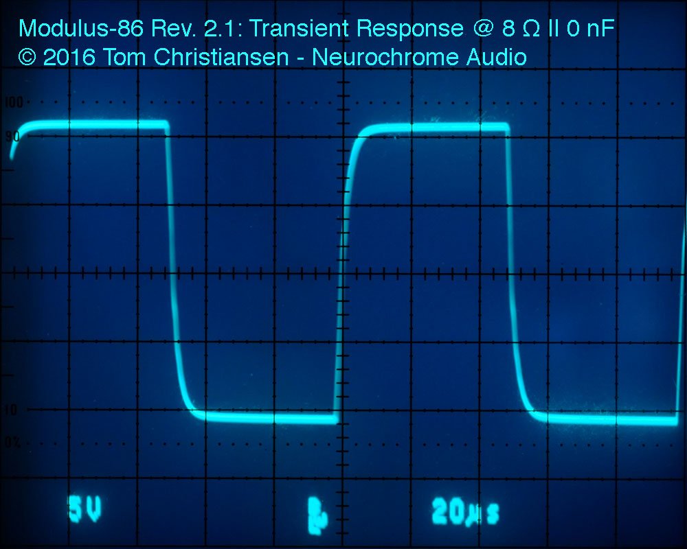

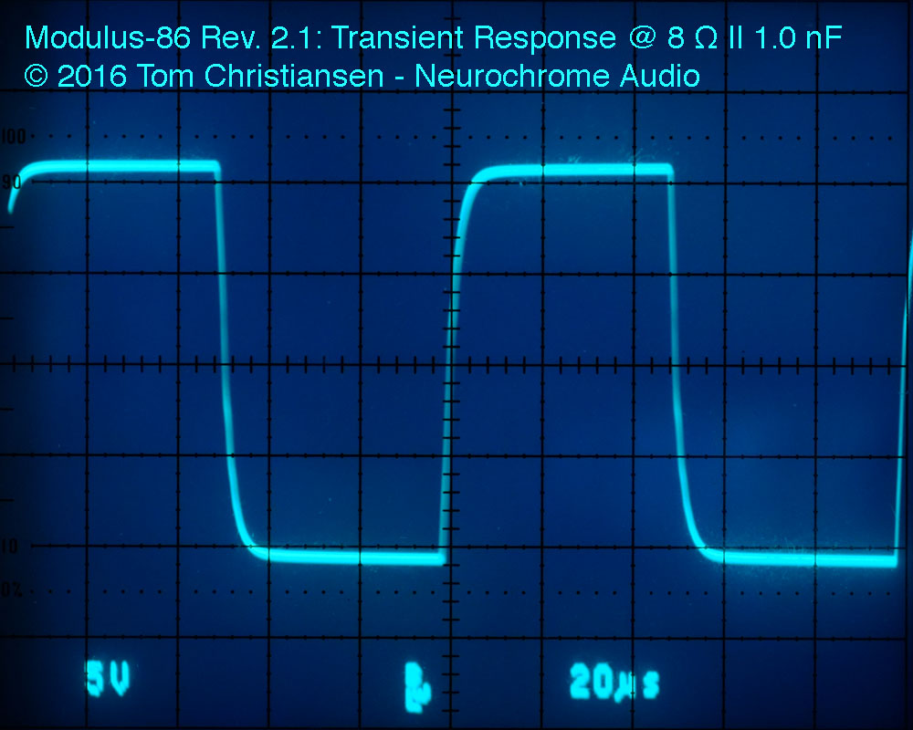

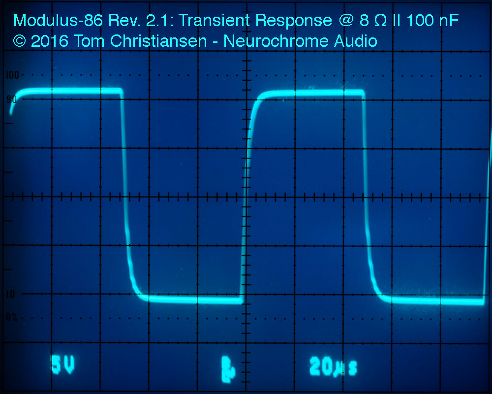

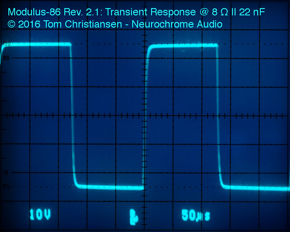

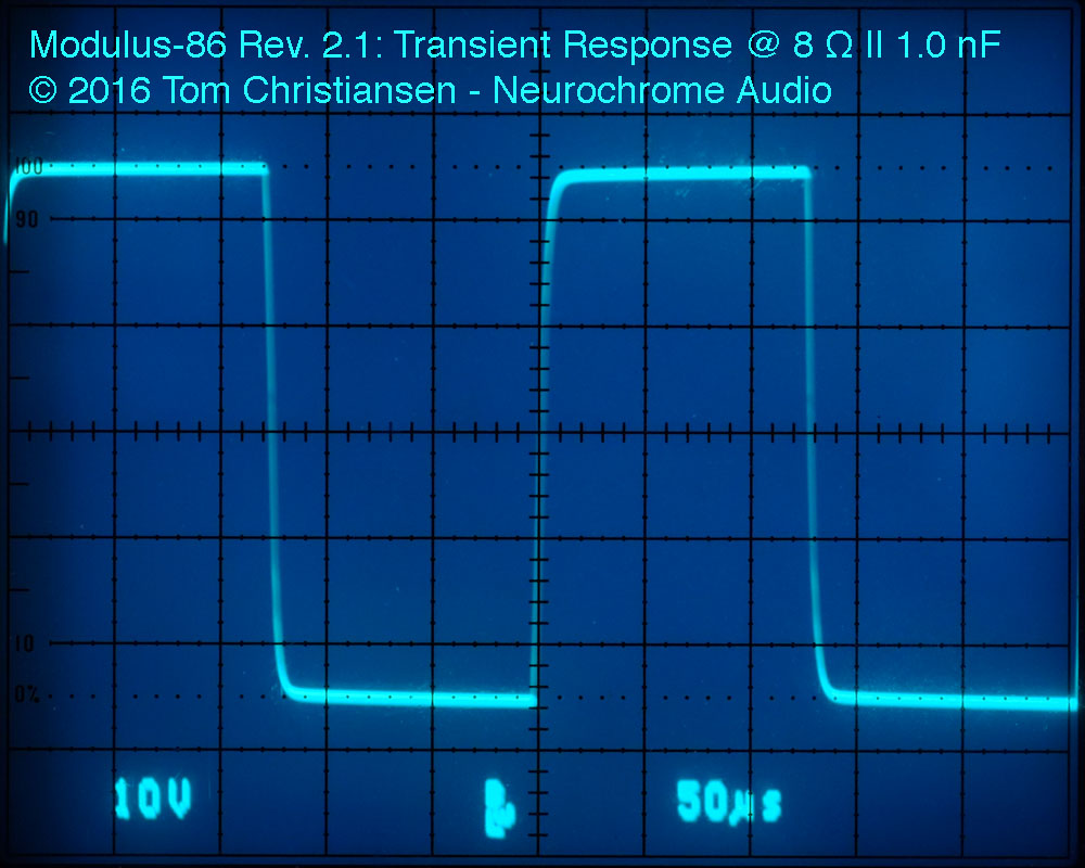

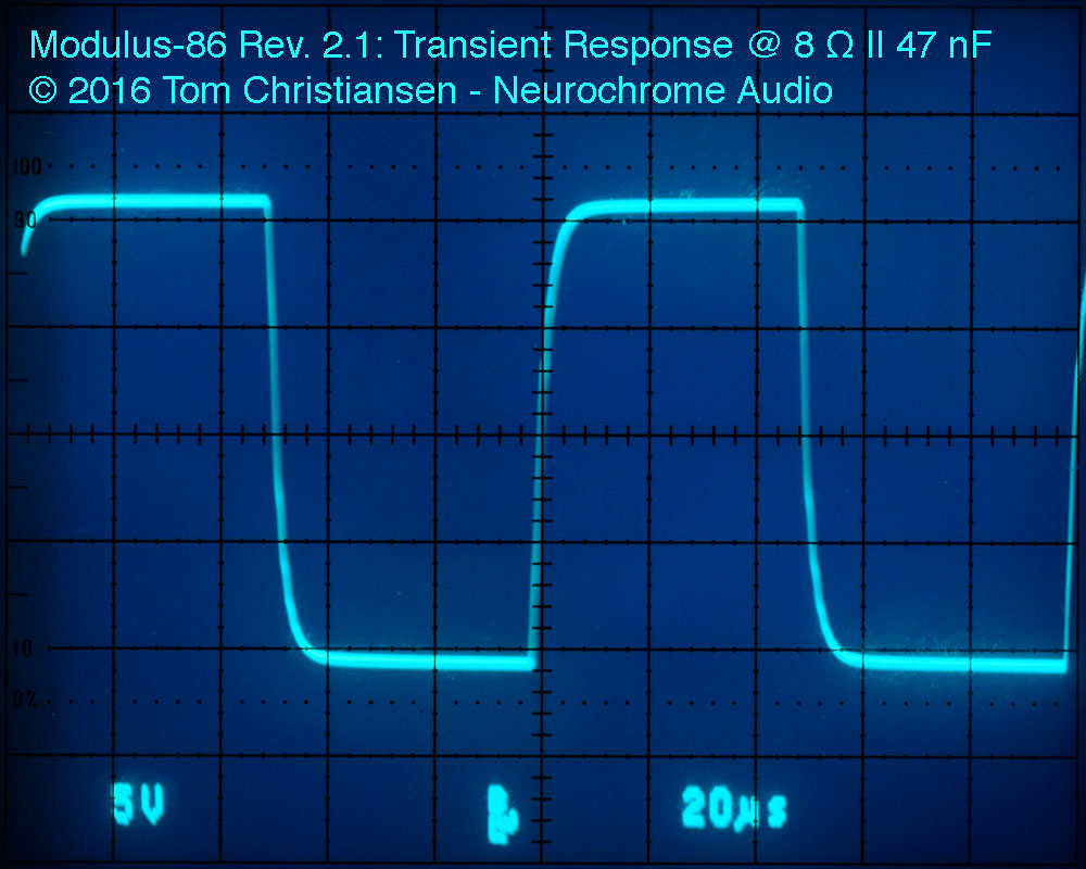

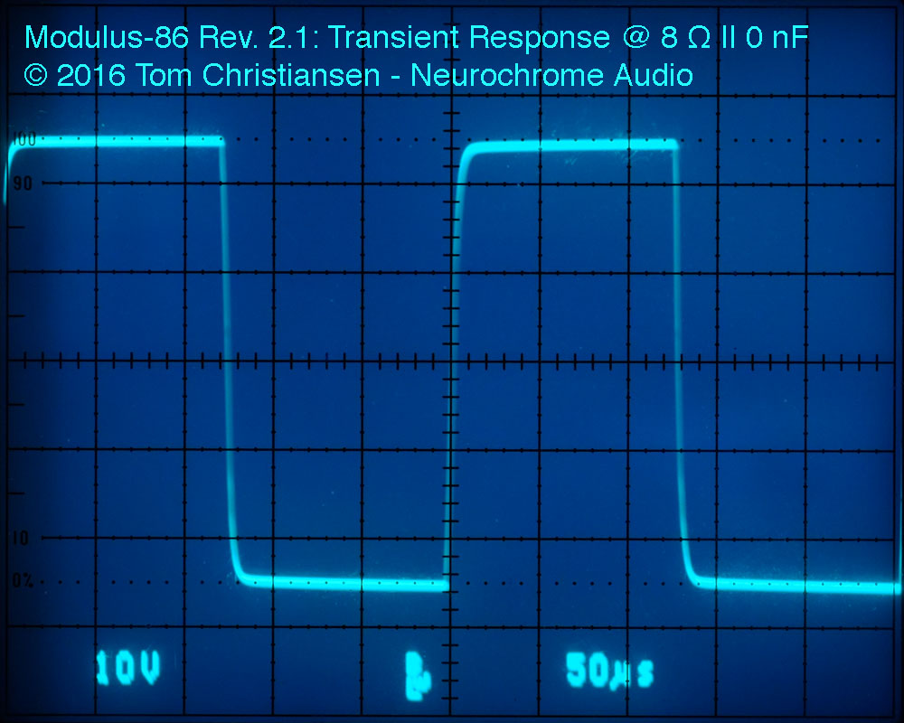

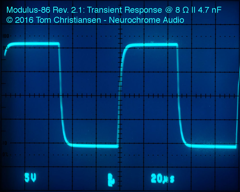

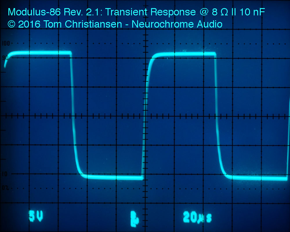

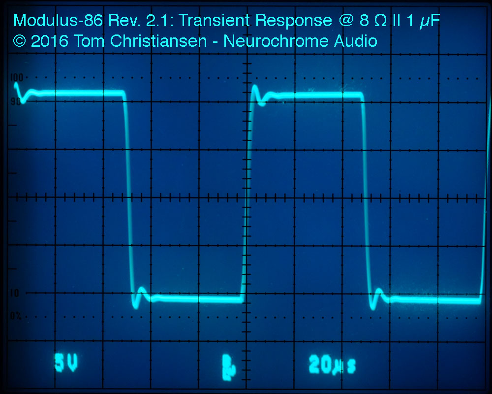

So on the topic of the Modulus-86 Rev. 2.1: As mentioned previously, the edge rate of my function generator was overdriving the input of the Modulus-86, causing the amplifier to reach its slew rate limitation way too soon. That's not surprising given the 10 ns rise time of the function generator.
The fastest slew rate that can be generated by a DAC running at 192 kHz is 1.07 V/us, so I retook the transient response plots at this slew rate. As expected, this cleaned up the edges considerably.
The little blip of ringing that you see on the 8 Ω || 1 uF load is actually the resonance of the Thiele inductor and the load capacitance.
Increasing the output voltage to just below clipping produces the following responses.
I was using an arbitrary waveform generator to control the edge rate of the square wave. The observant reader will notice that I changed the frequency slightly in this second set of plots. This was done to maintain the constant 1.07 V/us edge rate. It was easier to change the frequency than to reprogram the ARB.

Much better, Tom, and more realistic. I do notice the slightest unhappiness on the 470nF load -- the roundish corner at the top when going up and bottom when going down is not quite as roundish as the loads with less C.
Very commendable performance.
That is true. At 470 nF the last 20 % of the edge gets a little faster as the Thiele inductor + load cap resonance is starting to wake up.
