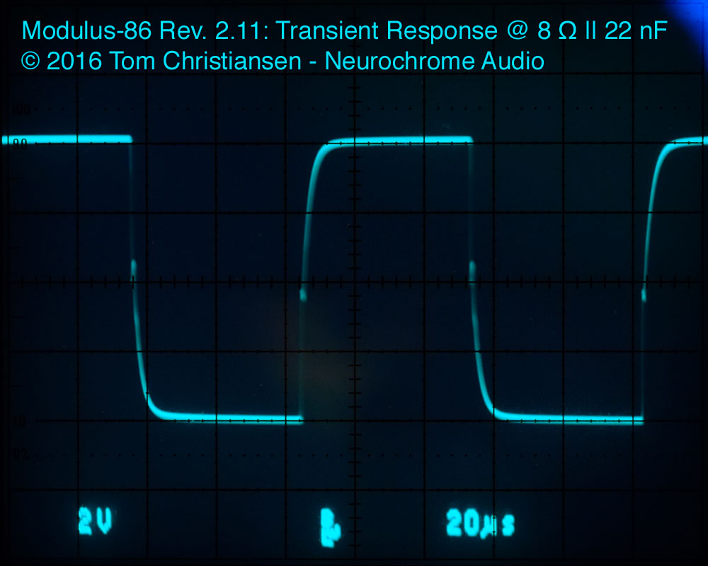

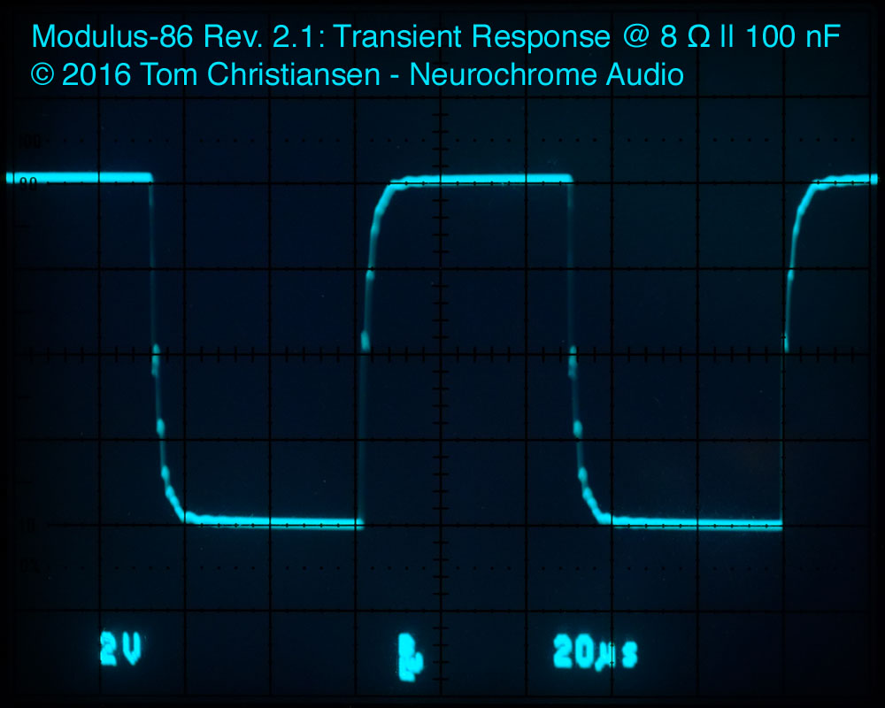

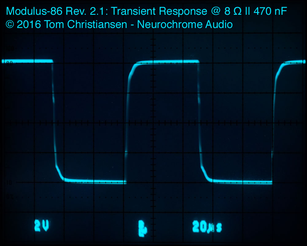

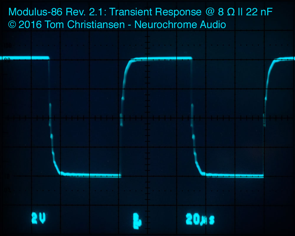

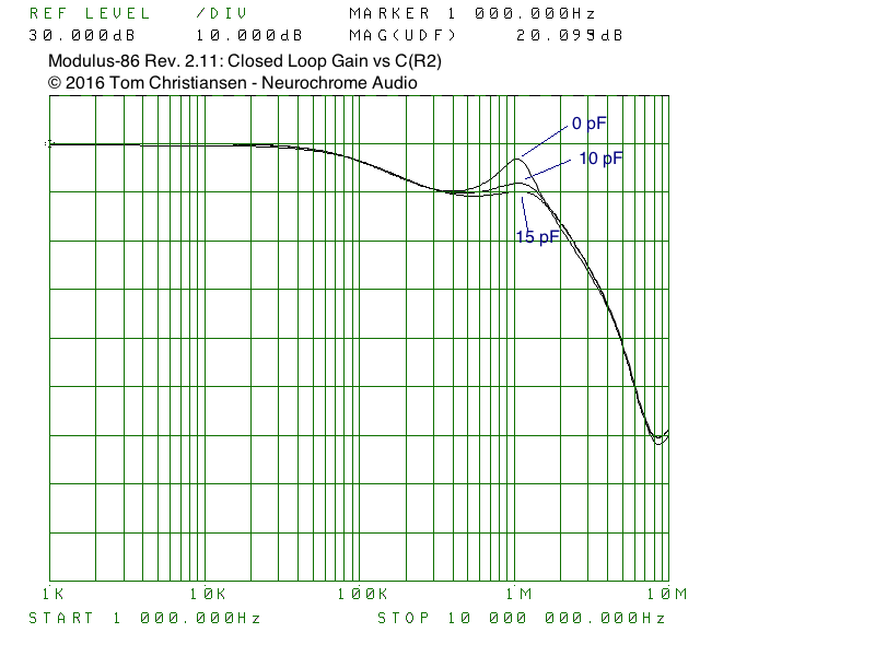

These measurements on first sight look nice, but how about a frequency plot out to 10MHz?

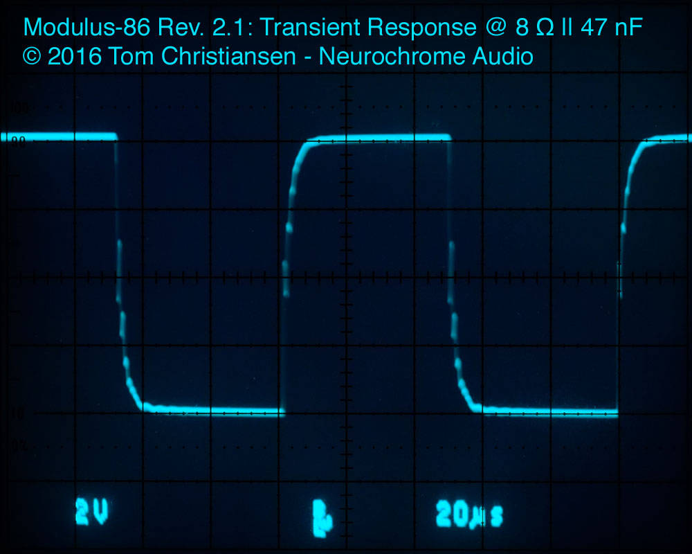

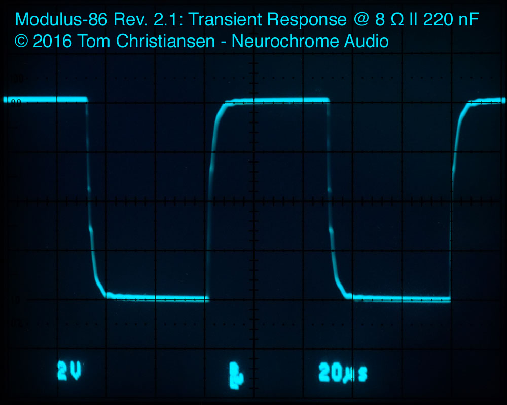

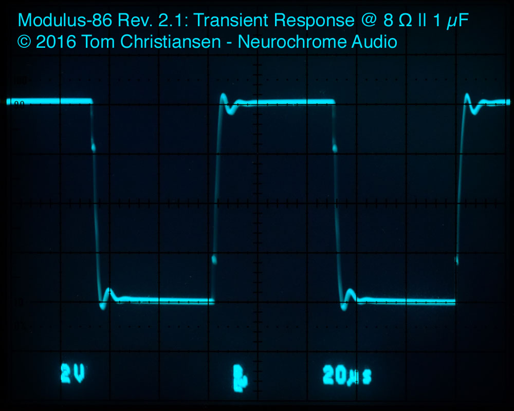

I do apologize for the delayed response here. I had to dig myself out from under a couple of exams and paid gigs so my lab time was limited. I also wanted to make sure I allotted enough time to do a thorough job as concerns about stability are always to be taken seriously.
I am attaching a stack of transient response plots for the MOD86 Rev. 2.1. The plots were done with various load capacitance in parallel with the 8 Ω load resistor. The loop is stable.

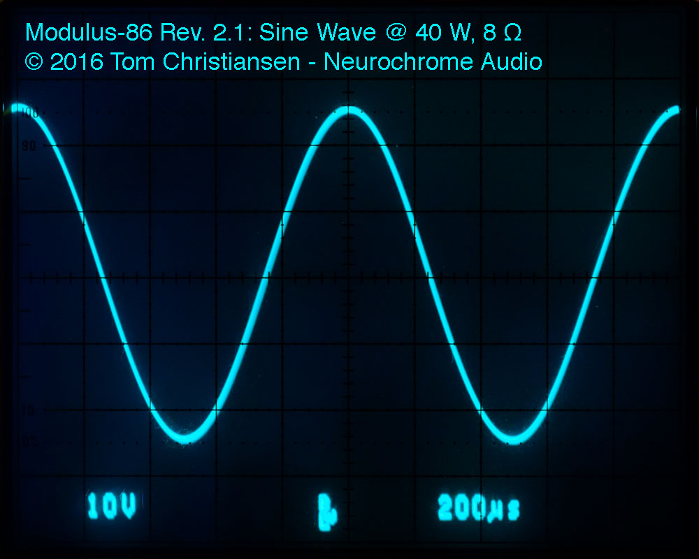

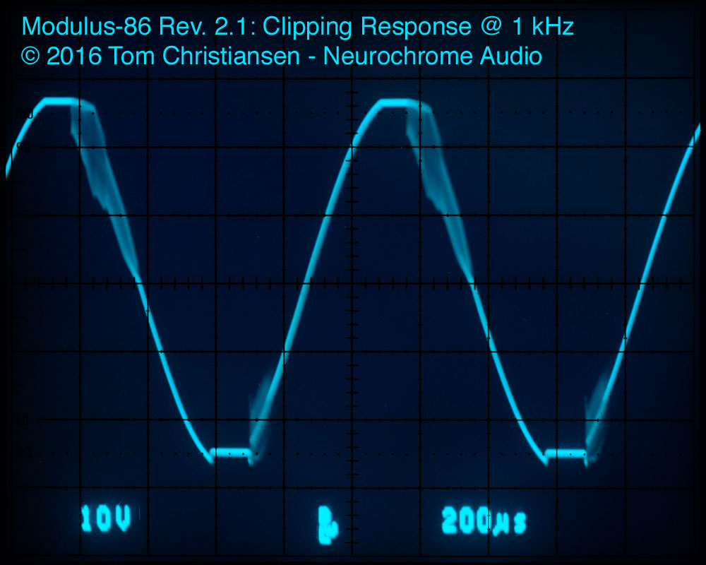

Also attached is a scope shot showing the clipping response at 100 Hz, which is quite clean, and the clipping response at 1 kHz, which does show a little bit of buzz as the amp recovers from clipping. Most importantly, the artifacts from the loop dynamics (LM3886 gain change) are very short term and the amp quickly gets back to normal.
I have torture tested this amplifier to great lengths and I am fully confident in its abilities as an high-end audio amplifier. That said, it is designed to operate away from clipping. It is not a guitar amplifier.
In terms of actual, practical use, my 4-channel MOD86 Rev. 2.0 amp is still going strong. It sees hours of use every day and I do crank the music on occasion. It drives my LXmini speakers as well today as it did nearly a year ago when I built it. Life is good. 🙂
Tom

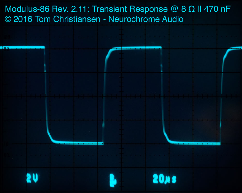

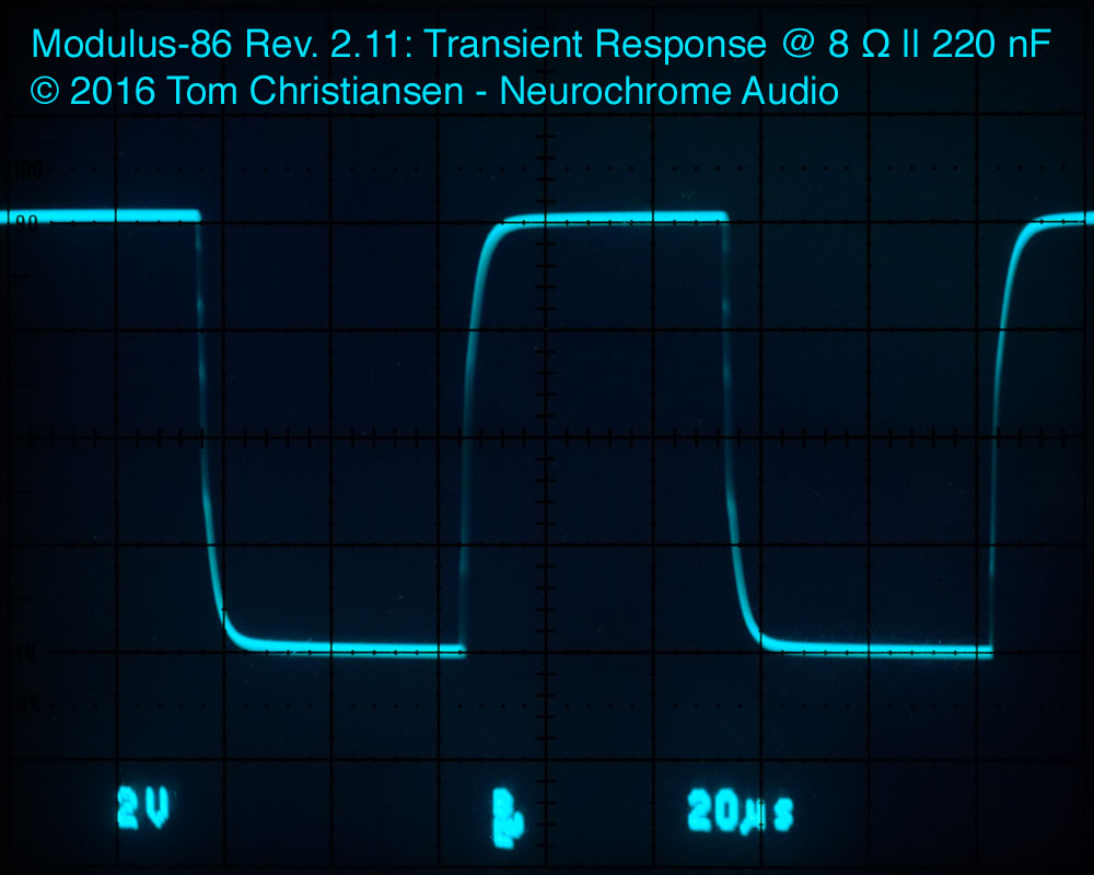

I reached the limit on the number of uploaded files, hence, I'm splitting my response in two.

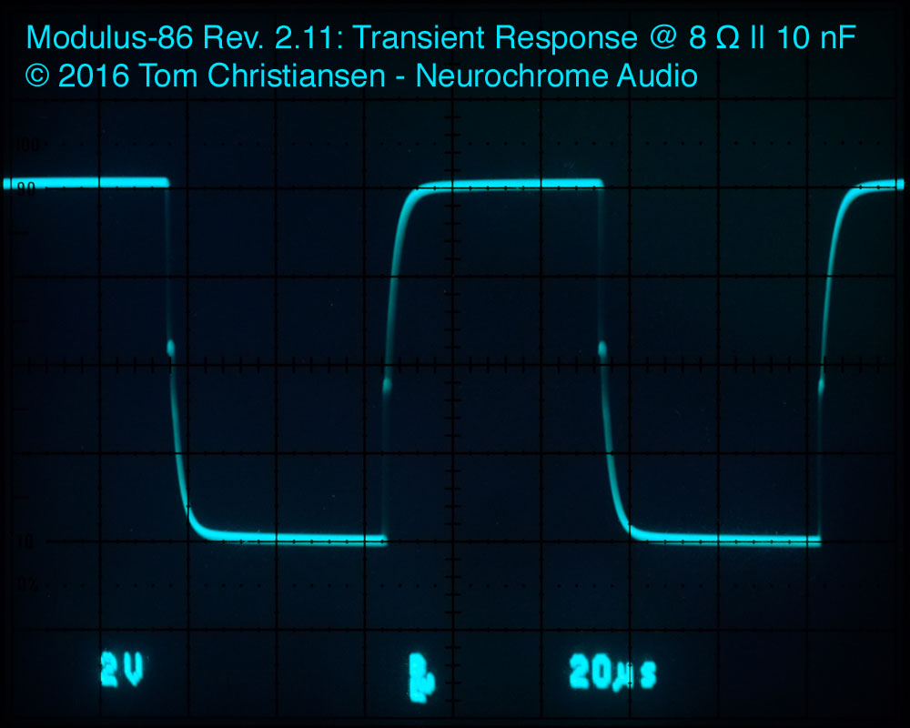

Now for the requested closed loop gain plot to 10 MHz. That is attached. It does show a hump at 1 MHz. This hump is due to the local feedback loop around the LM3886. I'll chalk it up to yet another quirk of the LM3886. It is likely due to the noise gain compensation (180 pF cap between the two inputs) recommended by National/TI.
If this hump bothers you, you can add 10 pF NP0/C0G dielectric across R2, the feedback resistor on the LM3886.

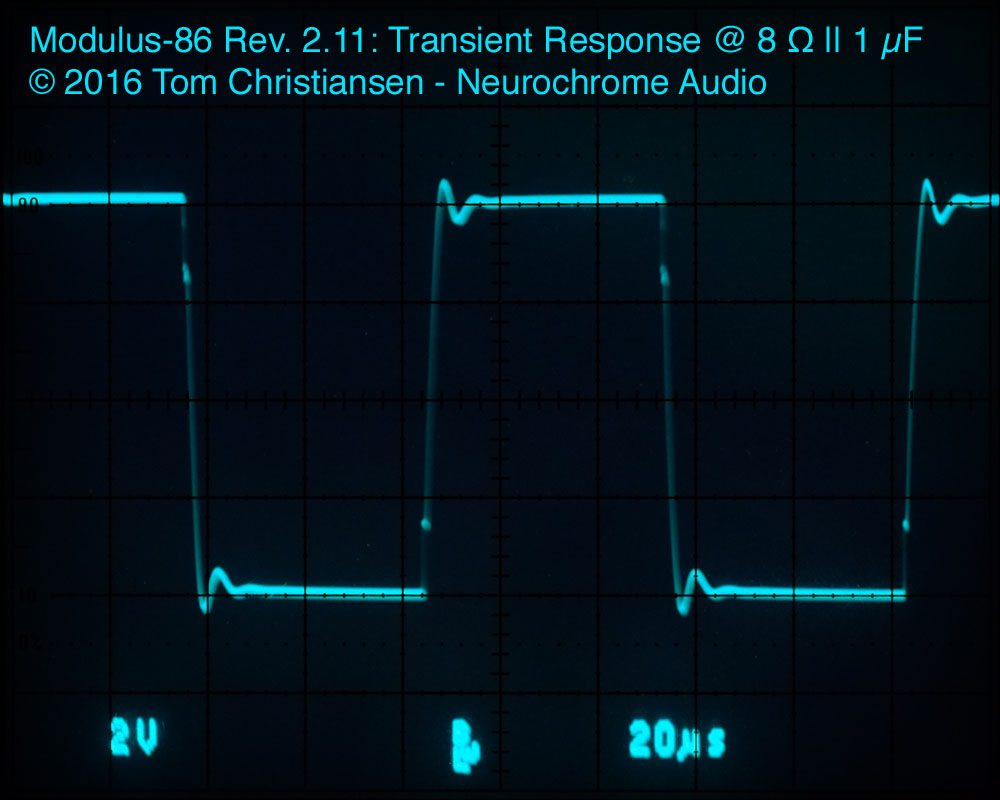

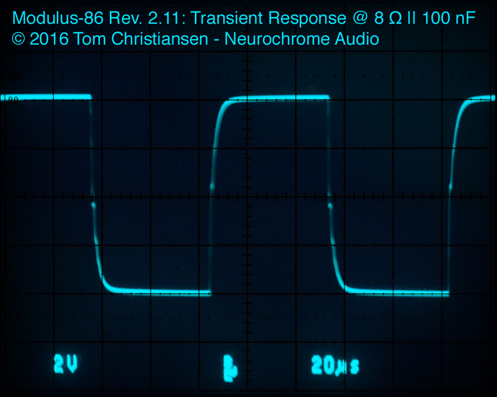

Personally, I see no need for any circuit changes, but each to his own. A 10 pF cap across R2 does reduce the hump and it also appears to clean up the edges on the transient response a bit. The downside is that it results in slightly worse clipping response, so you shave off a few watt of maximum output power (60 W rather than 65 W into 4 Ω). The clipping response isn't significantly different in terms of the overload/recovery behaviour, the amp just clips a touch sooner.
I retook the transient response plots with 10 pF added across R2. Don't read too much into the label "Rev. 2.11". I had to tell the setups apart somehow. 🙂
Tom

Do note that the input to the amp for the transient response measurements is a square wave with a very fast edge. The edge rate is 40 V/µs - about 37 times faster than the fastest edge rate possible for a rail-to-rail step in a 192 kHz sampling system (assuming 2 V RMS out).
As I said... Torture testing. 🙂
Tom

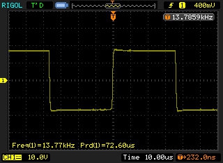

You may find the 'buzz' is partly due to the SPIKE protection in LM3886.Also attached is a scope shot showing the clipping response at 100 Hz, which is quite clean, and the clipping response at 1 kHz, which does show a little bit of buzz as the amp recovers from clipping. Most importantly, the artifacts from the loop dynamics (LM3886 gain change) are very short term and the amp quickly gets back to normal.
If you repeat the test with eg 5V less rail voltages, you might find the 'buzz' disappears.
You know. That's pretty darn likely. At lower rail voltages the amp can clip a lot harder (almost to the point of a square wave) before the buzz starts. Also at no load, there's no buzz. Even at 16 Ω, there's no buzz. The SPiKe protection does indeed seem to have something to do with it.
Interesting quirk. I don't think there's any action for me to take, however.
Tom

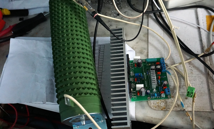

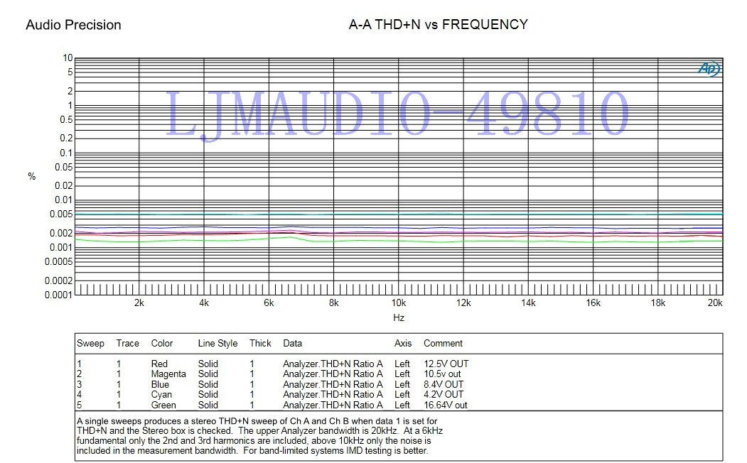

This is my LME49810 power amplifier.
After my test, 40 w THD + N = 0.002%.
The actual measurement data is bigger than the value in the IC official documentation PDF.
I think this is reasonable, because in the actual practice, many elements will bring some distortion.
Including capacitance, the power supply. Or the conductor. I don't believe anyone amplifier,
Can more than NS PDF document's data.

Looks pretty good - but I thought you were talking about TIM (SID).
