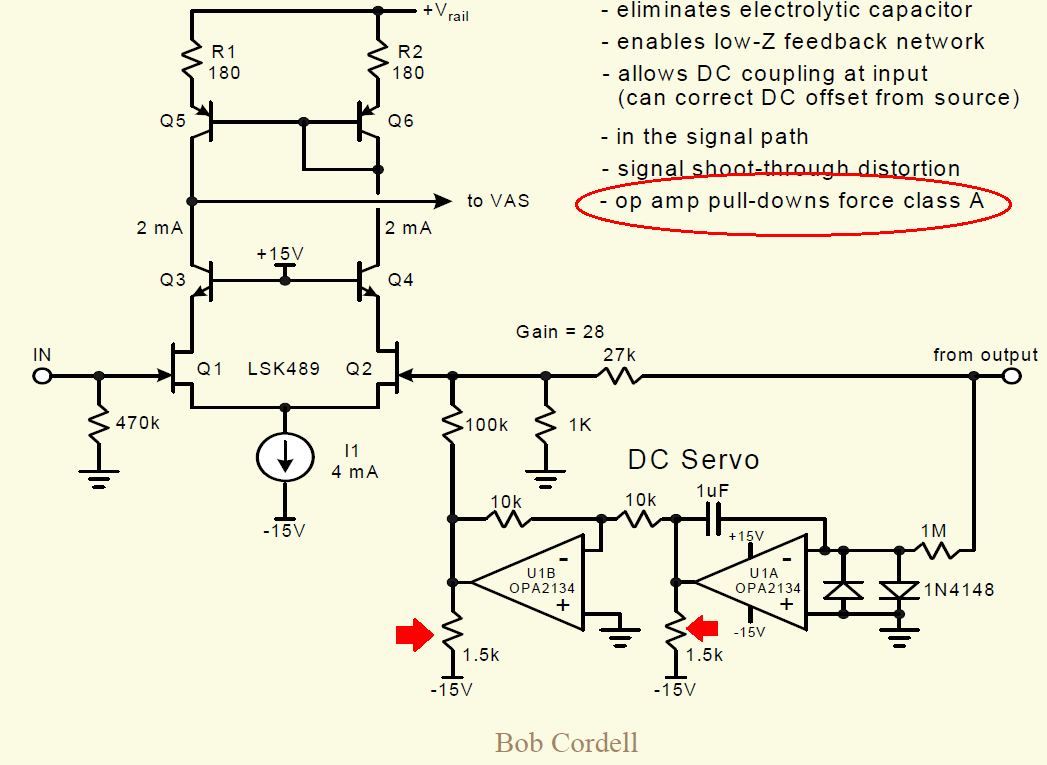

Bob Cordell's talk at Burning Amp 2016 included an interlude about DC servos. He said that he believed the opamp's output impedance was an important factor too. In fact he attaches quite beefy pulldown resistors to force the opamp output current to be waaaay bigger than zero at all times, namely, Class A. Since output transistor gm is proportional to current, and since output impedance is proportional to (1/gm), bigger current means lower output impedance.
I've attached a snip from one of Bob's presentation slides below. I'm the one who put the stupid looking red markings on the picture; Bob did not.

[Cordell] said that he believed the opamp's output impedance was an important factor too.
I'm curious what his justification was. The DC servo usually outputs into a feedback impedance on the order of 10s of kΩ. I wonder if what he's seeing is that the loop gain of the opamp goes up a bit as the output stage is biased hotter. High loop gain -> better stop band attenuation -> no impact of the DC servo on the overall amp within the audio range. The MFB filter I use makes better use of the opamp loop gain so I can get stellar performance without resorting to tricks such as dummy loads. Maybe the two approaches address the same underlying issue.

Shoot him an email & ask.

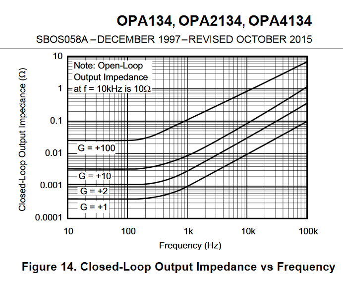

I observe that the DC servo connects to the most sensitive node in the entire power amplifier, so you want it to be especially, particularly clean and error-free. If your goal is 22 bit resolution (signal-to-error ratio >= 133 dB), and if you also connect a 100 kilohm* resistor between servo-opamp and poweramp-inverting-input, then you want the servo opamp's output impedance to be less than 24 milliohms over the audio band. {Math: 100k/0.024 = (2 ** 21.99)}
But that's just me running my mouth; I don't speak for Bob Cordell, obviously.
*as is done in the attachment to post #2290 above

Well. True. In case of the DC servo, I'm not able to measure any impact of it on the Modulus-86 within the audio range.
With the 3rd order filtering I'm using in the DC servo on MOD86 R2.x, I can put the LF pole at around 0.1 Hz without degrading the THD at 20 Hz. With the first order filter used in MOD86 Rev. 1.0 (and used by Cordell), I needed to push the pole down around 1-10 mHz to avoid having the DC servo degrade the THD at 20 Hz. Needless to say, the settling time of Rev. 1.0 is a lot longer than that of Rev. 2.x. 🙂
