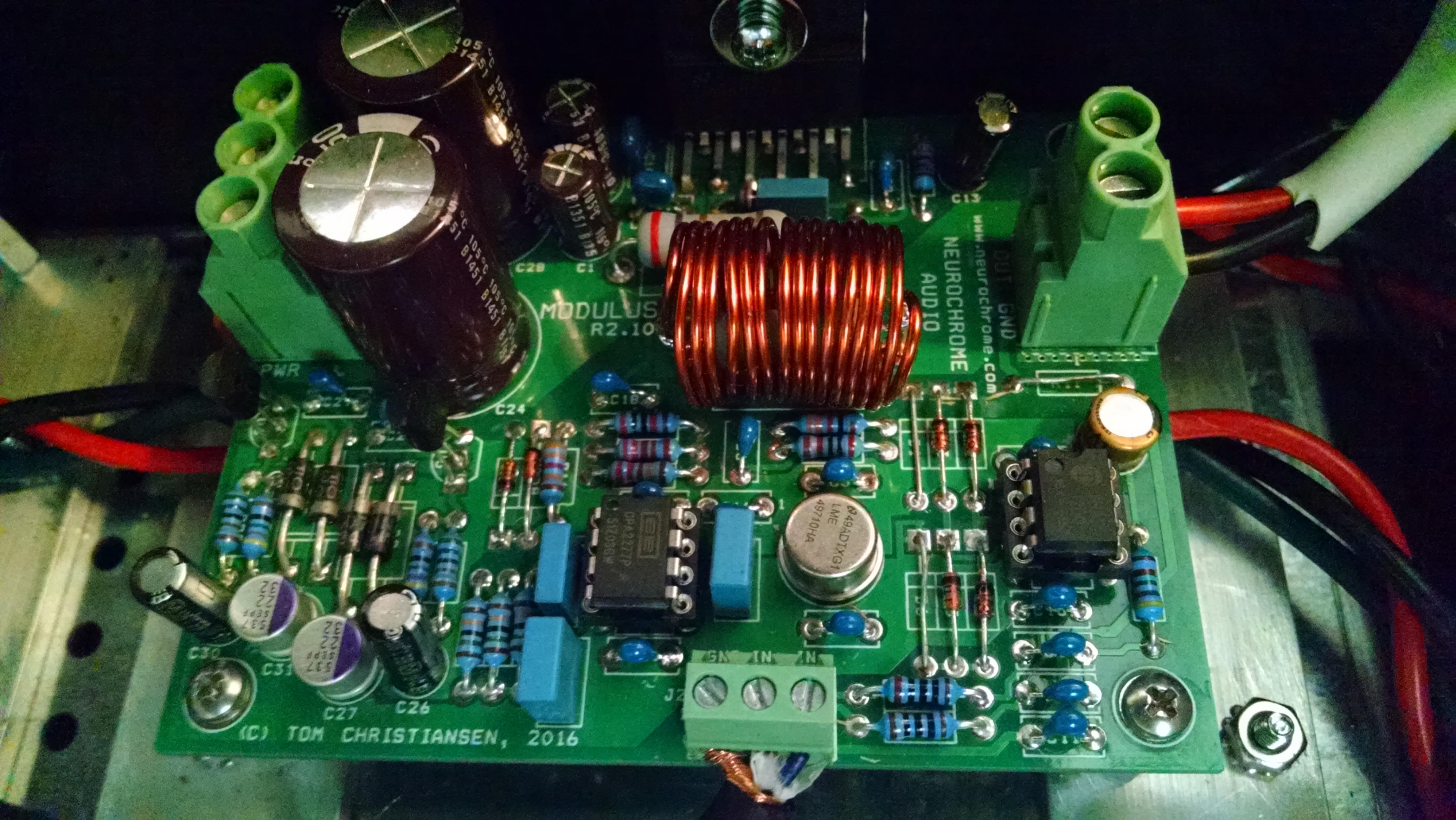

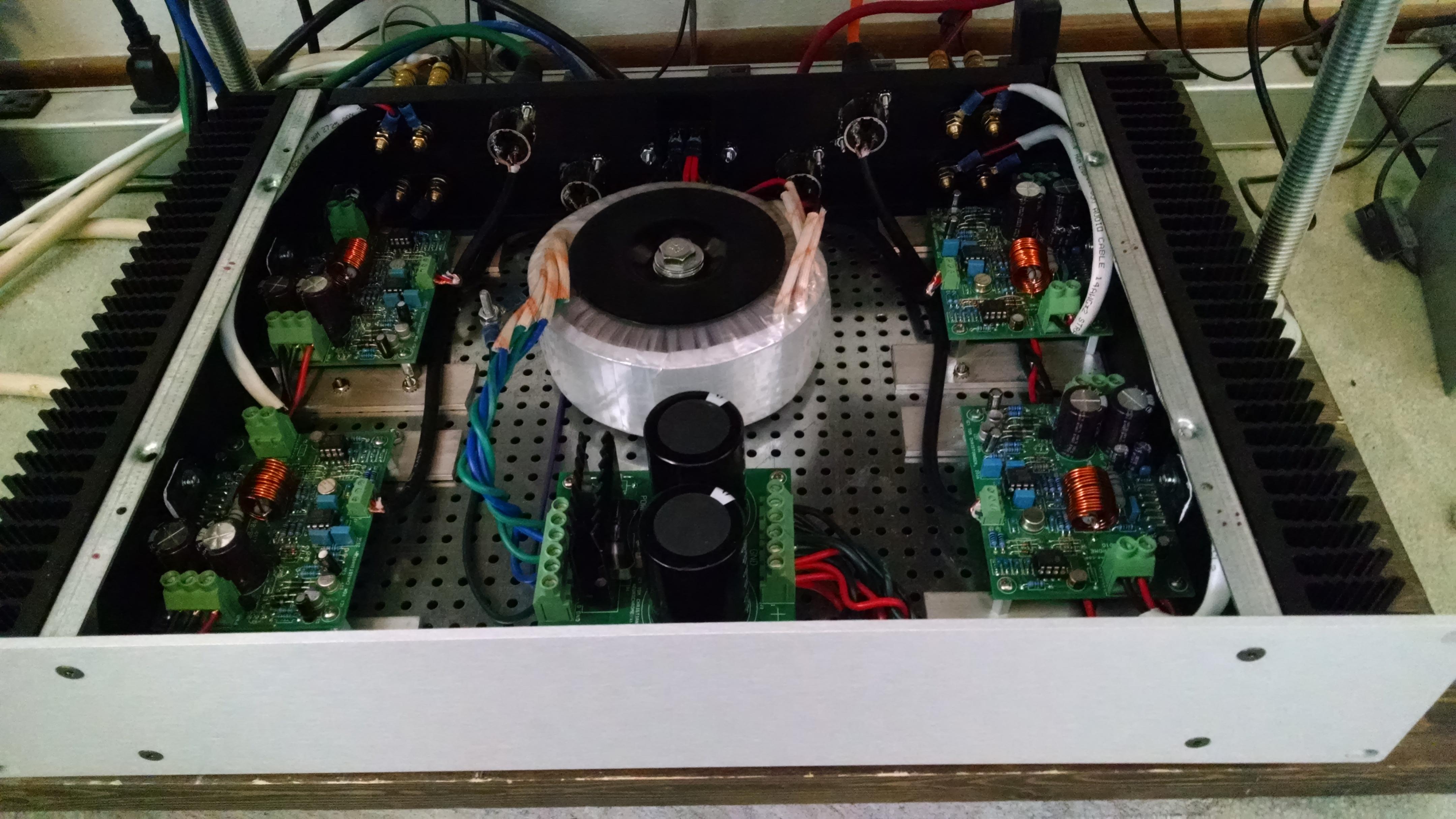

Over the last few days i have finished up my build. All four channels passed the first power-up test, with regulated voltages between 16.0 - 16.4 (+/-). Assembly of the chassis was completed yesterday. Today I prepped the XLR input cables, hooked them up to the Phoenix connectors of the Mini DSP 4x10, hooked everything up and threw the switch.
Silence. No hum, no hiss, but also no music. Nothing. The MiniDSP monitors show output to all four of the channels I'm using, and the sub outputs are getting a signal. I don't own a scope to confirm that there is signal to the input connectors on the board. I also don't have another balanced source to hook up to the amp.
The power supply sits at +/- 30.2 V. The fuses aren't blown.
Reading back through the manual, I see that I'm over the range for the stock value of R9, and should really have 47.5k instead of 33.2k. Would that prevent the amps from un-muting? Or would it just change the time to un-mute?
Where else do I look?
Bill
