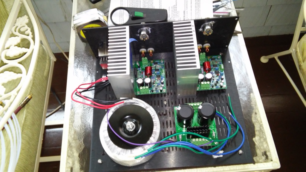

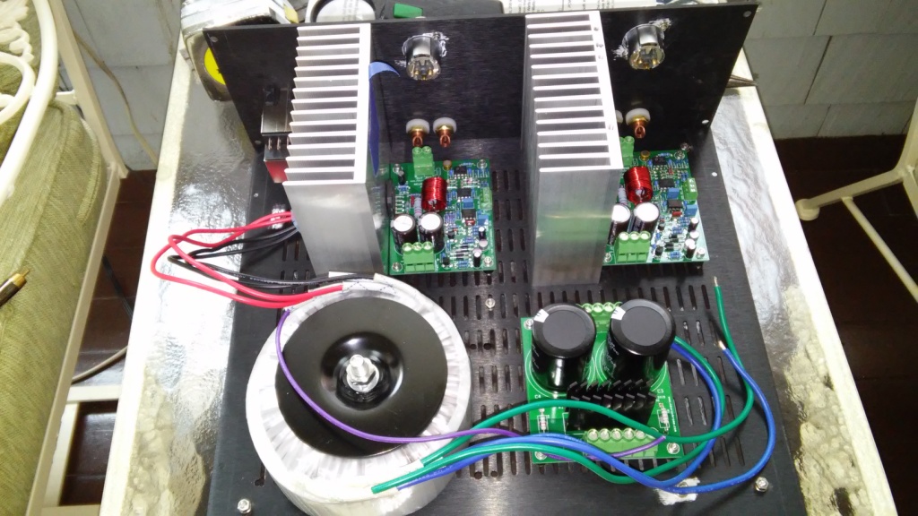

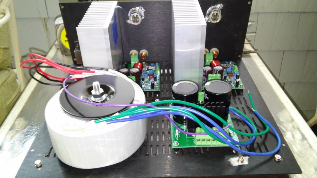

my mod 86 build
Here are some pics of my partial build. I'm posting this as a heads-up.
I bought a Modushop case with fully ventilated top and bottom covers, because I'm using internal heatsinks, and wanted the most airflow. These covers have many openings, hence they are quite flexible.
Once all components were attached to the bottom cover it sagged, near the center, from the weight. I added a fifth foot near the center and that solved the problem when it is resting on all five rubber feet
However, when lifting it by the sides, the center sags down about 1/4", near the center, over the 12" width. I doubt that is good for the boards so I'm screwing an 11" long piece of metal to the inside of the bottom cover. It will run from side to side across the center to eliminate the sagging. I will also be screwing small L brackets from the bottom cover to the front and back panels at the mid-point and these won't be visible.
I believe this has nothing to do with Modushop quality. If I bought the standard covers, with just one group of ventilation slots, I probably wouldn't be writing this.

Dang! Is the bottom panel steel or aluminum? I'm guessing the latter.
You could use the heat sinks as stiffeners. Just drill a couple of holes into the 10 mm thick heat spreader portion of it and tap for some M3 machine screws. A piece of aluminum L or U channel will stiffen up the chassis quite nicely as well without blocking too many of the ventilation holes.

Panel sag
Its aluminum. Each heatsink is drilled and tapped two places, for 6-32 screws, in the 10mm wide area. That will add some stiffness, however, the transformer is the primary cause. I plan to use some square channel Al I have for the crosswise brace. Its blockage will be negligible and away from the heatsinks.
If any sagging remains I will use 1/4" X 1/4" L brackets at the center, near the bottom edges, of the front and back panels to secure the bottom panel to them. All very easy to do and the combination of the crosswise brace and front and back L brackets should completely eliminate the sag.
Henry
Sounds like a plan.
