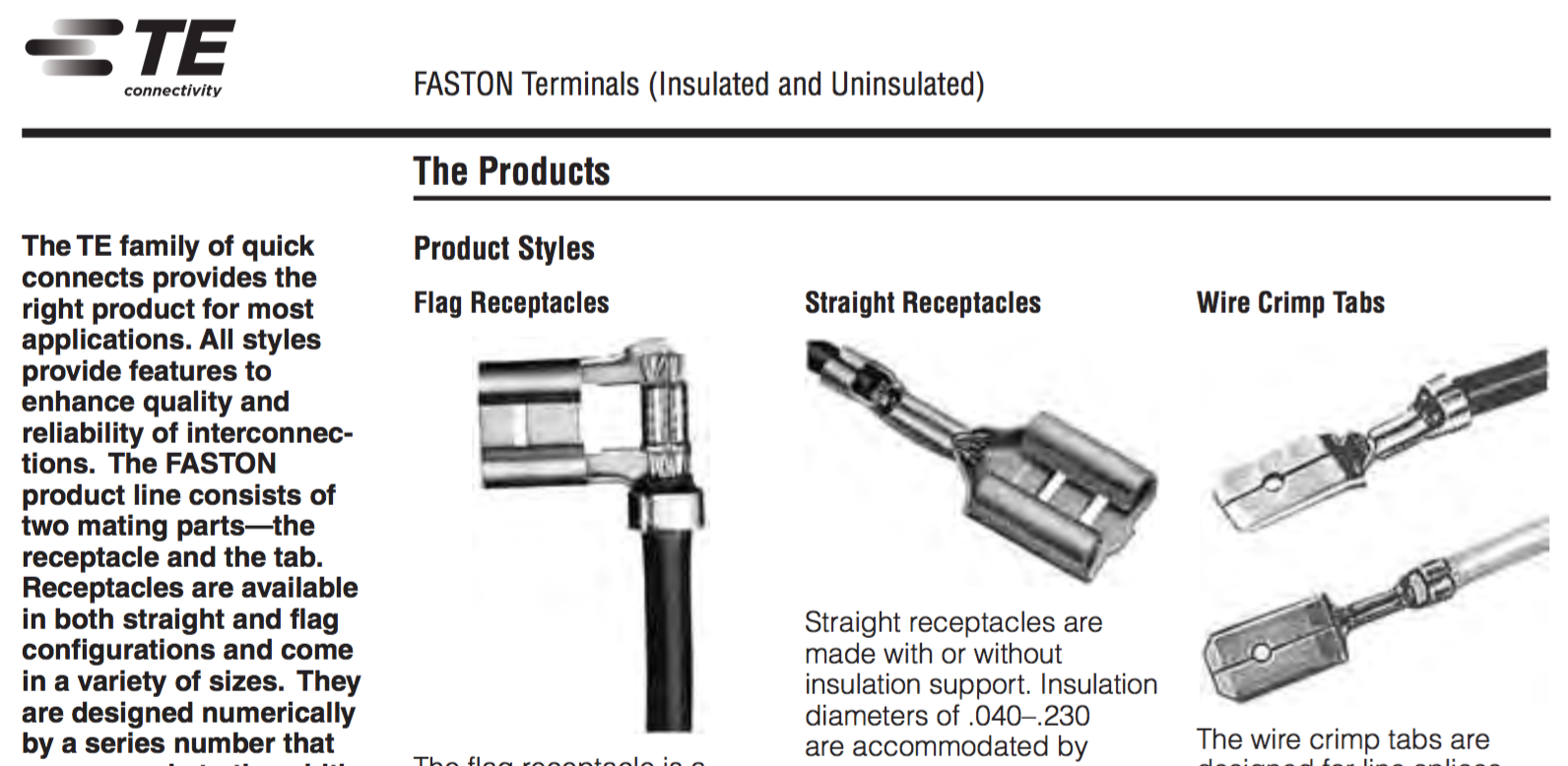

On a different topic; I bought the Molex crimper and tried it with some TE Connectivity Ultra-Faston Quick disconnects I happen to have. It didn't work.
I found the anvils of the, outrageously expensive, TE crimper and the TE connectors to be geometrically different than Molex stuff. Again I was fooled, or mis-led by reading and not understanding the details. I thought most things electrical were standardized. Foolish me. I've started contacting manufacturers to ask questions prior to purchasing anything..well not rubber bands.
Sorry it didn't work for you. I've had no trouble with the crimp terminals I pick up at the auto parts store. I believe they're Dorman brand.
Are you using the non-isolated kind (see attached)?

I found Dorman stuff on the web. It seemed as good as any brand and car parts stores carried it. I went to two stores near me and they only had dormans for .250 wide X .02 thick terminals. I need .187 wide X .032 thick so got the TE Ultra-fastons. They are fully insulated as were the Dormans but the geometry was quite different. The dormans are much more like the Molex. Bottom line, I ordered some Molex and all should be fine.
The 3/16" size is one of the many reasons I hate QC terminals with a passion. The SpeakON connectors I used had 3/16" terminals and I spent an ungodly amount of money on gold Audiophool spade connectors because that's what I could get at the auto parts supplier. There is a version of the SpeakON that uses 1/4" terminals, which are much more common. I suggest using that if you're going the SpeakON route.
