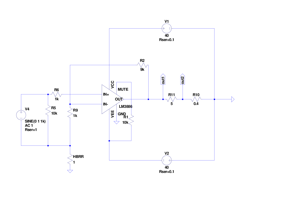

Here is the schematic of the simulation.
Mark, I checked as best I could, and the added cap does seem to fix it. . . when comparing while utilizing a badly made switchmode powered music source at input. Every computer at the Wal-Mart and for sure, also that Dell factory, would probably qualify as such a source, in which case, you'll want to add that cap.If R2 refers to large signal, then so must R9, otherwise a little error results. However, that trouble is high pitched, so a possible fix is a little cap in parallel with HBRR.
Also, I've heard an amp made like that schematic and I really tried to describe how I feel about that, but that didn't work. I was trying to decide if it was a buffer that failed, an astonishingly effective burglar alarm or the latest in upmarket high efficiency space heaters, but couldn't determine which it was. At this point, how would I know if adding the little cap would help it?
Today, we have more resources--please use Philfr's schematic to do proofing with simplified LM3886 amplifiers. That's because, I think it would be pleasant and simpler to use examples that work practically, prior to proofing concepts on them. A simulator alone doesn't quite get it. I was so distracted!
Indeed that is true of that schematic.Adding a capacitor will have (almost) no effect. Ignore R10 and the low gain (R2) and you have the datasheet version plus ground loop control.
However, I can't use that schematic.
So, there could be apples with oranges when trying this.

Mark, I sincerely apologize for some of my comments. The source of that error was my short capacity for viewing a schematic that I couldn't quite deal with, and for sure, had we used it, the LM3886 might have said a few things worse than I did. Apparently, I lack for imagination so far as the capacity to overlook the rather unhappy chip and instead look at what you were talking about, which was quite different, reasonable, interesting and valuable.. It was kind of like an LED flashlight at point blank range, a little hard to see around that, and I reacted unsuitably. Still sorry about that.Adding a capacitor will have (almost) no effect. Ignore R10 and the low gain (R2) and you have the datasheet version plus ground loop control.
Your schematic would probably work well if the inputs were flipped to achieve inverting mode. But, otherwise, please use Philfr's schematic on the grounds that it is easier to mod something that is already in active service because it works well. After that point there's more opportunity to study alternations more comfortably.
Tom had a little different take on this--he added some RC so that the LM3886 would remain calm, even at low gain and pushed rather close to the rails. Inverting mode would make that job easier, and Philfr's schematic is higher gain along with carefully chosen values that happen to work. Tom's added RC's onto Philfr's amp results in getting the LM3886 up to a highly suitable performance. And, well, I think that is amazing.
It is when an amplifier is quite healthy and working well that it can be used as measuring equipment, which then has the effect of facilitating measuring (by widely various means) by a much broader audience. It is in that case where I probably could manage a helpful comment. See? That function is so much better than that earlier business; and, I do apologize for that.
P.S.
If that was too wordy: Mark's schematic dealt with options at the input circuit and wasn't specific to the LM3886 itself, but rather a low gain tolerant small signal op-amp could be used as demonstrator. Anyway, it was a concept schematic and it did work for that.
I use a couple of RCs for various reasons. The first RC extends the bandwidth of the LM3886 output stage. It acts as a phase-lead compensation for the global loop. This network would be severely impacted if the LM3886 part of the show was made inverting.
To keep the LM3886 stable near the rails, a compensation cap is needed. That's the Cc you see in the data sheet. I ended up at a slightly lower value than the value given in the data sheet. This capacitor is completely independent of whether the LM3886 is used in inverting or non-inverting configuration.
