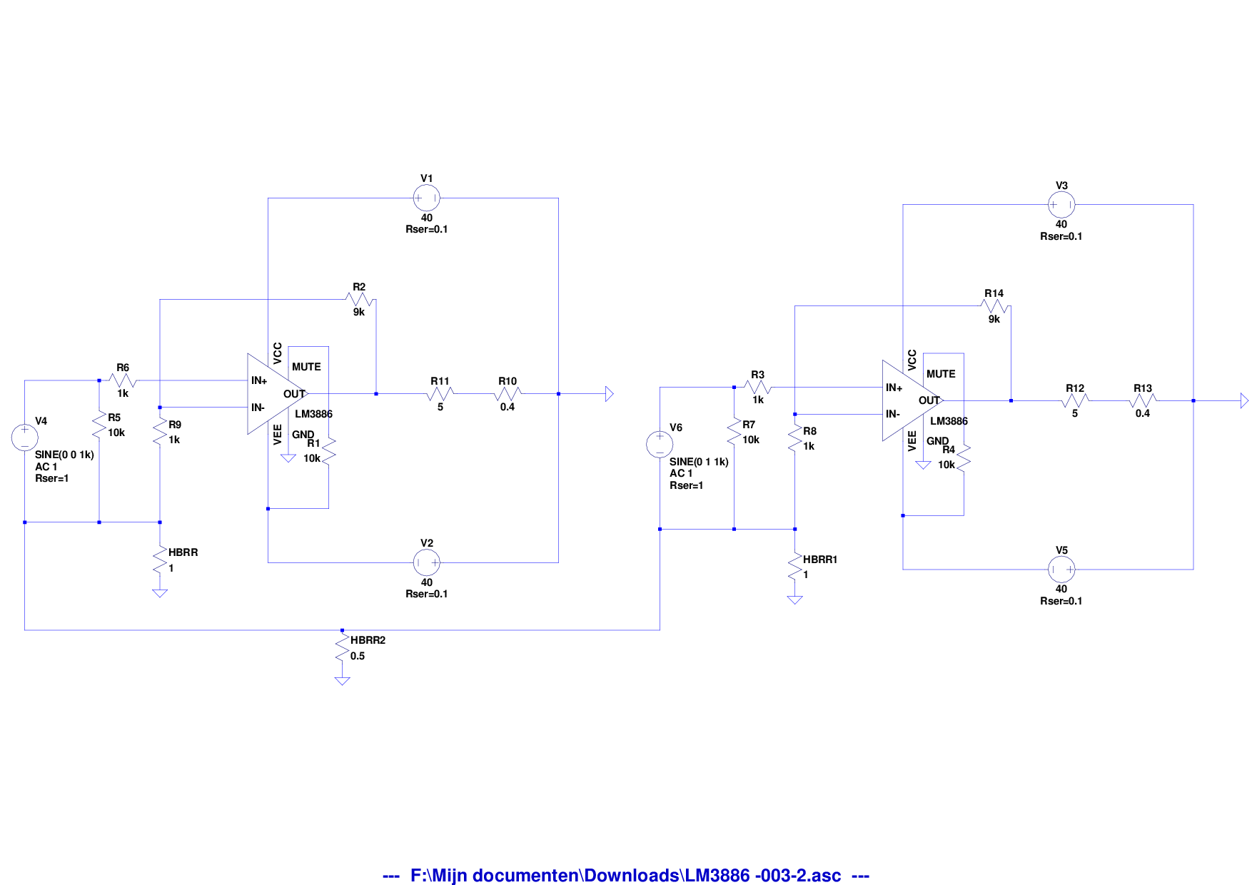

It appears that Gain set by the NFB is changed when HBRR><0 ohms.
For non-inverting amp: Gain = Rupper / Rlower
I have always stopped there. I did not consider that the resistance in the voltage reference link Signal Return to Power Ground as part of the negative feedback route.
If I take post954 and include HBRR as being inside the NFB loop,
then when a non zero HBRR is added in the gain becomes: Gain = Rupper / {Rlower +HBRR}
typically Rupper could be 9k (more typically for generallised 3886 it would be 27k) and Rlower could be 1k
and the new gain equation becomes marginally lower.
9000/1001 + 1 =9.991009 instead of 10. That amounts to a 0.09% reduction in gain. not subtracted from output, but a proportional reduction in output.

Why does the NFB loop include HBRR?
Why does it not stop at the Input Signal Return. The amplifier is reading the input signal, across R5, after all.

The voltage HBRR is not added to the output, it is subtracted from the feedback voltage at the negative input. It may even improve THD.
No, it introduces positive feedback. -60dB to be precise.

The feedback current flow is from OUTPUT to PGND but the negative input only sees the voltage over Ri. V(HBRR) is subtracted from the normal V(Ri).
Increase HBRR to 1k and the output increases by 1V.
What does the sim say about the THD with/without HBRR? I'd be very surprised if you find an improvement by adding HBRR.

I think the gain including HBRR should be:
Gain=1+Rfb/Ri+HBRR/Ri
HBRR increases the gain by HBRR/RI.

HBRR/HBRL is only required where a stereo pair of amplifiers inside the same case/chassis incorporate a grounding loop with the incoming Signal Returns from the stereo source.
HBRR/HBRL is there to attenuate the ground loop current that otherwise afflicts stereo installation when unbalanced inputs have a commoned Signal Return back at the Source.
Since a standard Tomchr implementation is balanced input and since each PCB can be assembled as a monoblock, then the HBRR problem does not exist in that installation. HBRR would be zero ohms, or as close as possible to get to zero.

On a serious note, I (and many others) use two different schematic symbols for the power ground and the signal ground as this assigns different net names to the two grounds. This makes it possible to join them at one point only in the layout - usually via a 0 Ω resistor. In one pro design (Parasound A23), I did see a ferrite bead used instead of the 0 Ω resistor.

For simulation of everything except the ground network, that's sufficient. For simulating the ground network, you need to include the various ground trace impedances.
