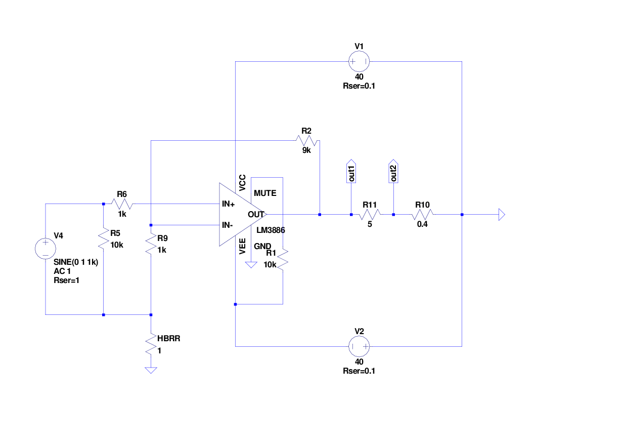

This is why you can place a resistor in this link and measure no voltage across it. There is no signal to measure. This would be Joffe's HBRR.
I(HBRR) = I(Rfb) = I(Ri) = Vout/(Rfb+Ri+HBRR)

And just as importantly the reference link between Signal Return/ground and Power Ground carries even less current than
The link should carry ONLY interference current and if interference attenuation is attended to at cable entries, then then is almost none left to pass along the Signal Return to Power Ground link.

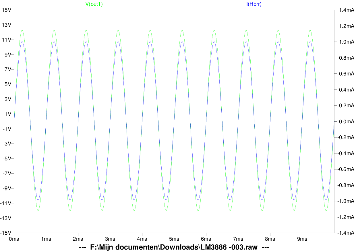

I can never measure any signal across a 10r HBRR.
Is your simulation correct?
10r * 1mApk ~ 7mVac
Yes, the simulation is correct.
Feedback is now a three resistor divider that is parallel with the speaker and zobel.
I have NEVER been able to measure a SIGNAL current across HBRR.
Since interference is so low, I have also NEVER been able to measure an Interference current across HBRR.
The simulation cannot be correct.
HBRR has a significant voltage in my simulations as well with the LM3886 model. Using a large wattage resistor vs small wattage resistor makes a sonic difference. I was surprised as well.
In my application, I have pin7 connected to signal ground.

But in real life I cannot measure a signal voltage across a 10r HBRR.

Um, guys... Have a look at Mark's schematic. The feedback current through R2, R9 has to flow through HBRR. This creates an error term which will be added to the input signal.
The current through R9 should be Vin/R9, so for 1 V RMS input, you'll have 1 mA flowing in HBRR. Even with a 1 Ω HBRR, this should be possible to measure in real life using a bench top multimeter. With 10 Ω HBRR, you should certainly be able to pick up the resulting 10 mV RMS on a scope.
Tom
It may "run fine" but the error term will still cause degraded performance. You'll certainly be able to measure this. Whether it's audible is another story. I suspect it will be, but I haven't performed the ABX testing to find out. A few mV out of 1 V (-50 to -60 dB error) should be audible, depending on how the error ends up summing with the input signal.
