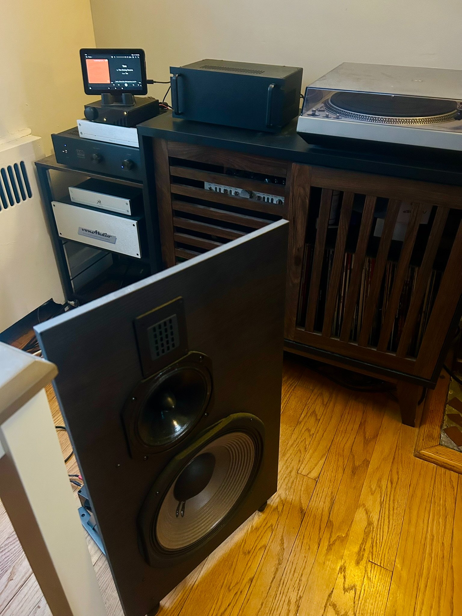

Taking a hiatus from my regularly-scheduled program of "Class A Amp of the Month," I put my Modulus 86 in the main system this morning. It's The Little Engine That Could. :nod: Sounds great. Thanks again for sharing your great products and expertise with the DIY world, Tom.
