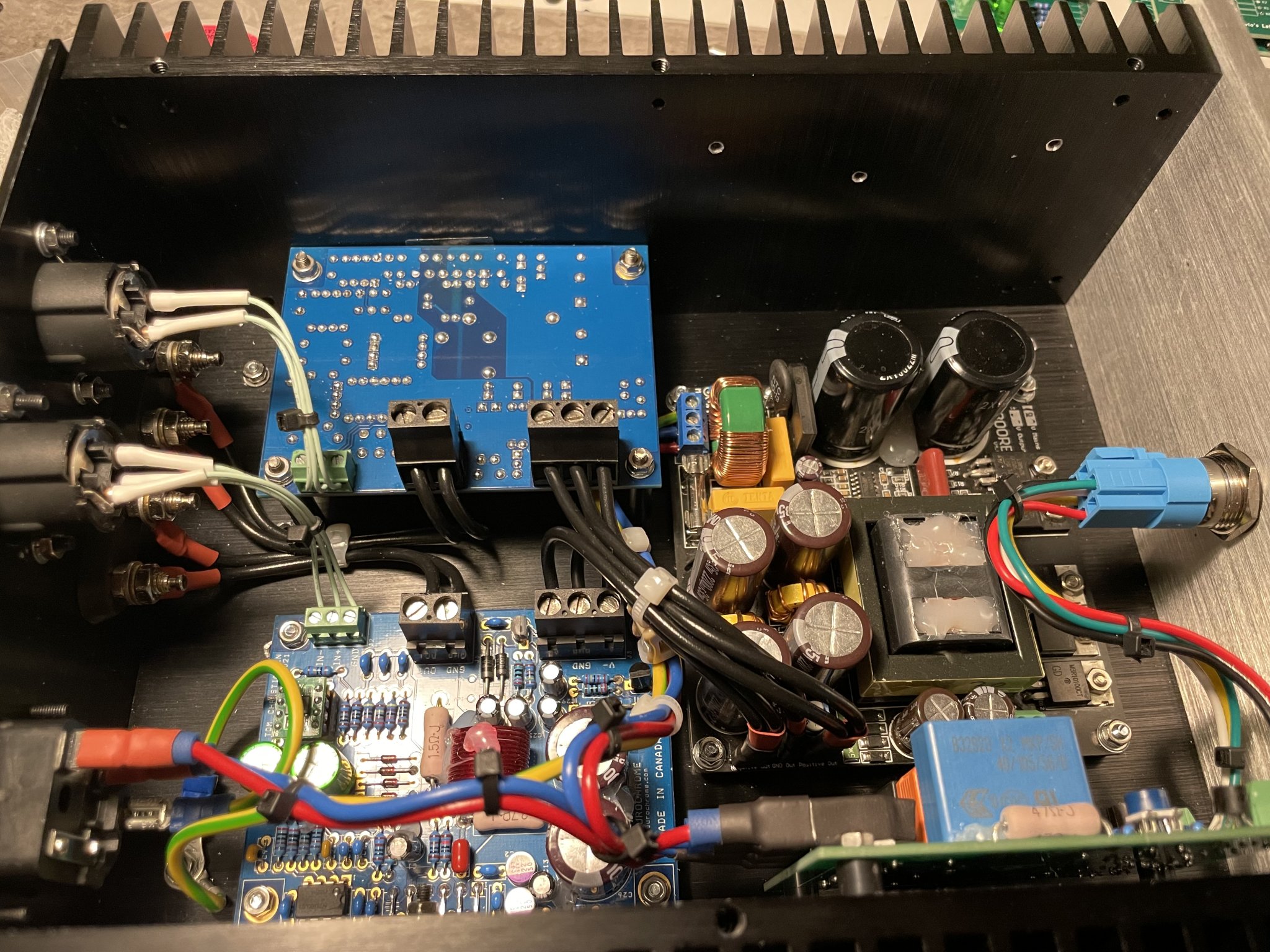

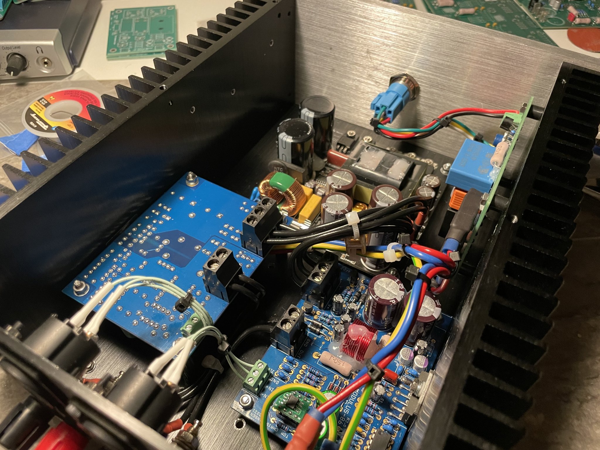

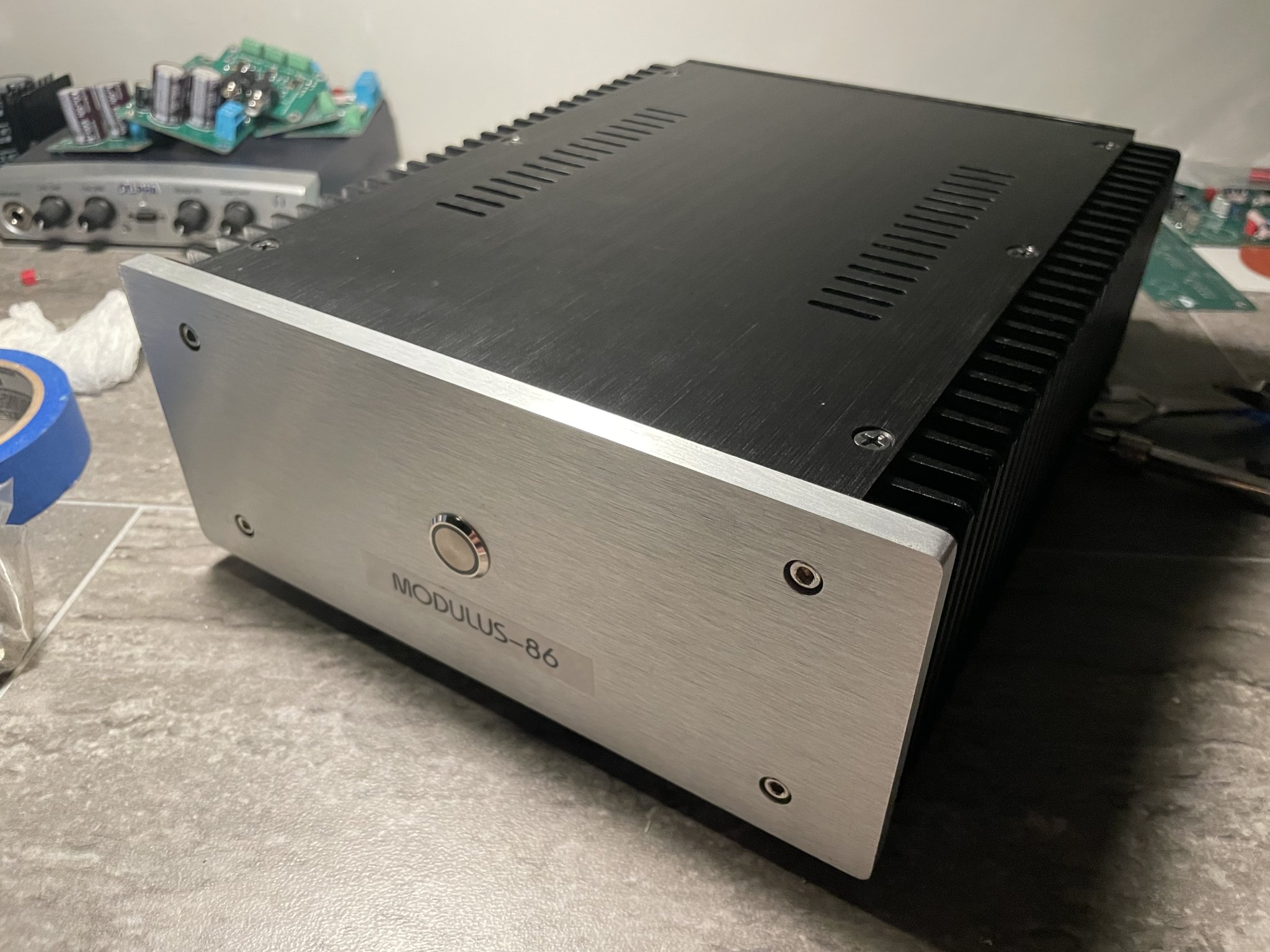

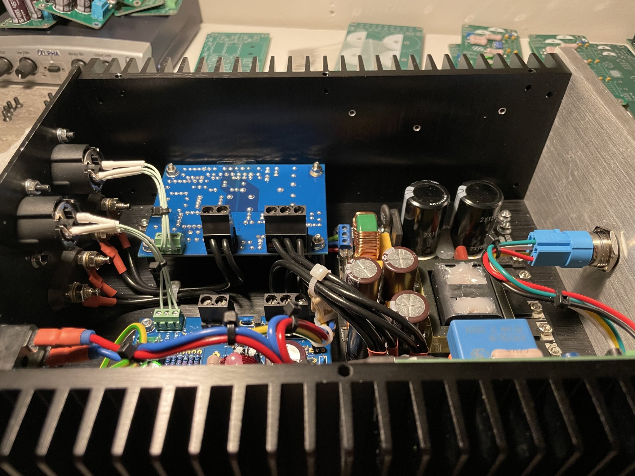

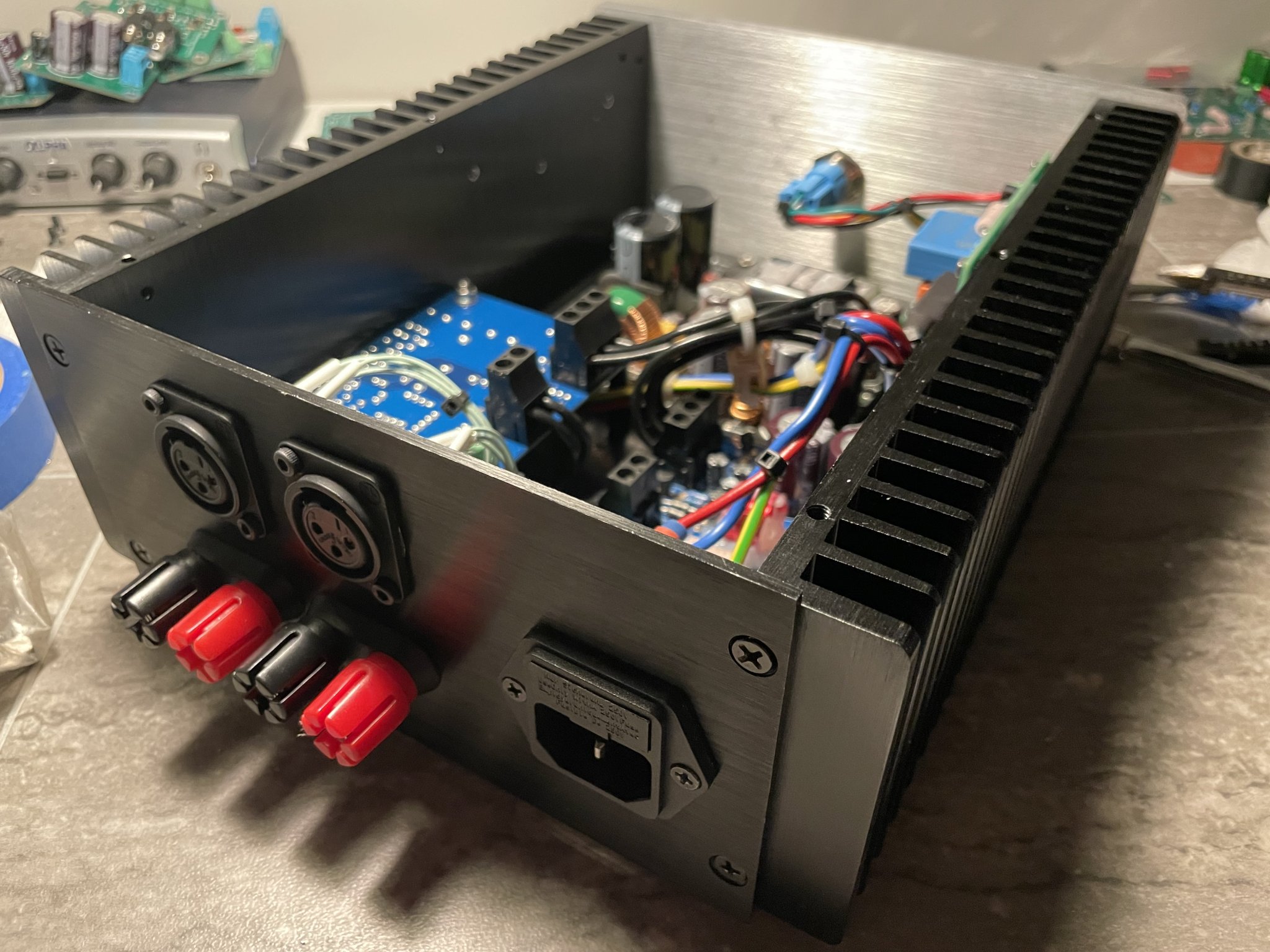

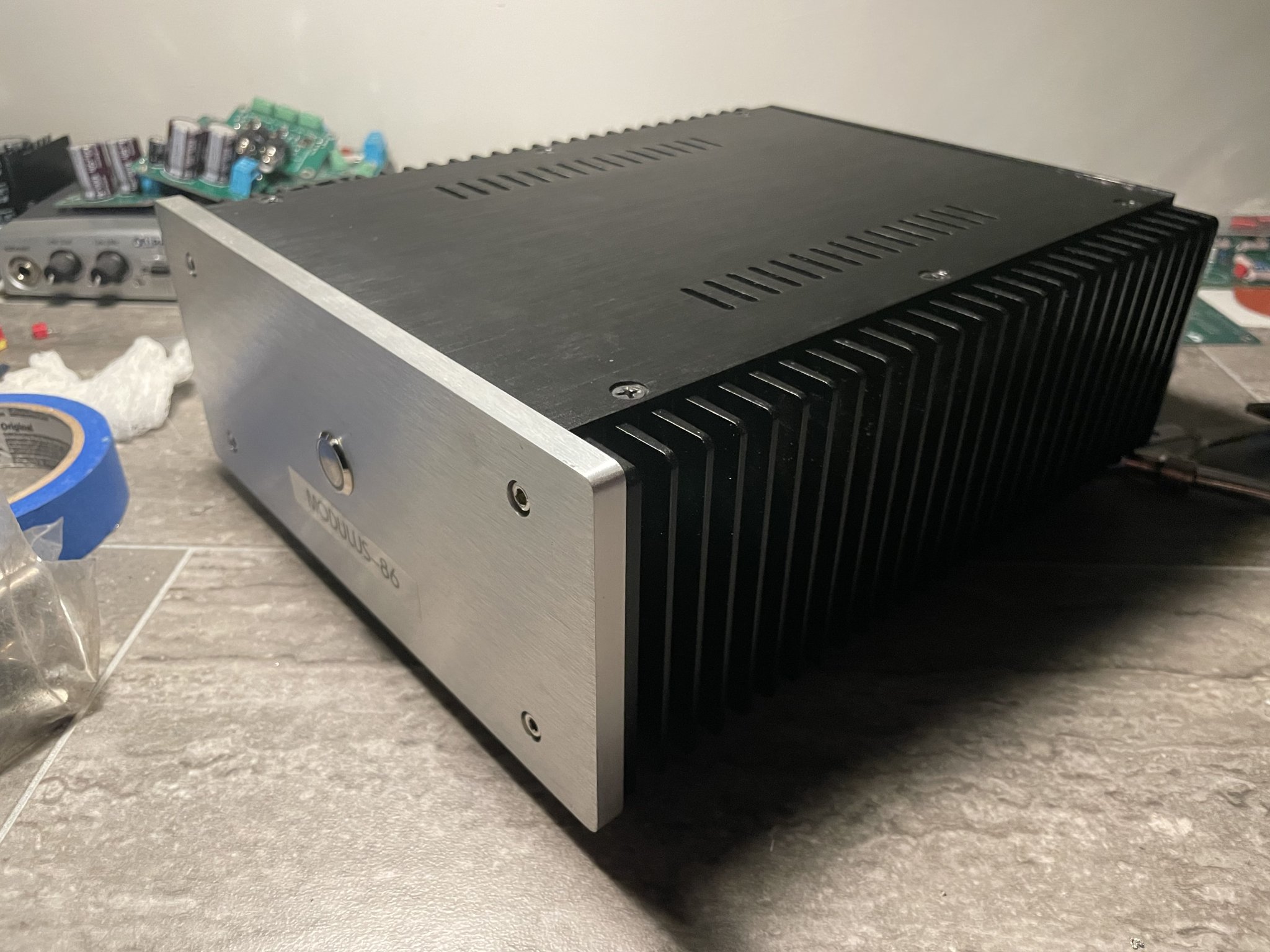

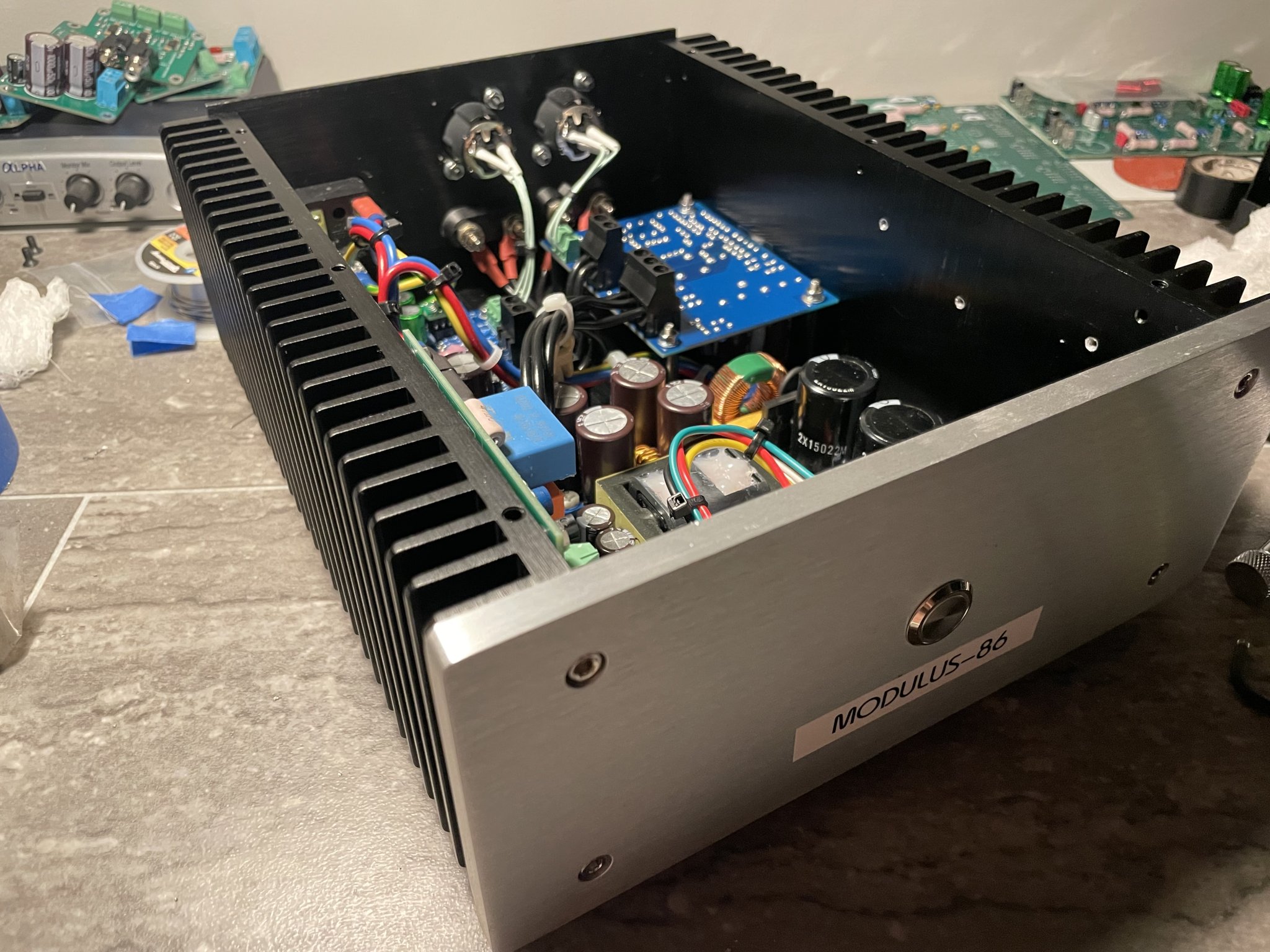

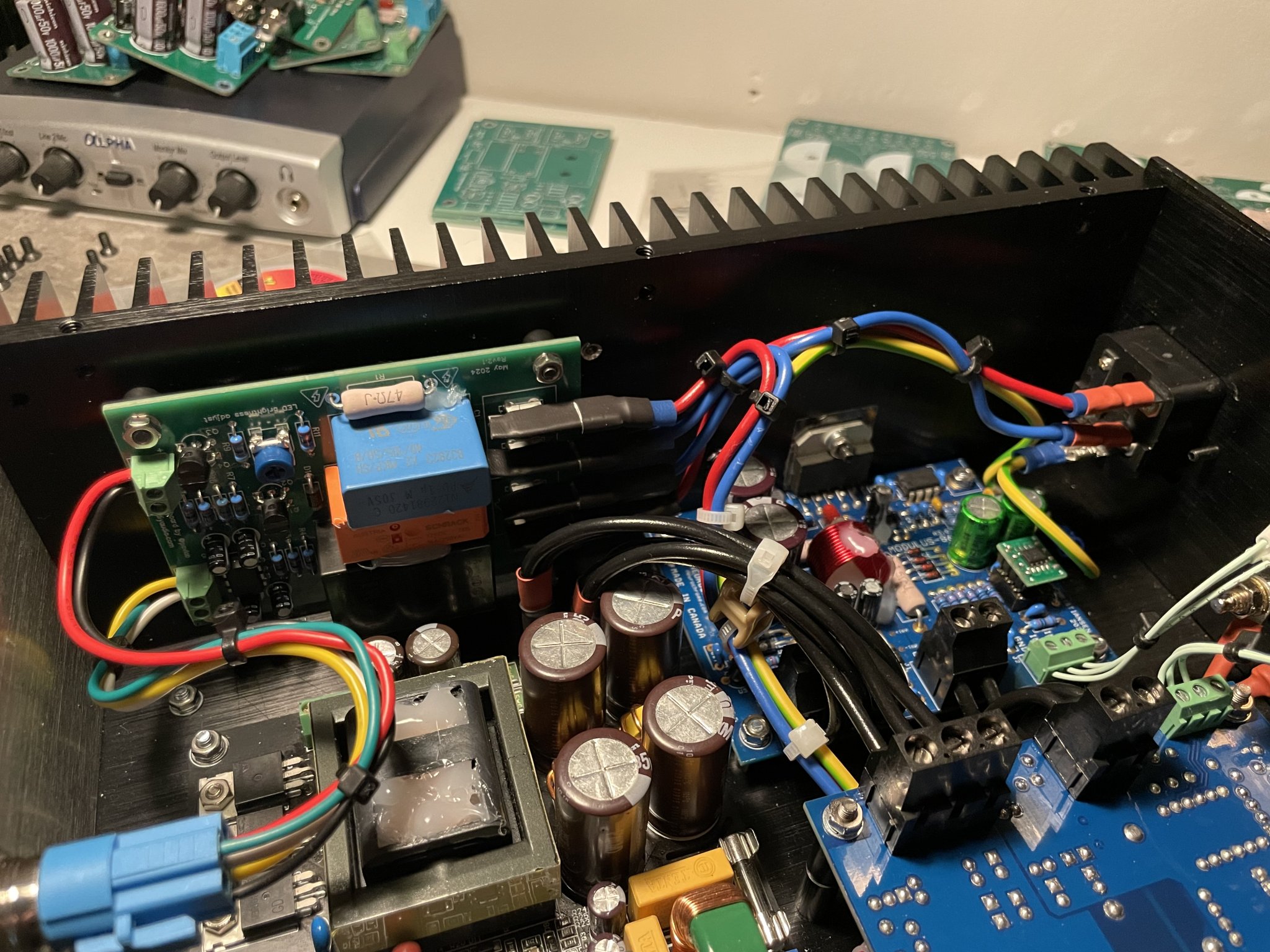

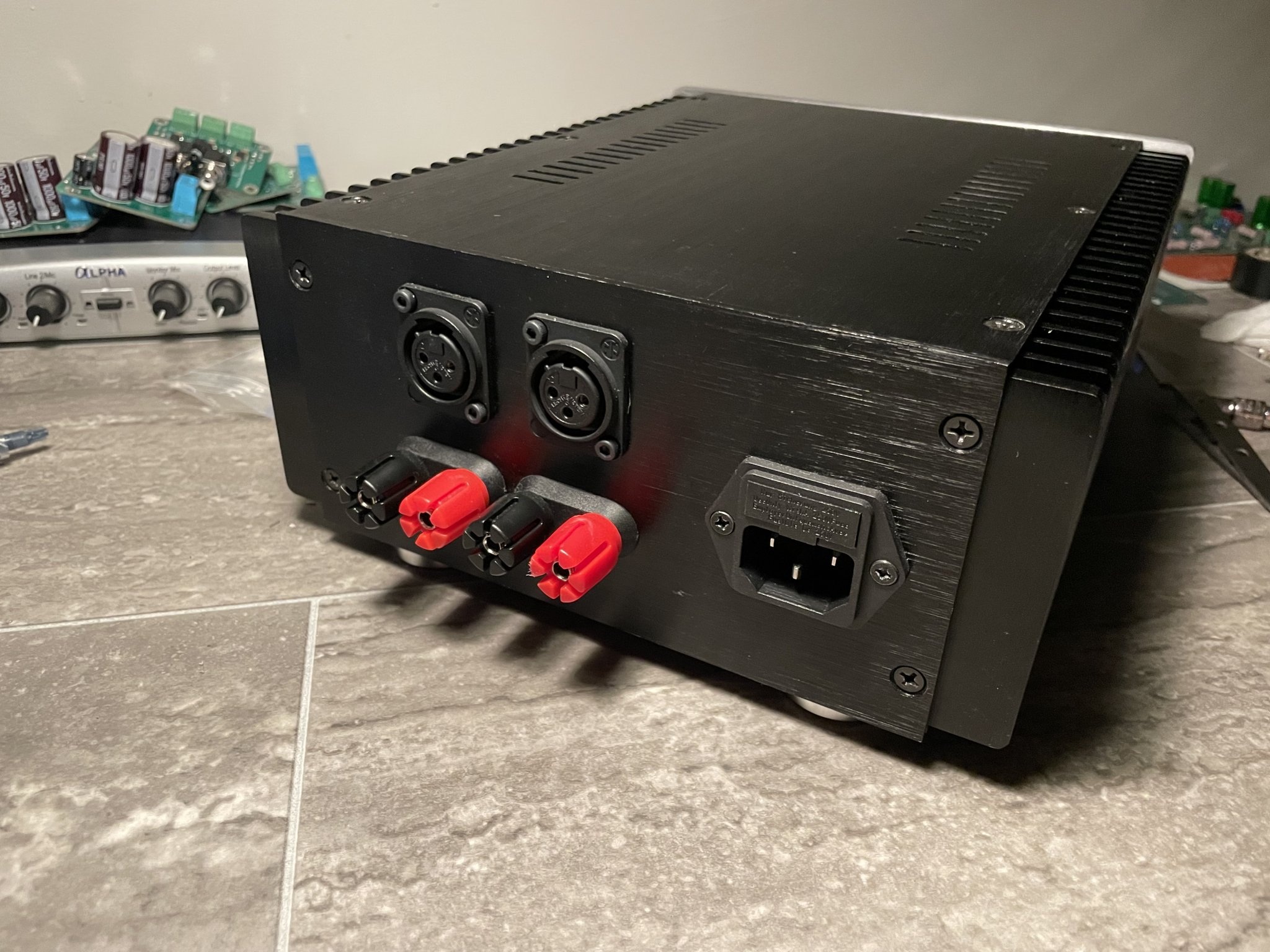

Finally finished my Modulus 86 build! I was able to fit it all in a nice compact case.
Added board that switches power on/off using NE555 and relay.
Input buffers are OPA1656 - I like how they sound.
Overall very detailed amp and most important for me - it sounds “musical”!!! while THD is 0.0002 or so!

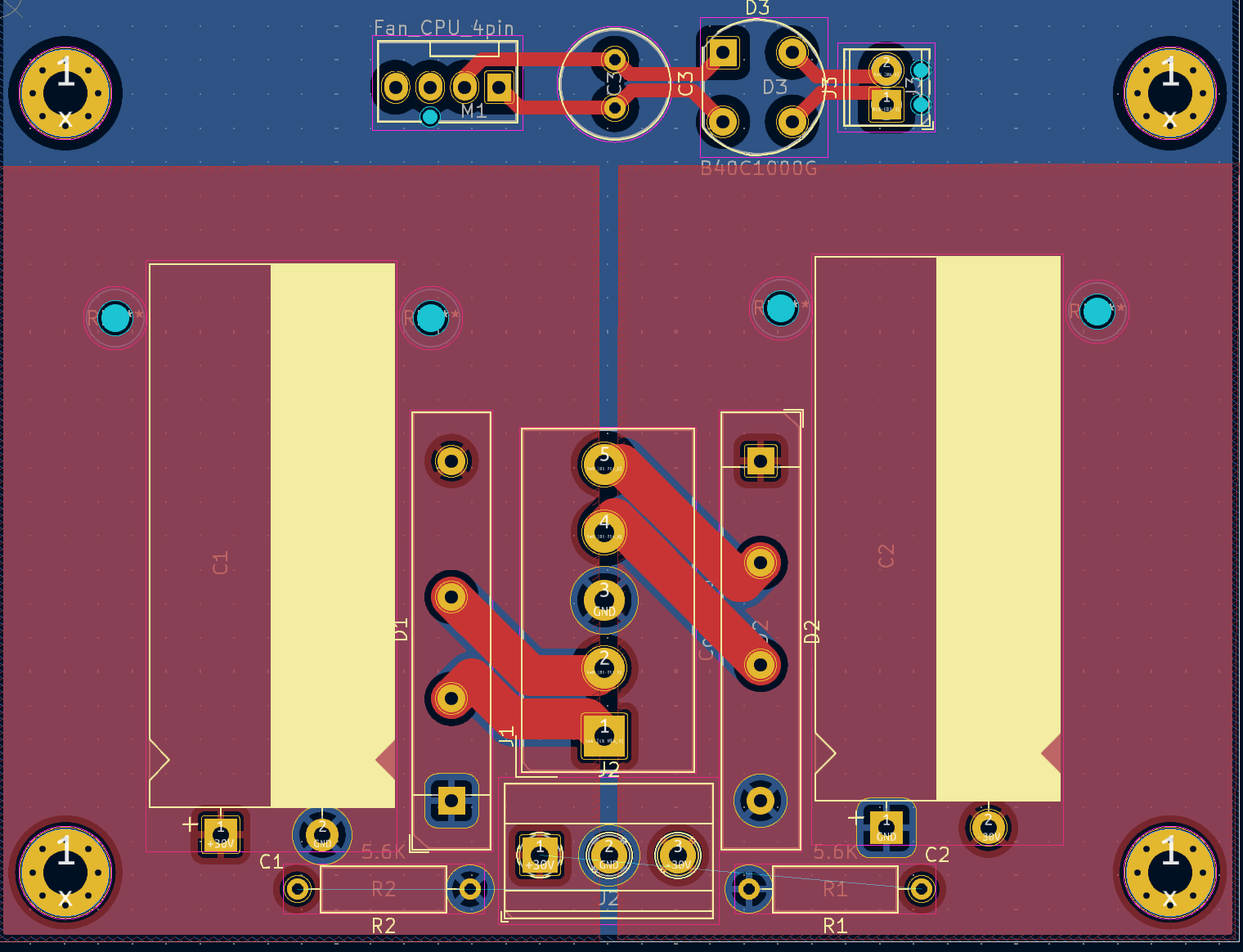

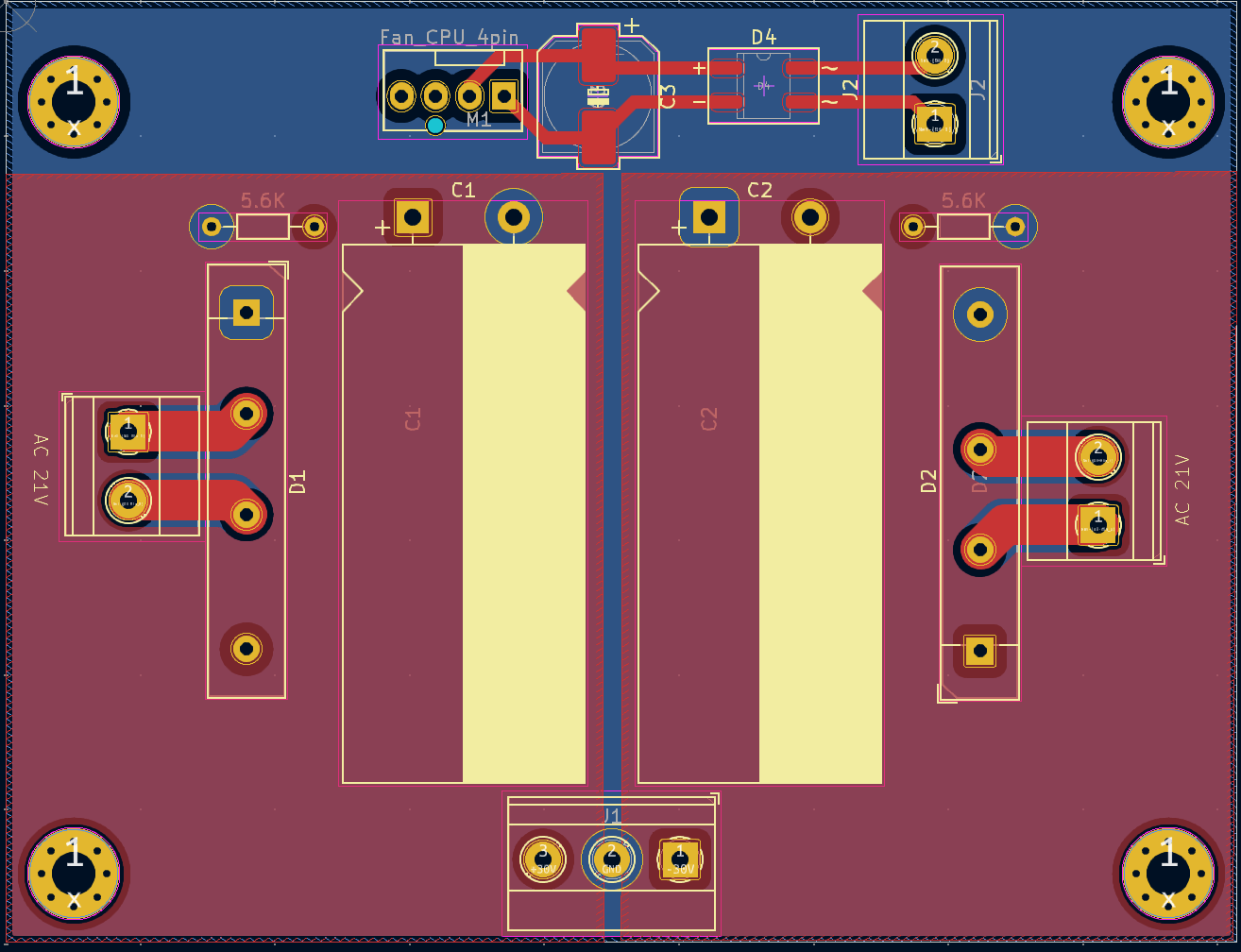

Please help me reviewing this PS board I designed for a single channel modulus-86.
A little explanation:
1. this should fit in a very tight space, that's why I used horizontal capacitors
2. I would like to use my active rectifiers that do not support center tapped operation, so I need a separate rectifier for both rails.
3. There is a separate little power supply for a fan on the top.
One thing I am pretty sure is missing is a chassis ground connection. I would love to get suggestions on where to place it.
Thanks in advance.

I suggest keeping the AC inputs together to minimize the amount of wiring to the secondary of the transformer.
I'd also use thermal reliefs rather than solid connections to the pours if you want any hope of being able to solder the components to the board.

Thanks, Tom. I thought that a pair of twisted wires above the board is better than two longish parallel traces on the board, but that would be an easy fix.
How about the chassis ground connection?
Is it ok, that the fan supply is not connected to any ground?

If you rotate C1 and C2 90º clockwise and move them to the left edge of the board you could put both rectifiers on the right along with their AC connections. Then either take the DC output along the left edge of the board or over by the AC input. That's probably the smallest loop area you'll find -> lowest coupling to the external world.
My thinking is this: The secondary current in the transformer is a spiky pulse train. That'll love to couple into stuff, so you really want to minimize the wiring to the transformer and keep it tightly coupled. The loop area from the rectifier to the caps is nice and tight due to the use of pours, but the input wiring could be tighter. I'd move the traces closer together. Even if you etch the board in your garage, you should have no trouble getting 15-mil (0.4 mm) spacing.
I'd follow AES48-2019 for the chassis grounding.
The fan supply can float. The fan doesn't care where ground is.

Thanks, Tom. Due to the tight and unusual space this thing needs to fit in, I don't want to change the orientation. I came up with this instead, trying to follow you. I placed the chassis ground connection between the ACs.
I'm thinking you'll want larger footprints for the two 5k6 resistors. They'll be power types.
I'd play with the rotation of D1 and D2. I bet if you rotate them 90º you can make an even tighter layout as the distance (and, thus, loop area) to the caps will be reduced.
I would add four mounting holes large enough to feed a wire tie through so you can tie the top ends of the caps to the PCB.
You'll probably find that a leaded/PTH cap for C3 will be smaller than the SMD one used now. D4 could be a WOG type (leaded/PTH).
Where's D3? If no D3, re-annotate the board.
I know I said to reduce spacing on the AC lines. Just make sure that you don't run them at minimum space. If your manufacturer supports, say, 5-mil spacing run the lines at 8-10 mil spacing. Never push the process unless you have to.

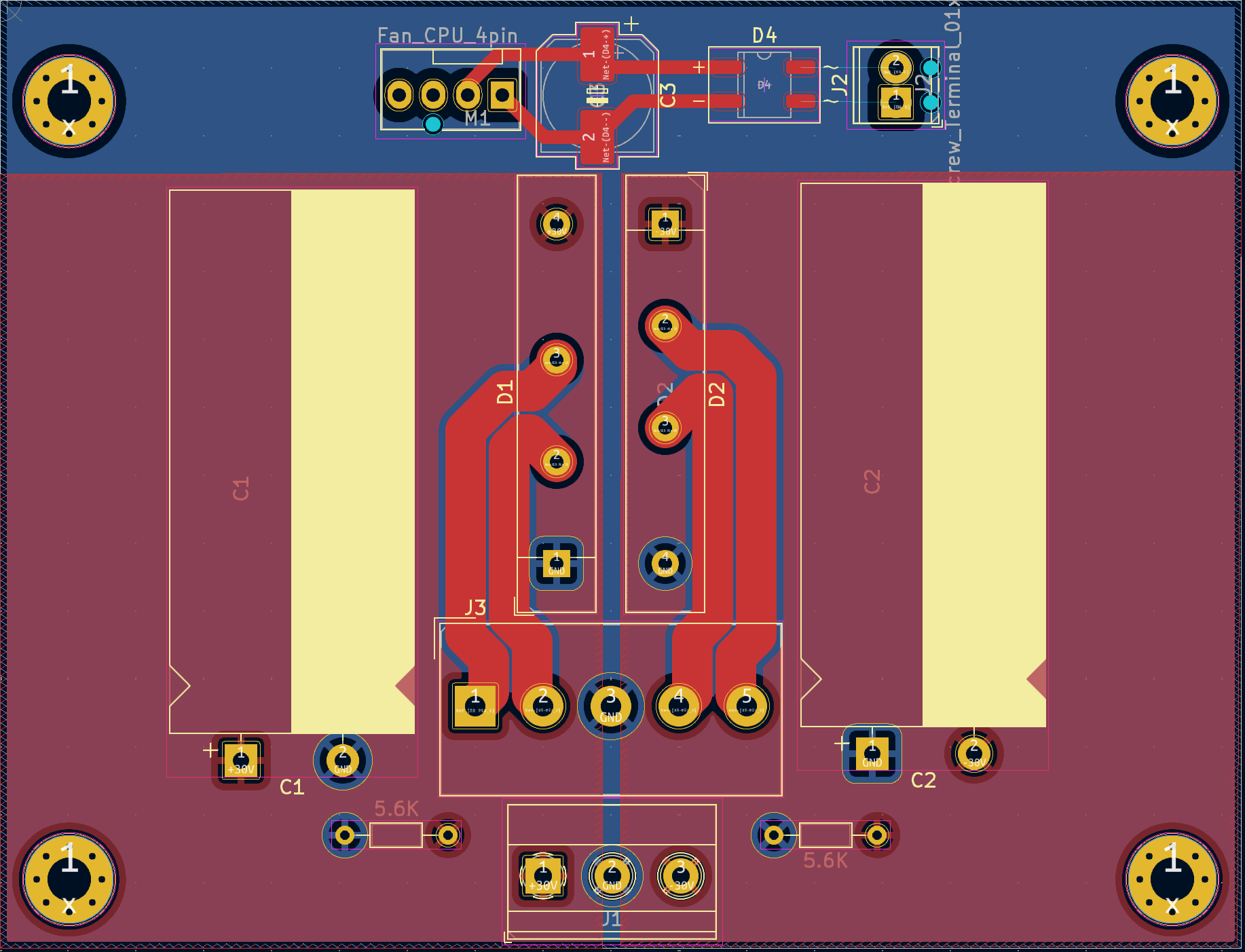

True, noted, corrected. Thanks.I'm thinking you'll want larger footprints for the two 5k6 resistors. They'll be power types.
This is what I can not do unfortunately. I will try to fit this is a tube, and my rectifier pcbs are too tall for thatI'd play with the rotation of D1 and D2. I bet if you rotate them 90º you can make an even tighter layout as the distance (and, thus, loop area) to the caps will be reduced.
Great idea!I would add four mounting holes large enough to feed a wire tie through so you can tie the top ends of the caps to the PCB.
I felt so good about doing it mostly SMD. I can live with a PTH solution too.You'll probably find that a leaded/PTH cap for C3 will be smaller than the SMD one used now. D4 could be a WOG type (leaded/PTH).
Done.Where's D3? If no D3, re-annotate the board.
I checked the manufacturer, they support 150um, which is less than 6 mil. The default setting was 7.87mil, I think I will go with it.I know I said to reduce spacing on the AC lines. Just make sure that you don't run them at minimum space. If your manufacturer supports, say, 5-mil spacing run the lines at 8-10 mil spacing. Never push the process unless you have to.
I like that, thanks! Here is a version with all the suggestions that I could incorporate:I'm thinking you could move the bridges apart, rotate that connector and put it in between the bridges - that would make for shorter traces.
