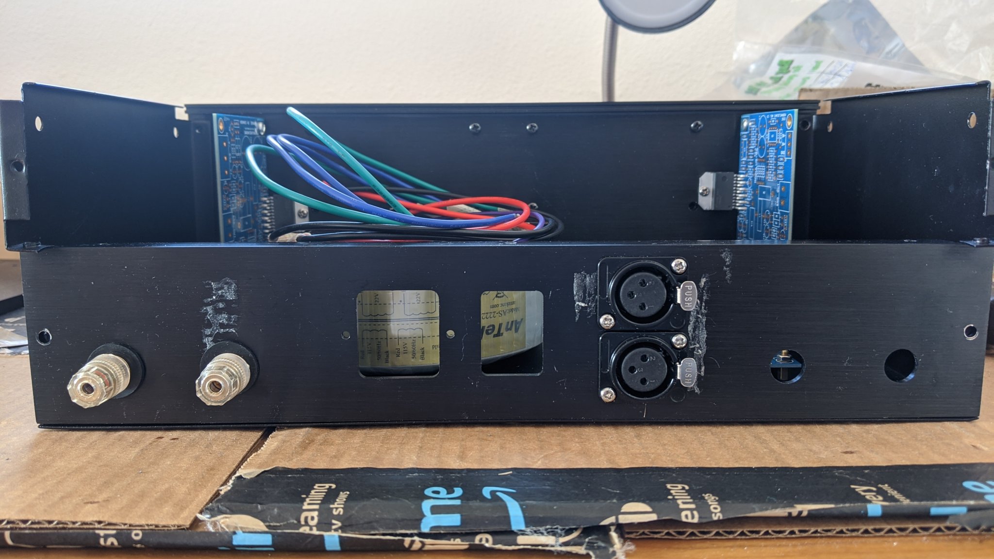

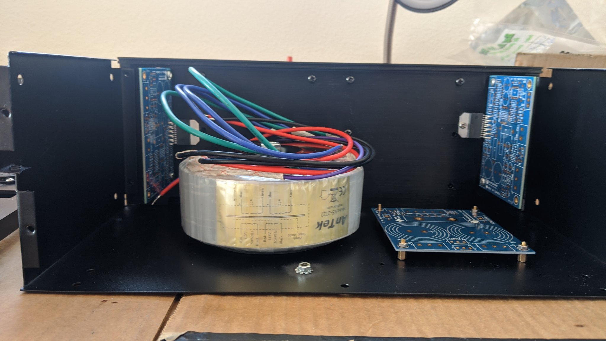

man a bolt and a few more nuts(2nd ground) then i think i can start putting the power/modulus boards together
ran into real problems when mounting the XLR jacks. i attempted to make a template for the large hole and the 2 mounting holes, but when it came time to screw it on, everything was off. had to shift both plugs a 1m to get the mounting screws to seat, its totally ugly and im sad it didnt work out well.

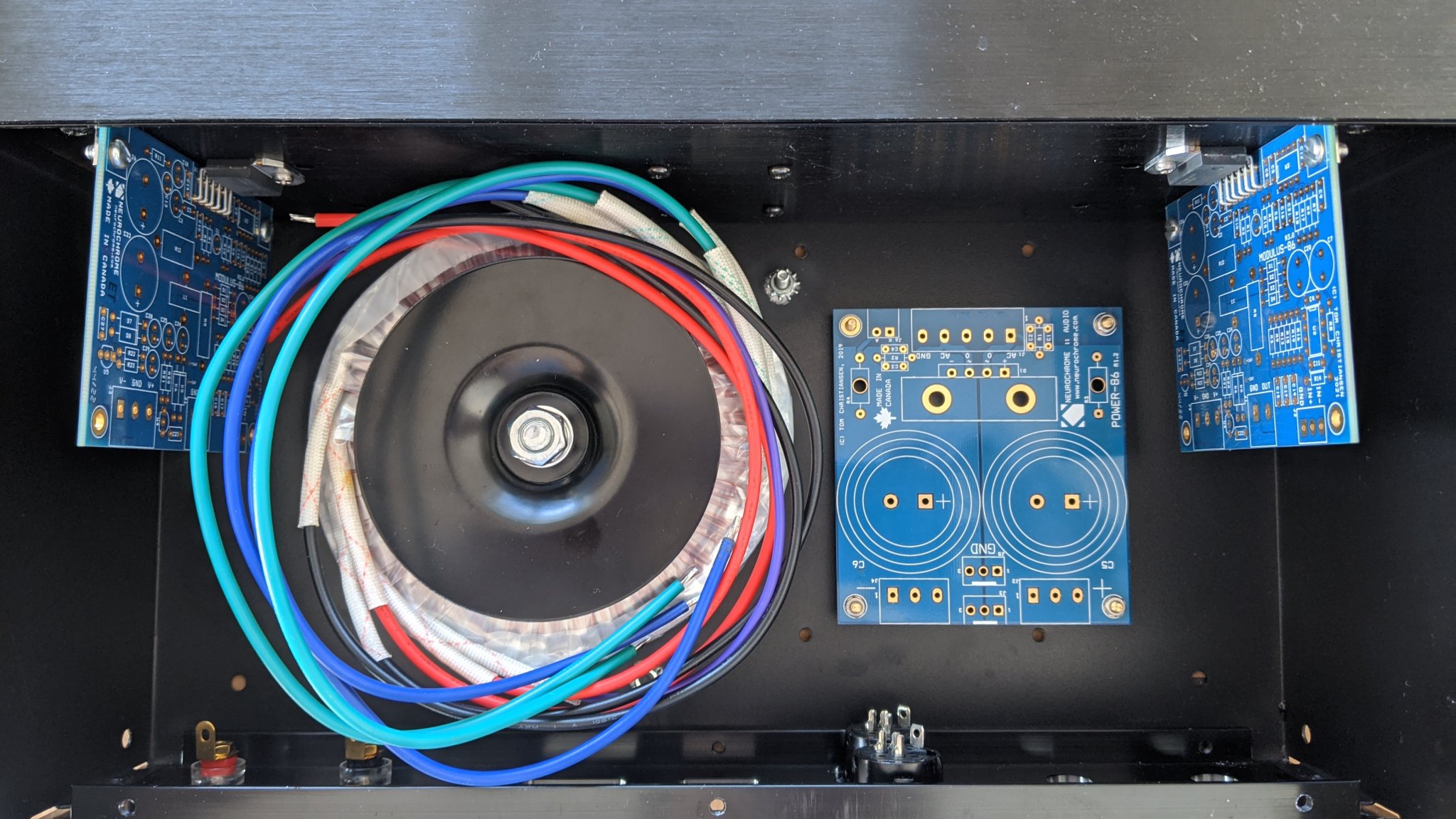

making the power 86 mounts has a small clearance issue with the 4 posts, its way too tight. i used the power 86 board as the template, but when i drilled the holes, something went went out of spec.
hopefully just monitor issues going forward
thanks @tomchr for the suggestion of 2 ground posts, appreciate your help through this process
That will completely fade after you’ve completed the amp and are listening to it. :yes: Who cares what the back and underside look like when you almost never see it? I’ve had some shameful chassis mishaps recently and forgave myself once the device was sending music out from within its electrical voodoo innards. :clown:
