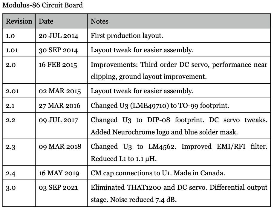

Is there a post detailling the changes in v3 or a comparison of performance to older versions? ThanksThere are plenty of completed Modulus-86 in this thread. I thought yours was the first Rev. 3.0, but it turns out mkrawcz beat you to it: Post #5691.
Oh, probably...
Modulus-86 Rev. 3.0 features a complete redesign of the front-end of the amp. I eliminated the THAT1200 as that limited the noise performance of the circuit. I also took out the DC servo as I was able to get stellar DC specs by other means. That lowered the build cost.
I also changed the power stage to be a differential amp (balanced in, single-ended out).
The end result is an amp with even better THD+N (due to the reduction in +N) and lower build cost. That's Rev. 3.

Here's the full revision history. This is from the Modulus-86 Rev. 3.0 design documentation:

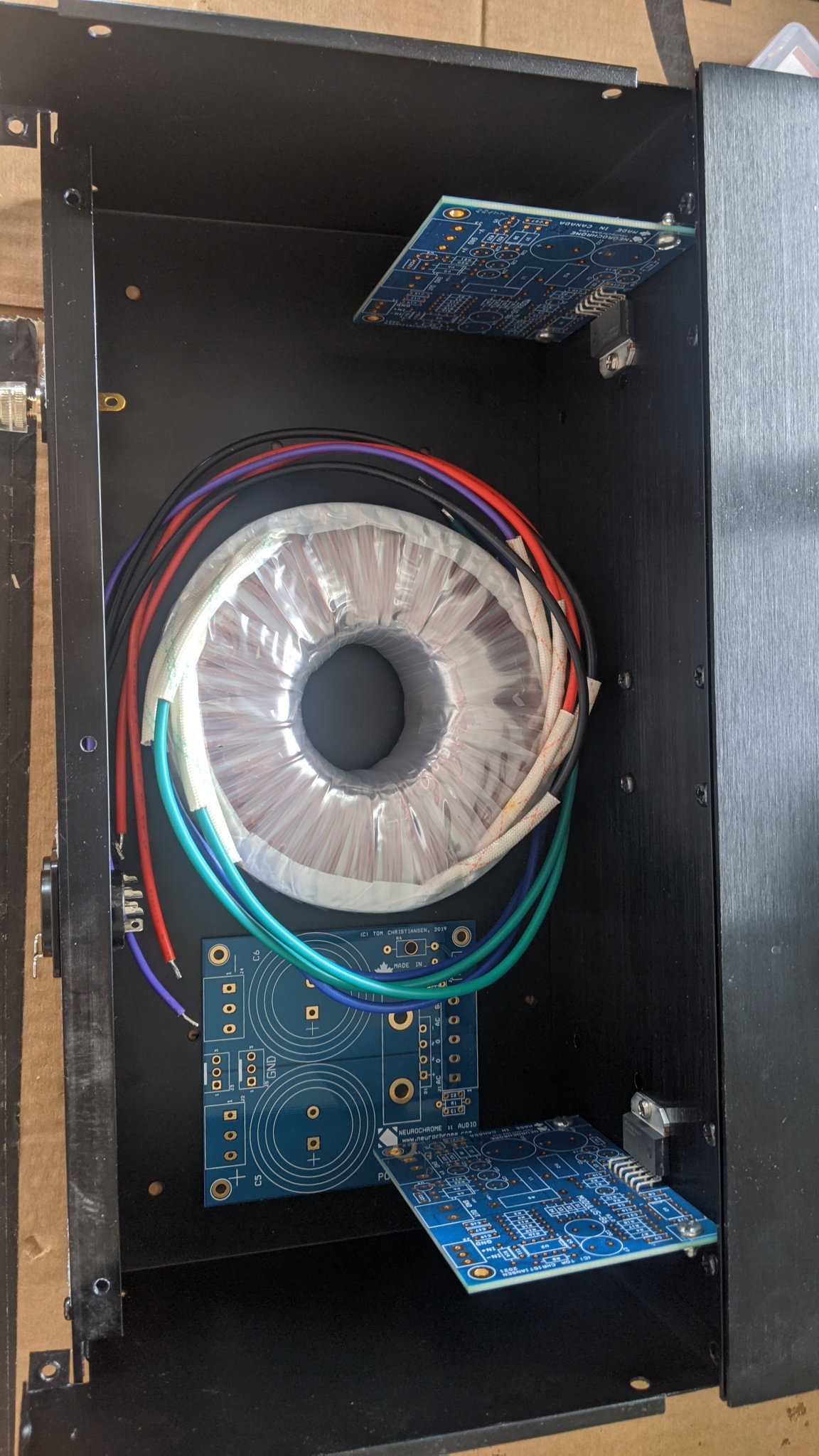

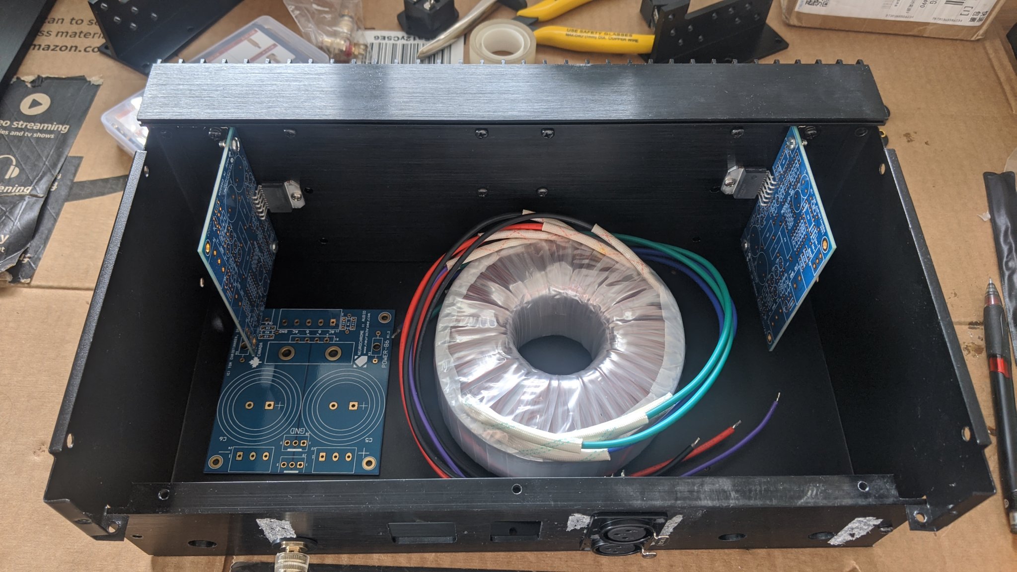

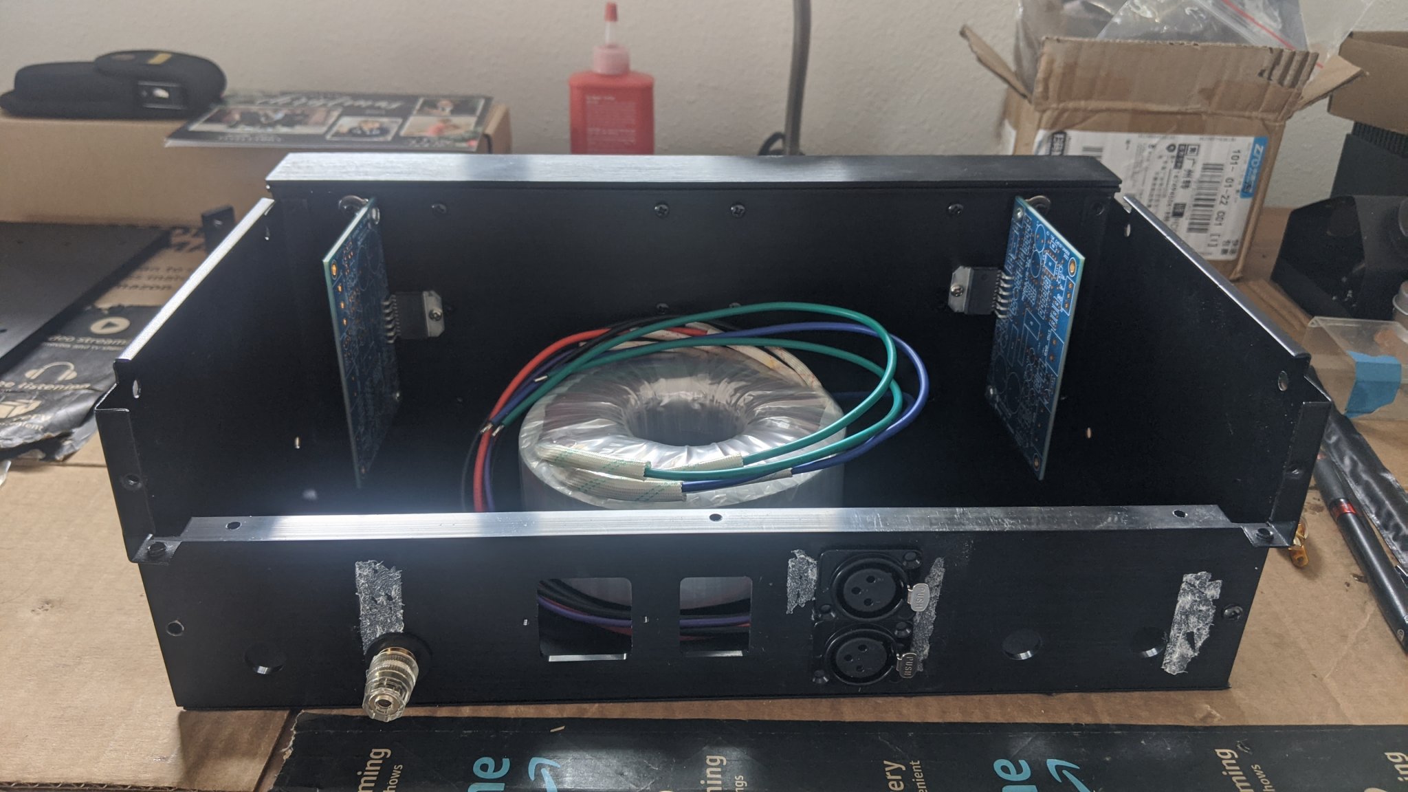

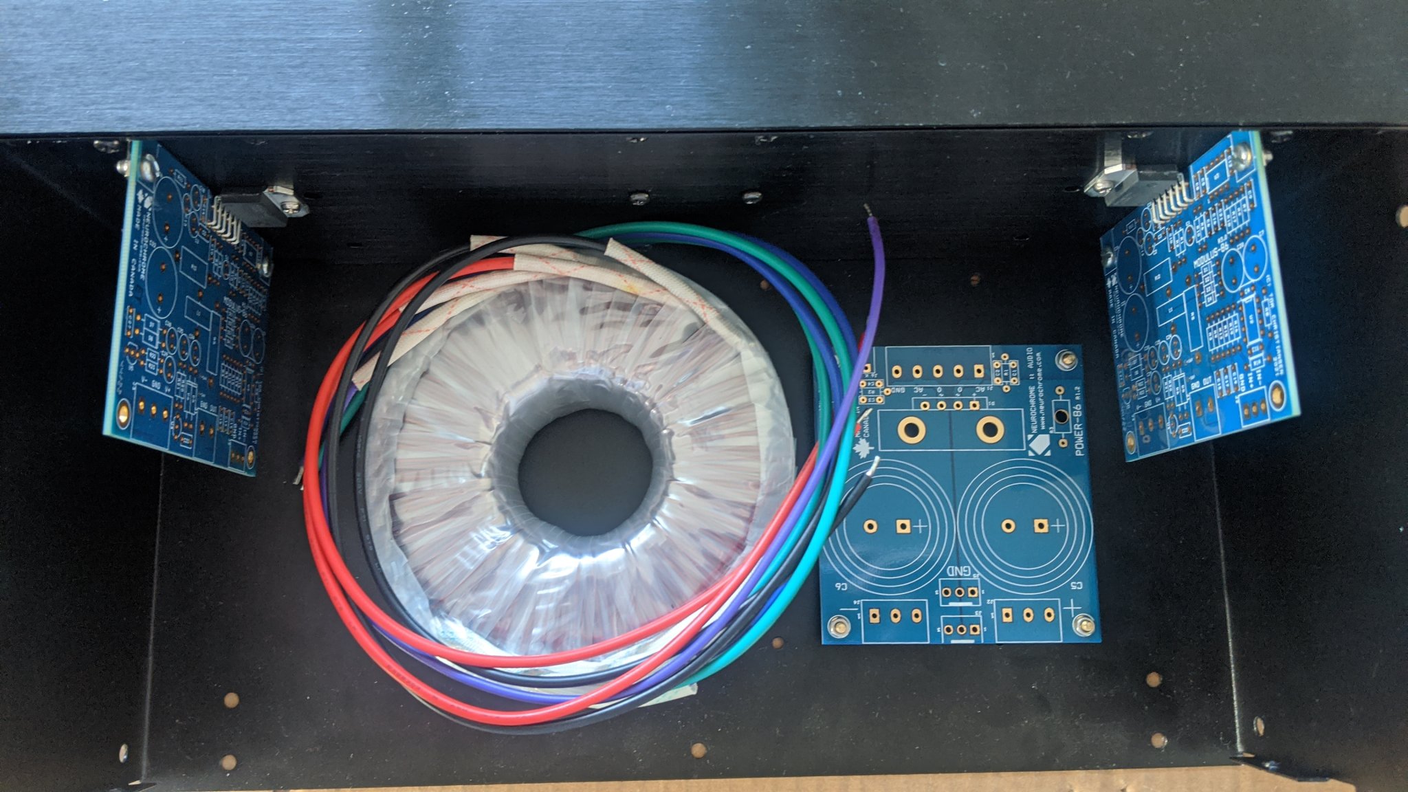

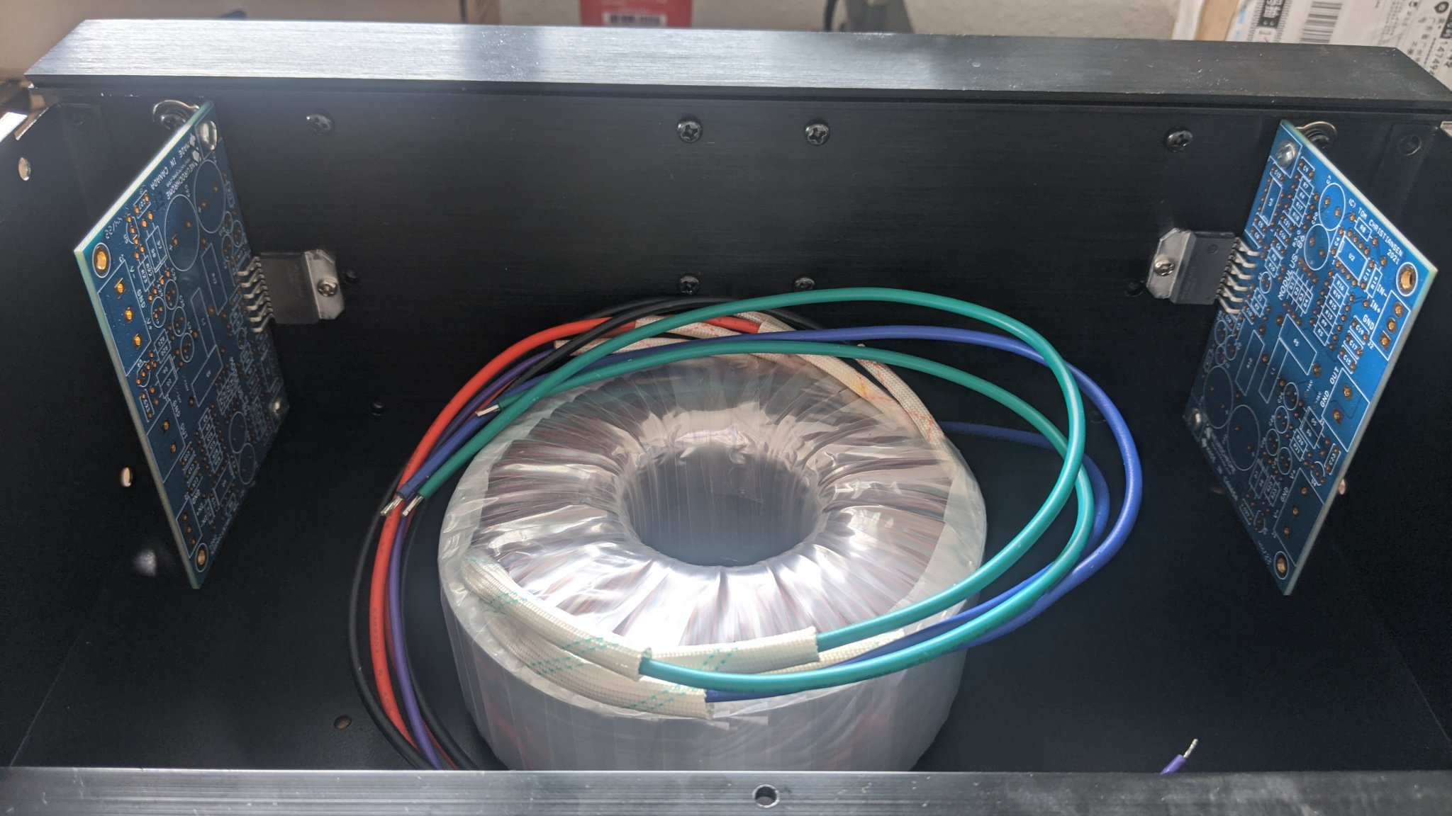

i made some progress, thank you @tomchr and @asuslover for your advice. i had to get some neopreme washers for the audio jacks to fit, a drill/tap set, cutting oil, a file, and my uncle had a drill press i was able to borrow. i think i do the rest with hand tools now.
i was gettng frustred workign with hand tools and their speed, so i just went the shortest route. since transformer is in the center, the input is right next to it. i dont want to be making those holes again(too late now... lol) so hoping for the best.

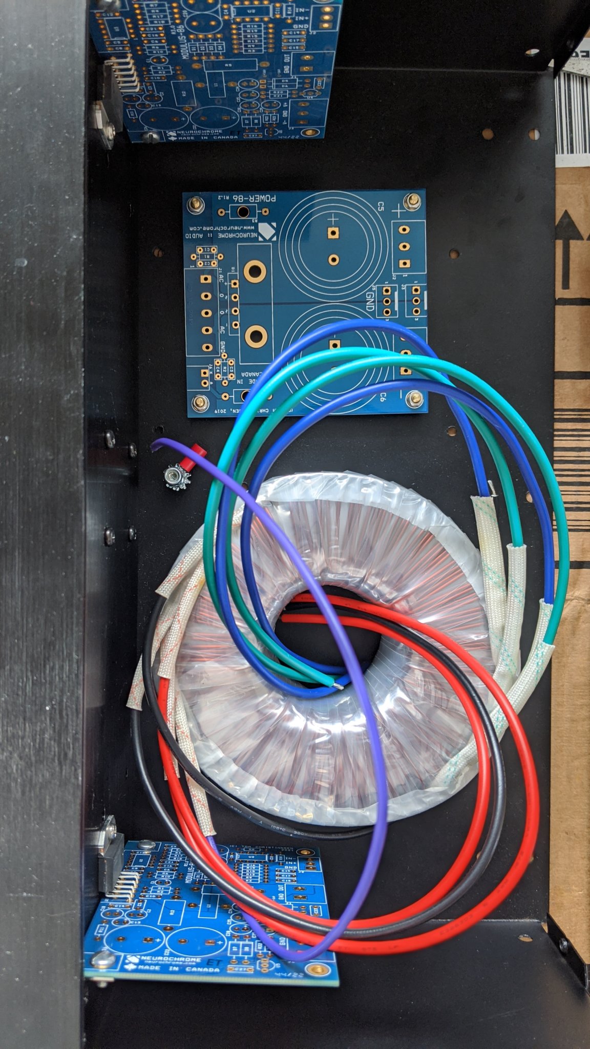

thinking about relocating the power86 to the left so the LED power light has a shorter run, theres a place to run a LED to the front of the chasis on the left side. i need to check for clearance between the mod86 and the power 86 now.

I don't have a great sense of depth in the pictures, but it looks like the components on the Power-86 will interfere with the Modulus-86 board. I would scoot it as close to the rear panel as possible and possibly rotate it 90º. Keep the rectifier away from the inputs to the amp.
You could also possibly scoot the transformer further to the right and fit the Power-86 in next to it.
The connections to the power LED would be at the absolute bottom of my list of things to worry about.
Tom
Tom
thanks for the advice tom. i remember you mentioned you want to keep the amplifier parts away from the inputs. so the rectifier is where we can maximize that layout i moved things around to do this. about 7 more holes to drill and i can start mounting everything!
Actually, it's the rectifier that you want away from the inputs. The transformer wiring should be away from the inputs as well.i remember you mentioned you want to keep the amplifier parts away from the inputs.
The issue there is that the transformer wiring and rectifier carry some pretty spiky currents, especially when the amp is idle or providing low output power. That's because the reservoir capacitors don't discharge much so the conduction angle (i.e., the proportion of the sine wave cycle where the diodes conduct) becomes tiny and, thus, the charging current very high. That current can couple inductive into stuff.
Inductive coupling is proportional to the loop area, so keep that small. That's why I recommend that you bundle the transformer wires.
It looks like you've found a good compromise. I'd go with that.

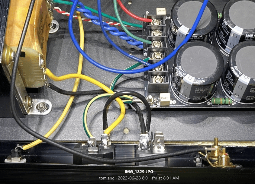

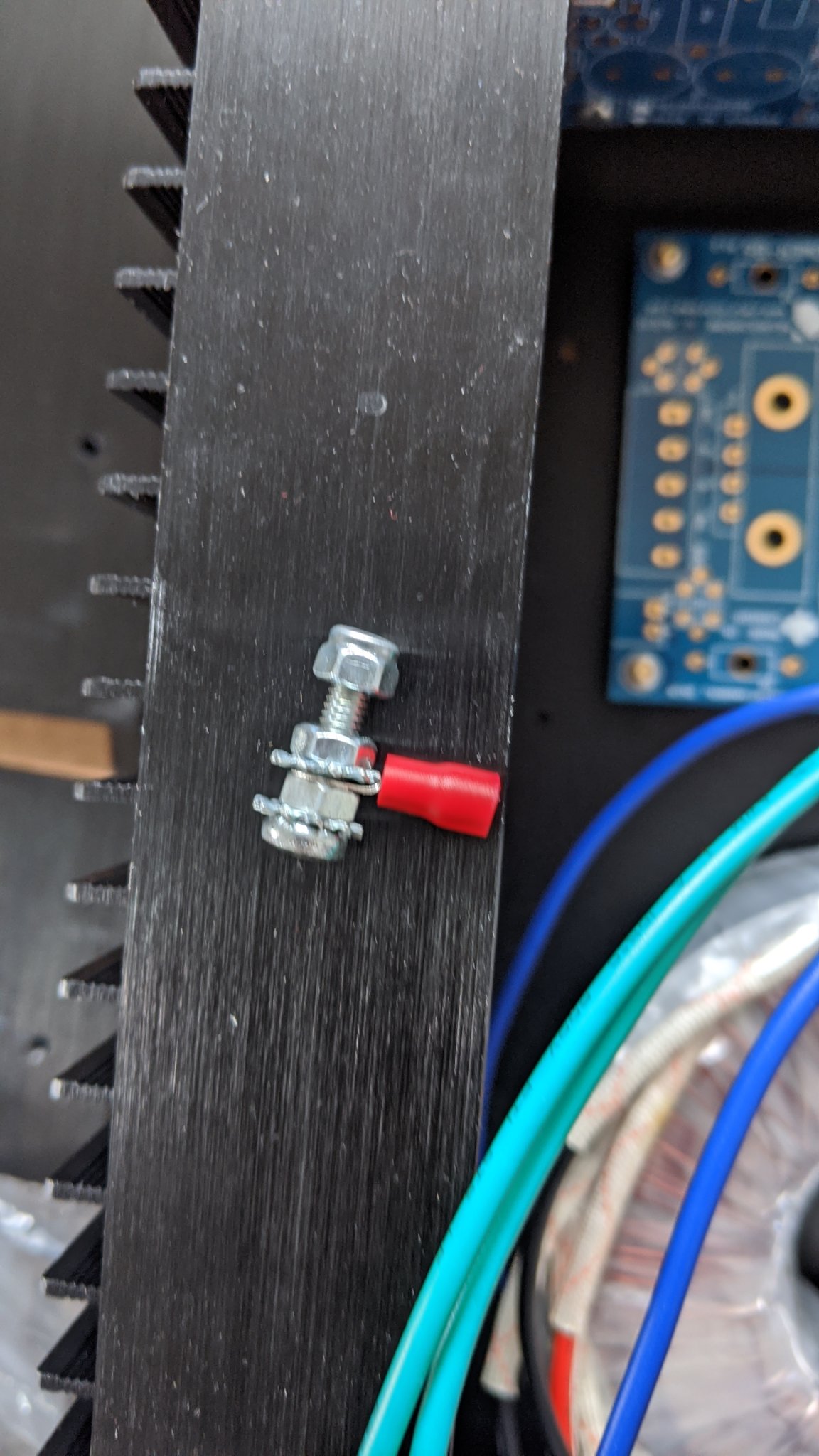

i am going through the content for grounding, is there a difference using a mounting hole on the power 86 for ground vs a dedicated bolt/nut on the chassis?
can i use a corner of the power 86 mounting to do the same as the ISS above? or better yet, is there a best practice?

Read part 7 of ESP’s doc on grounding. The whole article is excellent, but part 7 gives you the details you need. I quote:
Of course this is DIY and you are free to do what you want. But I always think about safety issues particularly if I sell the amplifier or if something gets dislodged during shipping. I strongly recommend using a locknut to fastidiously adhere the chassis ground lug to the chassis.

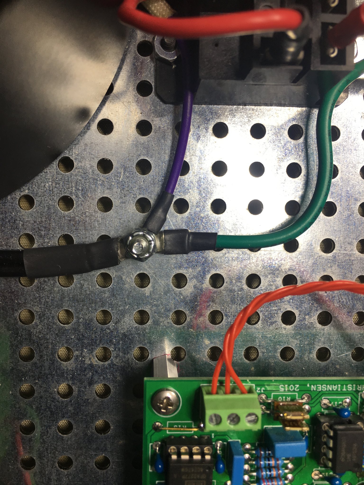

Here is an example from one of my previous builds:

Do not use the earth connection as mounting for any other panel or component - it must be dedicated to the task of providing a safety earth point. If a component mounting bolt is used, at some stage it may be disconnected by a service (or other) person, which means that the apparatus is unsafe until everything is (hopefully) put back where it belongs - this does not always happen.

The mains protective earth terminal should go directly to a solder lug mounted directly on the chassis, secured with a machine screw and lock nut. The point of this is to ensure that if a mains live connection ever comes into contact with the chassis, the fuse will blow before the user is electrocuted.
EMI ground returns, input ground references, etc. can be connected however you'd like. In some of my builds I use a solder lug mounted at the ISS as the ground return for the electrostatic shield in the power transformer. The purpose of the electrostatic shield is to capacitively couple any RF energy from the mains to ground. It is not a safety thing. The important piece there is that the connecting wire is as short as practical. In my case that meant using the mounting screw for the ISS.

i went to the hardware store i got a bolt with some locking hardware. im not sure where is a good place to put the ground yet. im leaning towards the IEC plug so its closer to the mains, rotate the transformer so the shielding wire is closer as well
