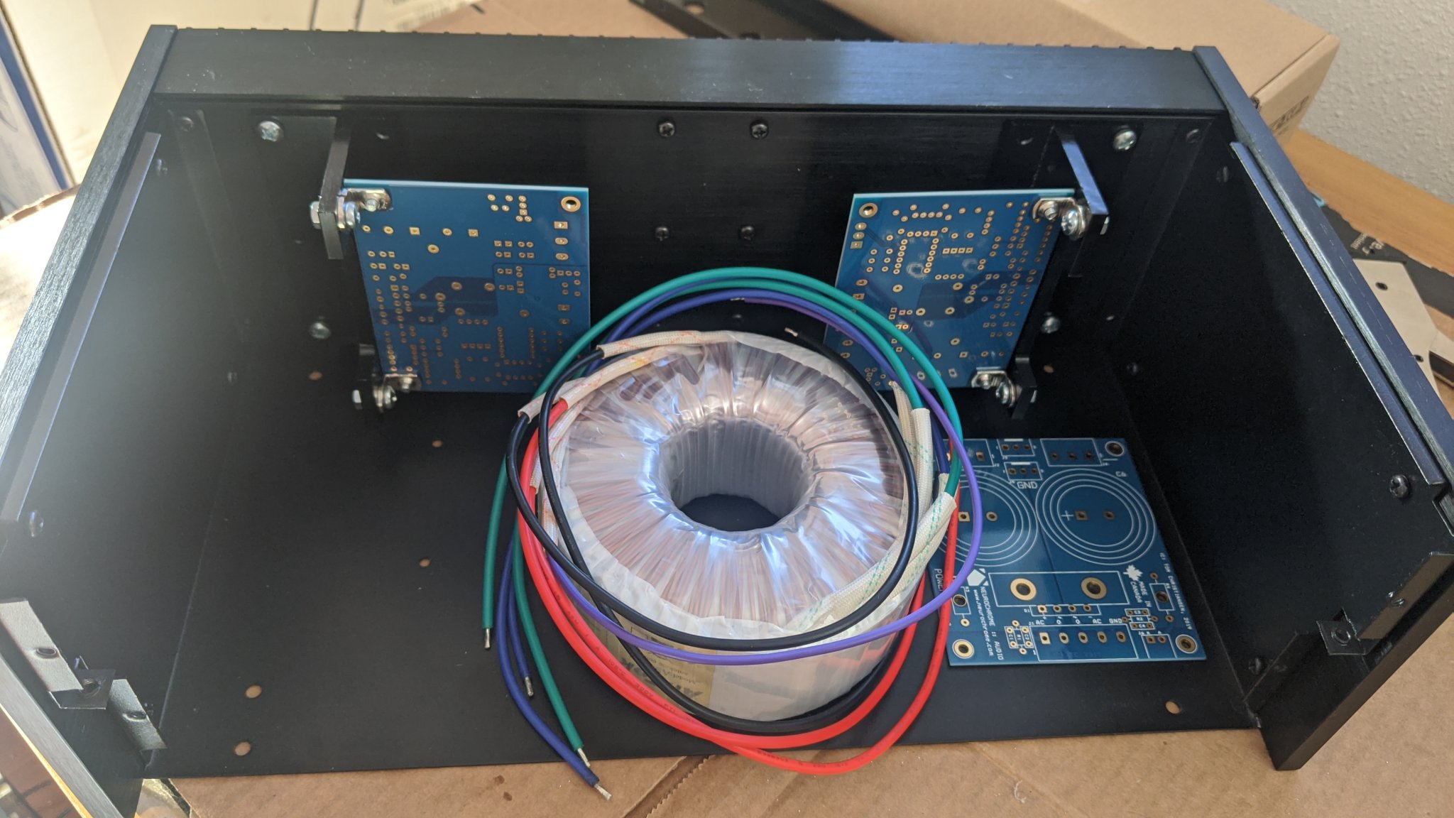

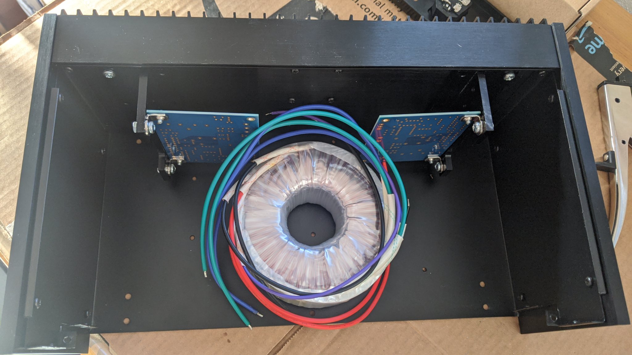

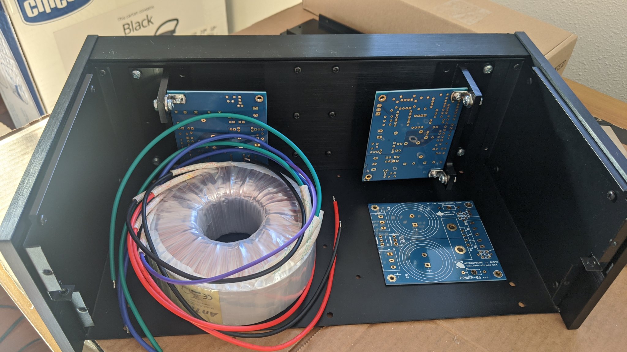

wow i had no idea i would be stuck in limbo when it came to working on this build. i have a number of to-dos still.
had to wait 45 days before the mounting brackets came to even start mounting the boards.

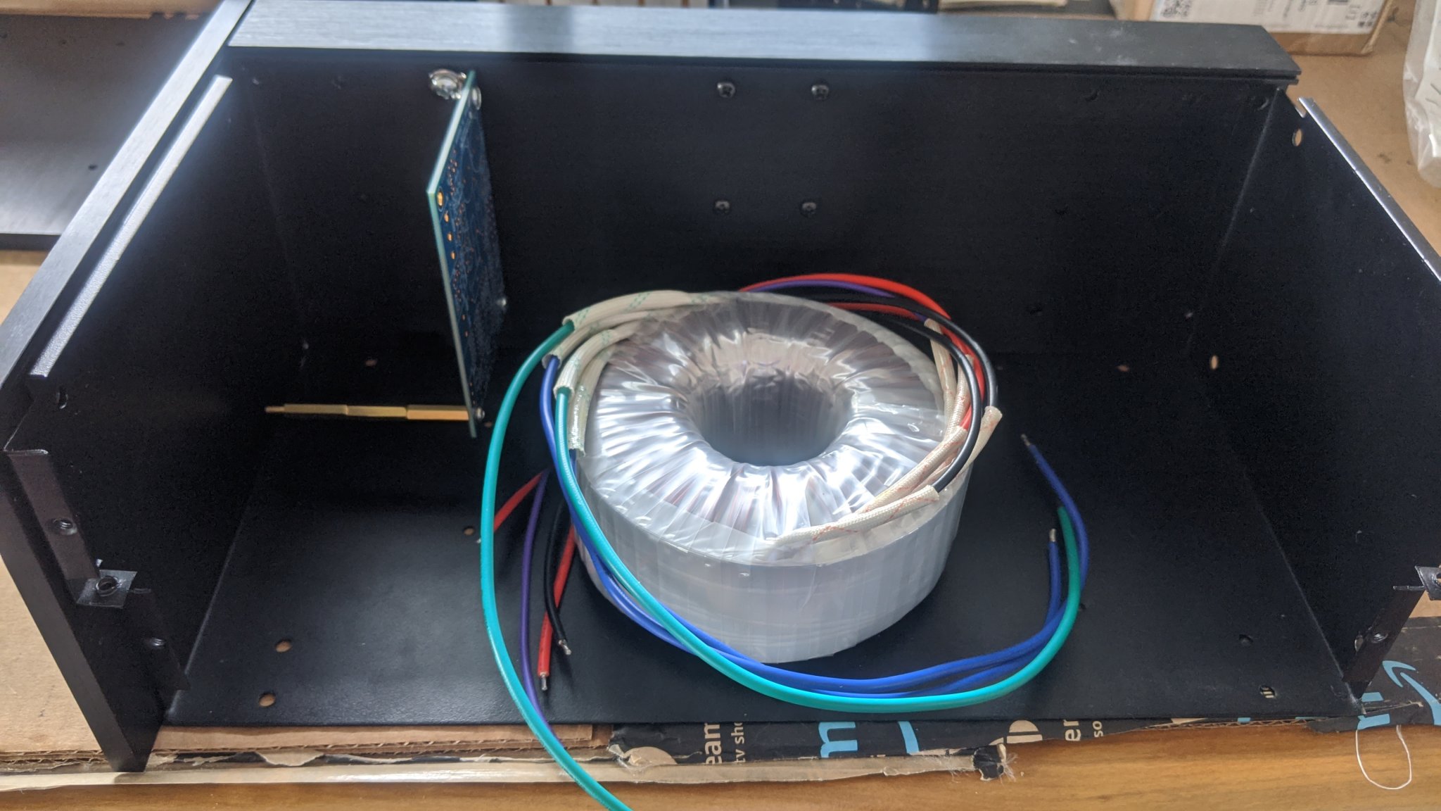

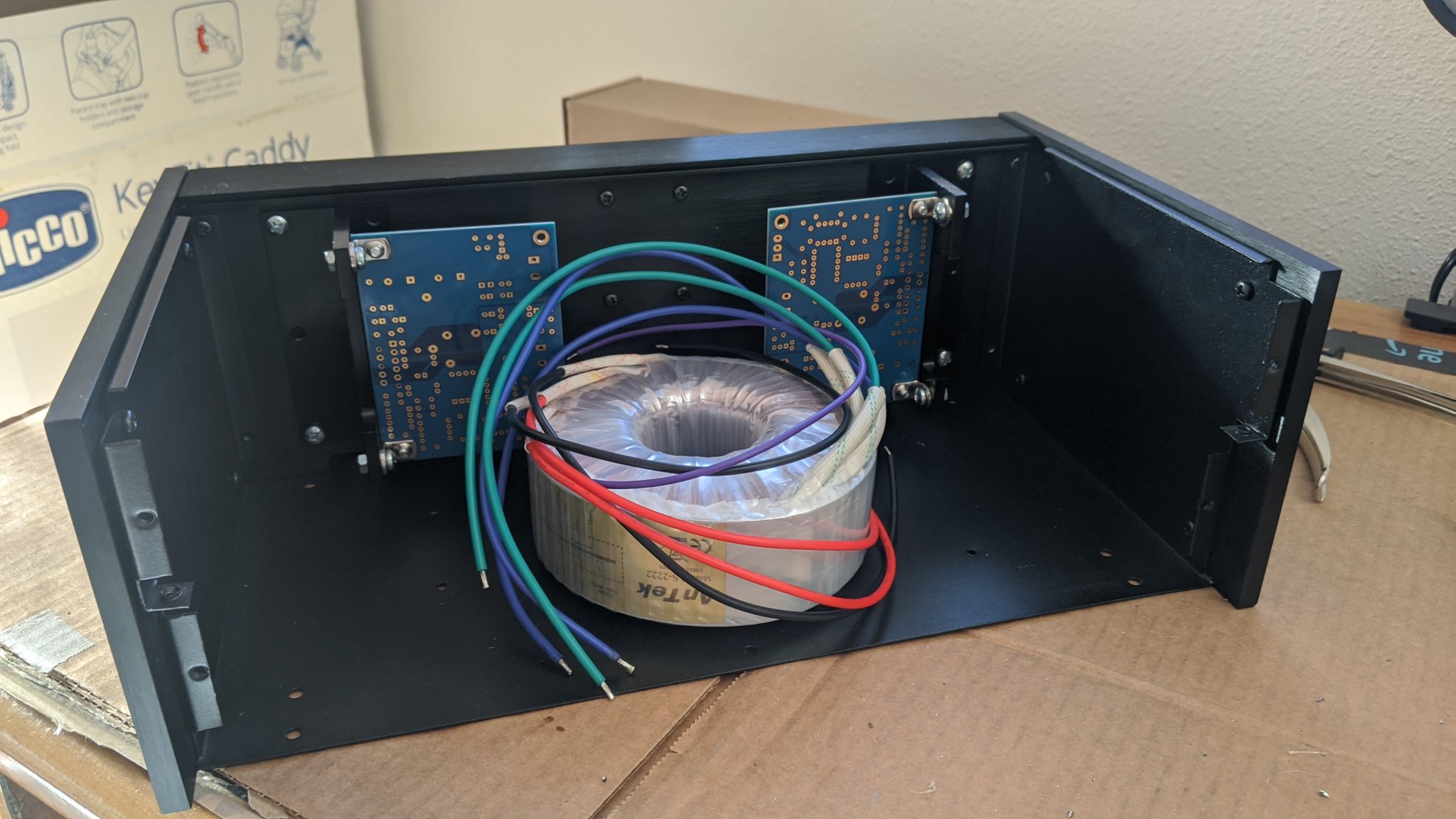

the toroidal transformer is way bigger than expected, but i think i got space. I want to center it to keep the weight centered lol
now i understand why some builds takes months or years for some to finish!

Dang! Is that a 500 VA type?the toroidal transformer is way bigger than expected, but i think i got space. I want to center it to keep the weight centered lol
Tom
i bought the AS-2222 - 200VA 22V Transformer. i went over to check the label on the transformer to double check too lolDang! Is that a 500 VA type?
Tom
@asuslover

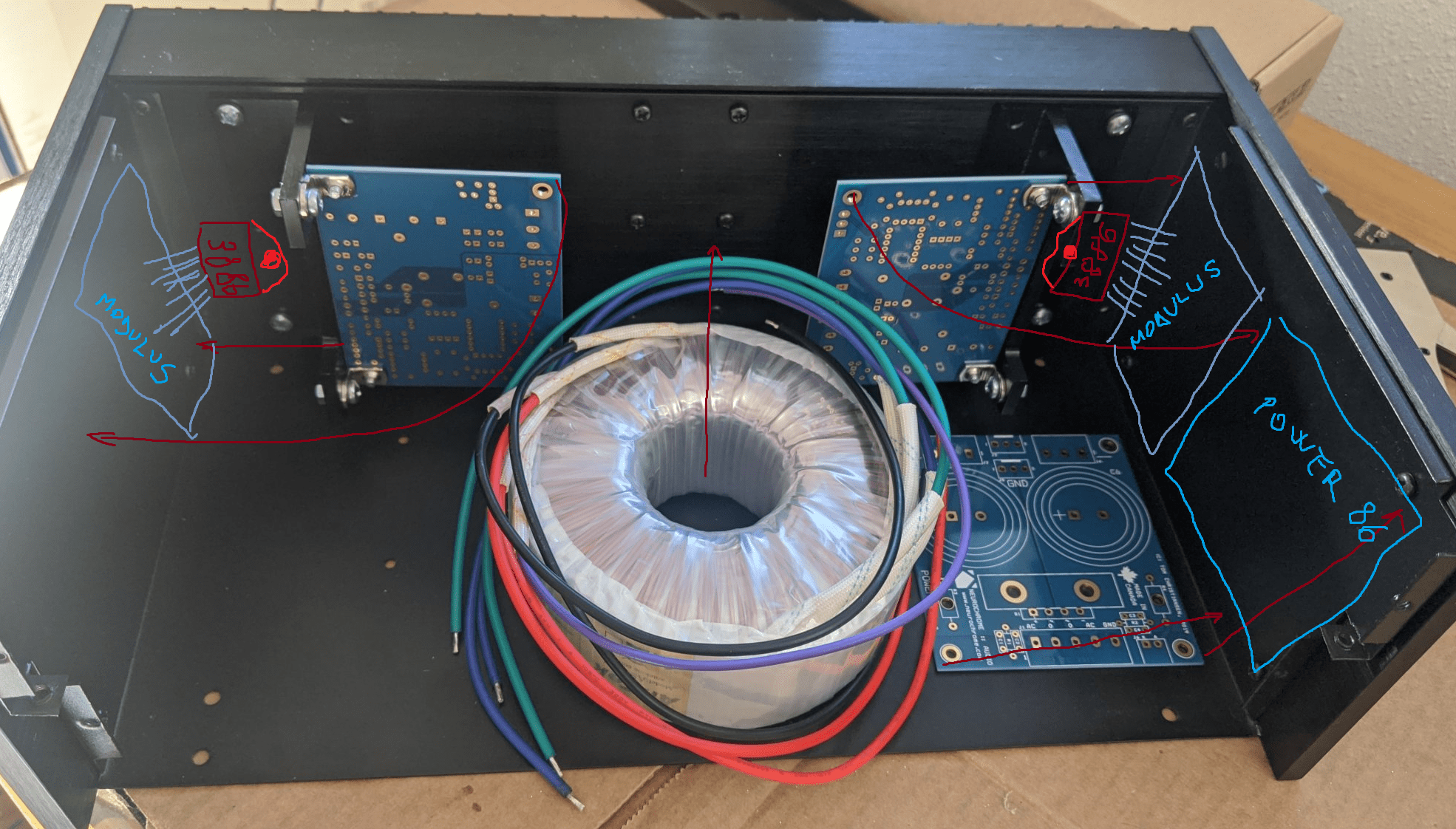

Thanks for the suggestion! i was thinking about mounting the power 86 on the side, but didnt consider the modulus boards there too. ill give it a look to see if i can.I would not use those T shape bars.

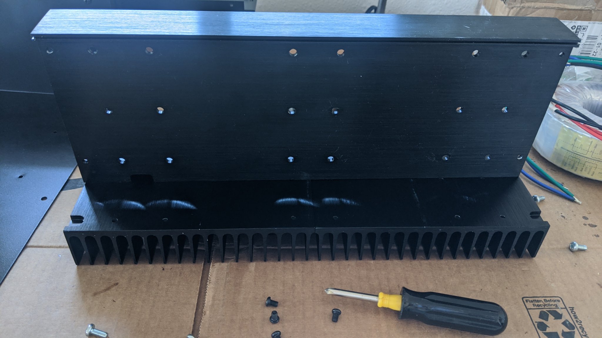

i am prepared to drill into the chassis, but not into the heatsink, so i am not sure how to mount the lm3886s on it
i was looking at how the chassis was designed for the heatsink. Its a heatsink then a back plate. I am going to take off the back plate, curious to see if the whole backplate needs some TIM too. the backplate provides mounting holes for the rest of the chassis to come together. they are not directly mounted to the heatsink if i am right.
Wow. That transformer certainly looks towering in the picture. Oh, well. It's a good transformer.
Tom
Tom
i can flip the T bar around and mount the boards to the other side to give the center area more room. i only oriented the brackets in that direction as theres more material to where the LM3886 mounts to. if you flip it around, the are more holes and less bracket material to touch the lm3886.I would not use those T shape bars.
it would give clearance like this user did : https://www.diyaudio.com/community/threads/modulus-86-build-thread.267802/page-293#post-7059344
i tried to do a mock up to mount the modulus boards on the side, it would require quite a bit of modification to the chassis and drilling into the heatsink and the outer blocks.
is there a signal based issue or something that impacts performance if i put the transformer that close to the mod86 boards?

so if i get a drill bit/tap, i can mount the mod86 boards directly to the heatsink and just drop the brackets. i have an issue finding a cheap metric drill guide vs a drill press. I think i found a M4 one, but didnt find a m3 drill guide yet if i go down this path. I did confirm that the heatsink is 2 peices attached to the plate. so i bet there is thermal conductivity efficiency loss since theres no TIM
i can use an existing m4 hole from the heatsink, drill another M4 into the heatsink, then I need to drill 2 more M3 holes on the side of the case + whatever size the lm3886 hole is
has anyone used these drill/tap in the same bit? i havent seen a video yet if people use these with drills or do everything by hand.
I wouldn't drill and tap with the same bit. Drill bits and taps are pretty affordable, so it shouldn't break the budget to buy a set. You'll need a 2.5 mm drill bit for M3x0.5 and a 3.3 mm bit for M4x0.7.
