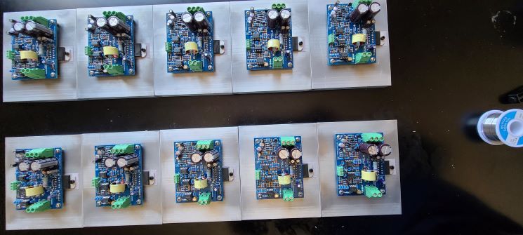

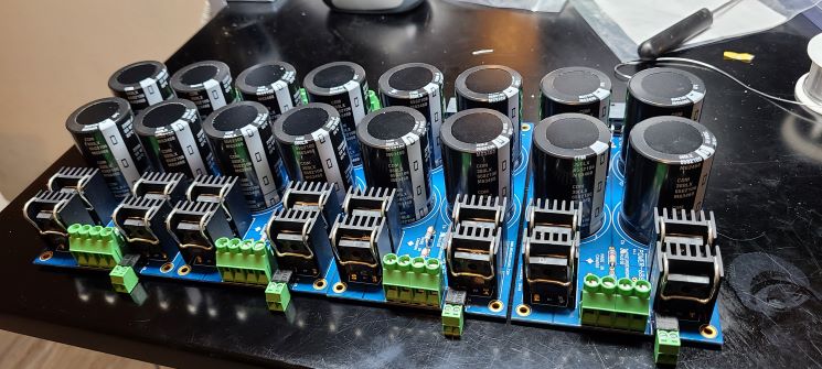

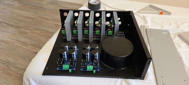

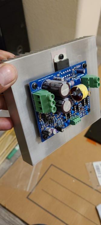

I have been working on 2x 5CH Mod-86 Amps for my LX-521.4 speakers.
Tom helped arrive at a customized design for this speaker. Custom transformers from Toroidy.pl are used.
Heat sinks are from HEATSINKONLINE and chassis is Modushop Pesante.
As others have vouched before, Tom's support and guidance is exemplary.
Prompt responses and detailed guidance and willingness to discuss everything from electronics to suitable parts#, tools and mechanical design make it a pleasure to work with him on this project.
All modules were tested using lab supply and were functional on first power on. This again points to the reliability of the design and detailed instructions made available.
Posting some pictures of work in progress. Cabling and mechanical assembly are the next steps.

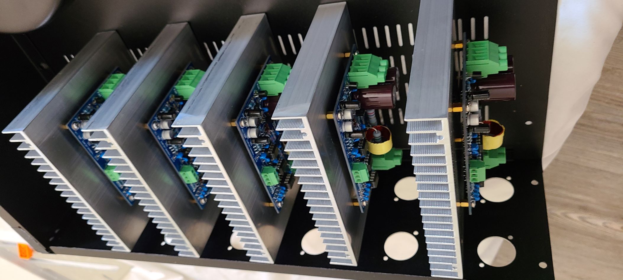

Can you describe how you affix the heat sink assemblies to the chassis? I see from one of the photos that the top edge of the HS have a area which can be threaded for a screw; I assume that is also on the bottom edge and that you have attached the HS to the baseplate using screws placed in appropriate holes drilled to the baseplate. Did you also drill and thread holes on the edge of the HS up against the back panel, so that the HS is also affixed to the back panel?
This structural aspect is of high interest to me.
Yeah the heat sinks have 3mm channels for screws. I use 3.5 mm thread forming screws to attach the heatsink bottom edge through the base plate. They are not attached to the back panel.
I had also planned to use a copper L-bar to connect the heatsinks to each other along the edge facing the power supplies and screw the L-bar to the base plate.
But not doing this at this point. I don't quite enjoy drilling holes in metal 🙂
Thank you for the information! Your base plate must be pretty thick to be able to take that much amount of stress. I completely understand the issue of aligning and drilling additional holes in the back panel; I'm also metal-working challenged!
Tom; would that be Moduli?😱
Possibly. Would more than one Toyota Prius be Priii? 🙂
The ModuShop chassis come in two options: 1 mm steel covers (which is hard on your tools, by the way) and 3 mm aluminum covers. I'm guessing this build is with the 3 mm aluminum covers. That's pretty stout stuff. Also, one can drill and tap holes into the bottom of the heat sinks so they can be attached to the chassis bottom for even greater rigidity.
I'm puzzled why many are so afraid of metalworking. I love working in metal. I can make cuts with great precision and cut threads. Even thin material is quite strong and it remains stable even with changes in humidity. Wood on the other hand is damn near impossible to machine with any degree of precision. It splits and splinters if you look at it funny and it bows and binds at any change in humidity. I have a solid wood standing desk where one drawer only opens during the winter. Apparently the 40% RH during the summer is just too much.
I taught myself metalworking when I was in my teens and haven't looked back.
