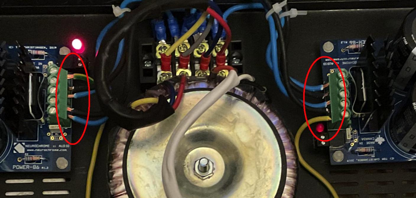

I wouldn't worry too much about wire colours in a DIY project, but if someone is to service the amp at a later date, the yellow-green could throw them off. Then again, it's pretty obvious that it's not a safety ground.
More importantly, I suggest that you trim the wires going to the power supplies a bit. There's a lot of exposed copper sticking out, begging to be shorted together. Be careful when you trim those, though. The little wire strands tend to go into places where you really don't want a wire strand to go.
You could also drape them in a little heat shrink. That might be easier.
I'm glad you got the amp working though. Enjoy!

Thanks Tom, yes I uninsulated a little too much, these are stiff wires and I wanted to be sure the connector got a good mechanical purchase on the wires. Heatshrink it is.

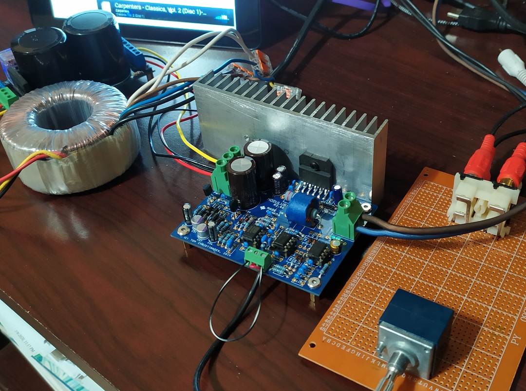

Using separate 42v CT transformers for each channel. Just finished one channel. Right off the bat I had some hum issues because of my bad wiring of RCA into the balanced input. So far I spent a total of about 4 hours, and I still need to start working on the second channel. (this heat sink is a temporary arrangement.)

Looks like a pretty beefy transformer and a nice and clean build overall. Excellent.
Did you get the hum issue figured out or would you still like some help with it?
Tom
Hum issue was because of wrong RCA to balanced wiring. After figuring that out I listened to a couple of albums last night and Modulus-86 makes very beautiful sound!

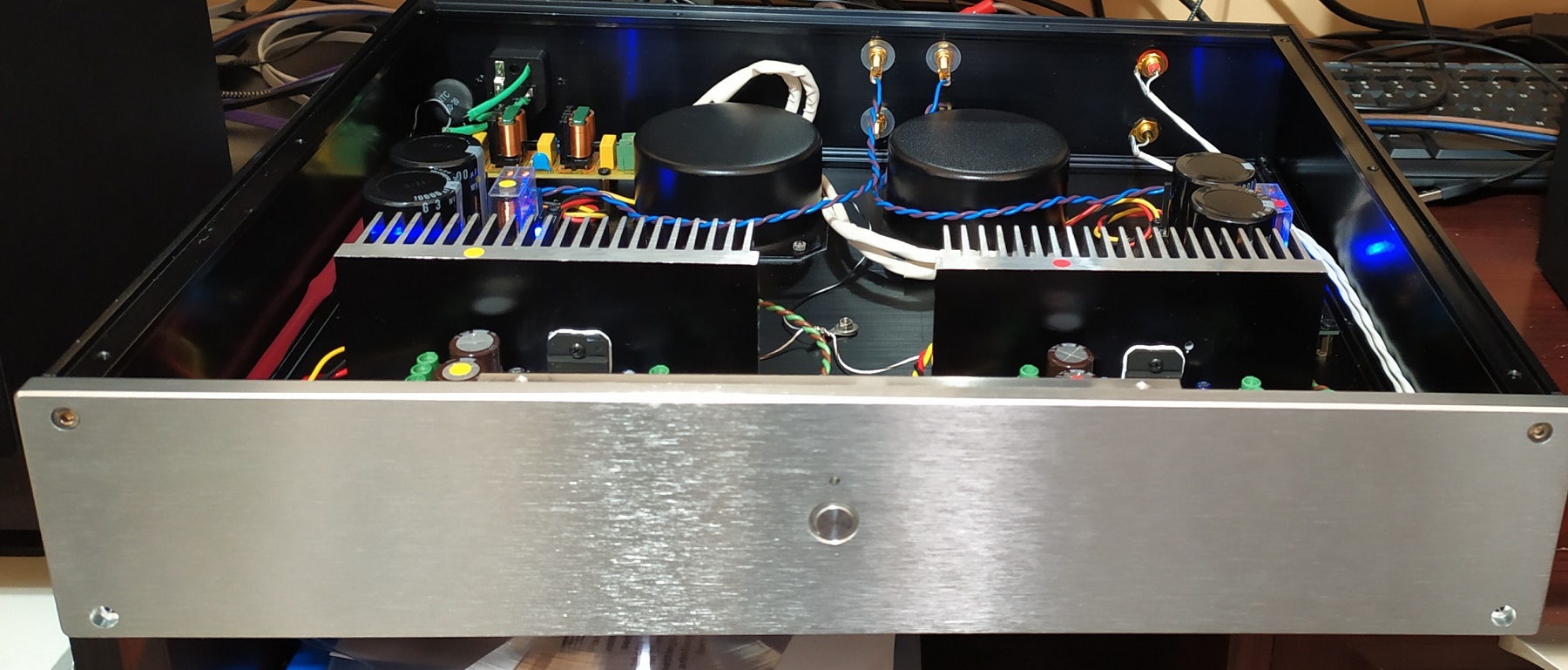

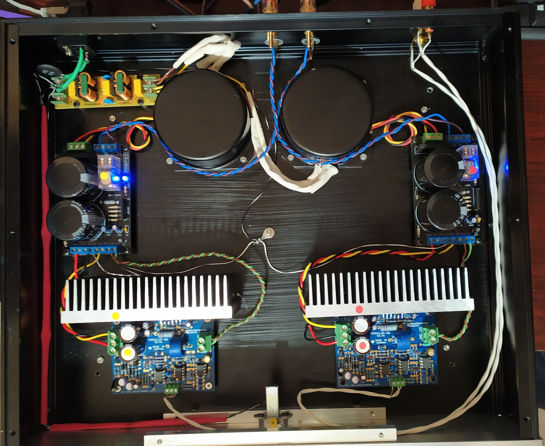

I was able to get the speaker return back to the board itself. Here is the first release of Modulus-86. I ran out of wires and ended up using whatever was available on hand. I might re-wire this after a couple of weeks or even change layout a little. But for now this is how it looks! Chassis turned out to be a little too big.
Transformers are 22-0-22V providing approx +/-30V rectified. Power drawn from the wall is just below 12W idle (both channels combined) and peaked at about 21W in my office room's loudest listening level. This could have been a weekend project if I had all components, chassis, heat sink etc readily available. Final layout design and wiring took a lot more time than just finishing the board and its individual testing.

Tom, I don’t see any vent holes in the bottom, so even with a ventilated top panel, I’d imagine convection would be inefficient at best; doesn’t a chimney need to draw in as much air as it exhausts? That’ll be harder to achieve if the chassis is essentially sealed on 5 sides.
As many operators of Intel based MacBooks or iMacs can probably attest, insufficient attention to thermal dissipation of total system operating at sustained high demand levels can be “problematic” at the least.
Nicely done! How do you ensure airflow across the heat sink fins? Do you have vent holes in the top and bottom panels?
A chassis that's a little bigger than needed is much preferred to one that's too small. 🙂
Tom
The top panel has vent holes but not the bottom one! So essentially there cannot be much air circulation. I am considering a different chassis with heat sink on the sides and holes on top and bottom like I did with my MyRef-C.
Ideally, yes. If you can make the air escape above the heat sink, it'll work better than no vent holes at all. But the best is to have unrestricted airflow parallel with the heat sink fins.
That said, the saving grace here is the rather large heat sinks. That allows much of the heat to conduct to the bottom panel wherefrom it can be conducted or radiate away.
I prefer those chassis. The one you have would make an excellent home for a preamp or headphone amp, though.
Tom
